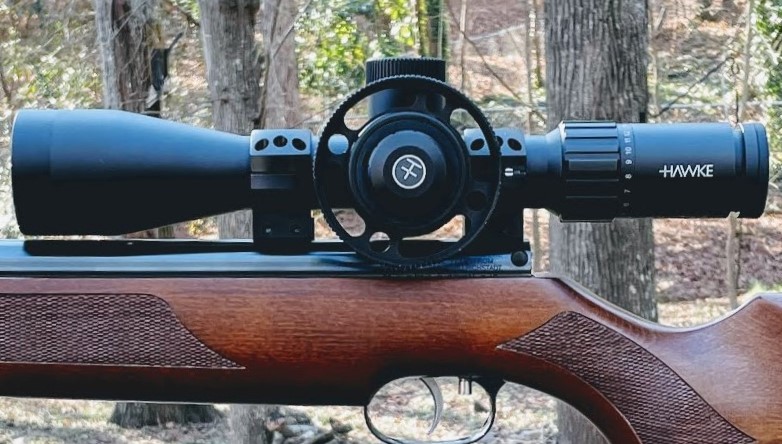

I am a little confused as the high rings should have left about 1/8" clearance for the 50 mm objective. What high rings were you using? Thanks
HW95L with medium rings & 44 mm objective leaves about 1/8" clearance.
They were Burris rings:
https://www.amazon.com/gp/product/B000JWO7JY/ref=ppx_yo_dt_b_asin_title_o06_s00?ie=UTF8&psc=1
Problem is, the rifle was shooting about 8" low at 25 meters, so I needed an elevation compensating ramp that put the scope up high.
I bought another set of high rings to put on the ramp. What I need to do is replace the high rings with low or medium rings to get the scope down.
Scot
