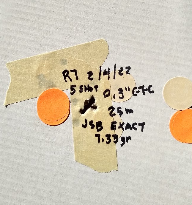

I have a 20+ year old R7/HW30 S that consistently shoots under 0.5" and occasionally 0.25". Here is a photo of a 5 shot group at 25 meters:

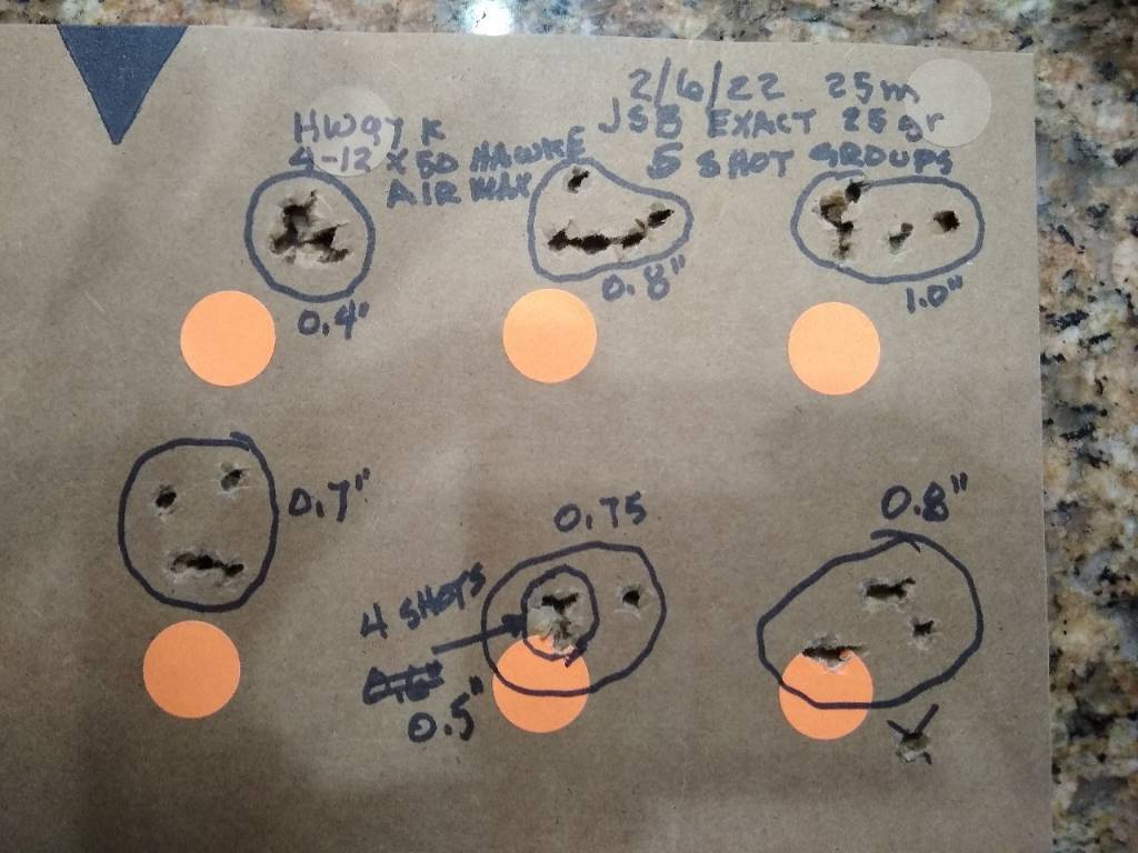

The problem is that the HW 97 is consistently about 0.8" to 1.0" with an occasional group 0.5" and under. I expected to get 0.5" consistently based on the HW97 reputation for accuracy. Here is any image of some groups I shot today:
The groups are in order, left to right. In case it's hard to read, all are 5 shot groups at 25m with JSB Exact Diabolo 25 grain. I'm shooting off the same rest (Caldwell sand bag) as the R7. I've tried the following things:
Vary the rest: on the bag, on my hand and on a piece of foam rubber. The softer rests, my hand and the foam, work better. These groups were shot using the foam.
Vary my hold. I've used the same hold as the R7, a firmer hold and a looser hold. The R7 hold, a fairly loose artillery hold, was what I used to shoot the top left 0.4" group. It's also the hold I used with the next group, 0.8". The rest of the groups were shot with a variety of holds from very loose to fairly firm. One had 4 shots in 0.5" with a flyer. The rife seems to sometimes be putting 3 or 4 shots touching, then one or two flyers. Other times they're just scattered around. The orange dots are 0.75" in diameter.
Vary the receiver/front trigger guard screw tightness. One session I started with the screw tight (not as tight as I could get it but very firm), then loosened it 1/4 turn at time, fired 5 rounds to let the rifle settle in, then fired for group. The groups stayed about the same, 0.8" to 1.0" until I finally loosened it the the point that they got worse. Today I tightened it firmly and shot the 0.4" group.
I'm not the greatest shot in the world but my crosshairs were on the orange dot every time I fired. I couldn't tell anything different when I got the flyers with an otherwise good group.
Tried a variety of pellets. Air Arms 25 grain occasionally shot well, but the JSB 25 grain and 34 gr Exact Heavy Diabolo have been the most constant and produced the few good groups.
Adjusted the trigger so that it doesn't affect my shot, i.e. lightened it.
Made sure the stock screws are tight.
The scope is a Hawke Airmax 4-12 50mm and was on the R7 before this. I have no reason to believe that there's anything wrong with the scope. I've made sure that the mount and rings are tight.
I'm at my wits end. I've done everything I know of to improve a springer so I'm hoping someone will have some ideas based on the target and what I've described.

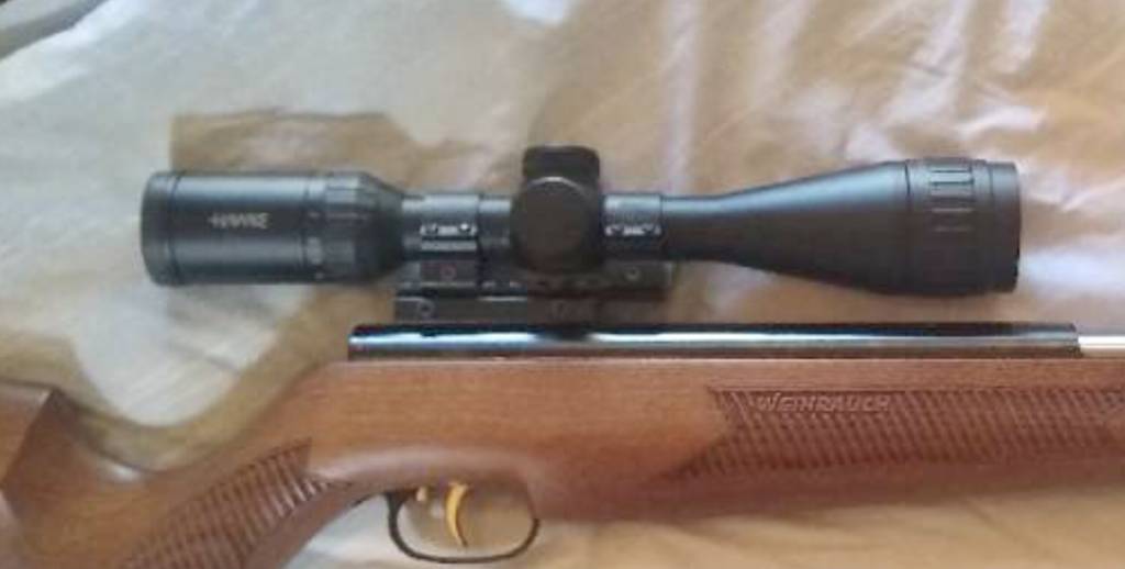

By the looks of your scope in your other post, you have a lot of hardware all bolted up together. This 97 is no R7. I would recommend getting a good 1 pc mount. Make sure the scope stop pin is fully inserted. Degrease all screws and use blue Loctite. Also try to get the scope closer to the receiver. ( more consistent head/eye placement)
I run a UTG dovetail to picatinny adapter and picatinny rings on my 97s as well with no issues. Just keep shooting it and it will settle in. 500 shots may not be enough yet. I've had a few come from the factory over lubed and didn't settle down until after 1k shots. I don't play that game any more. New guns get torn down, cleaned and lubed, straight from the box.
Honestly your best bet at this point would be to install a Vortek HO kit. Thats typically always my first step. 25 cal is on odd caliber to have a 97K in (which I'm assuming yours is). You may need the extra juice that the HO kits put out. I know my 22 did.
Bear-of-Grayling
When I received the rifle I put Vortek extra high rings on it. They weren't high enough to clear the 50mm objective lens; it bore on the top of the receiver, i.e. put pressure on the end of the scope. Plus the rifle shot way low, 8"-10". I replaced the 50mm objective scope with a 40mm and it cleared the receiver. I made sure the scope was optically centered (it was brand new but I checked it) and the rifle still shot low.
That surprised me. I had no idea an underlever rifle would shoot low like a drooping break barrel. So I bought a UTG 10" at 25 yd. (about 40 moa) droop compensating ramp (11mm to Picatinny) and put Weaver Picatinny rings on it. The UTG mount has 4 screws holding it to the receiver and I double and triple checked that the ramp sat in the receiver grooves, then tightened it. It's remained as tight as I can get it with a hex wrench. It came with a hex screw that fits into one of the receiver stop pin holes and I tightened it also. The weaver rings are as tight as I can get them without stripping the screws.
The 50mm objective lens requires a high mount. I haven't found rings that mount on the receiver and are high enough for the scope to clear the receiver.
So that's why there is so much metal. The rifle shoots about 35-40 moa low at 25 meters and I don't want to put that much correction on the scope. With the ramp in place it was about 1-1/2" to 2" high at 25 m so I brought it down with adjustments.
So now I'm worried about the barrel and receiver being out of alignment. Is that much barrel droop normal/acceptable?
I'm pretty certain the scope mount is secure. I've checked the tightness of all the screws several times. I'd get rid of the ramp if there is another way to put in the 30+ moa low POI at 25 m.
