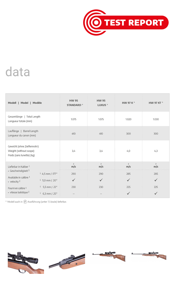

I think you have that backwards, the k is 5 meters per second SLOWER, that is,if you’re comparing to the Luxus. I’m basing that on the 95L is the Luxus model. I might be misinterpreting that though.
Lol. Reread it. i joking put that as " - " 5 (minus 5). Got ya...lol😁
I try to be funny but it never works out 😭

These are the two trigger colors.
