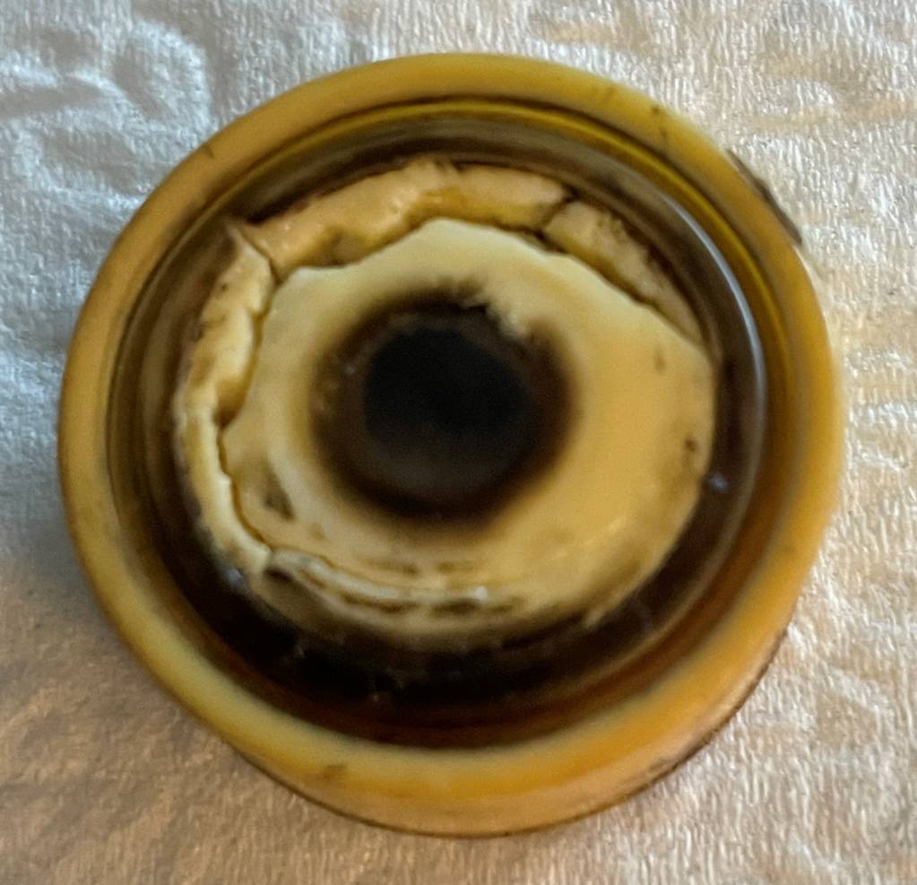

I received my new,(2018 HW95L), rifle.
Rifle was received on 8/11/2020 from AoA.
Installed a ARH kit, (piston seal, top hat, spring & guide), in early 5/2021.
Installed a Vortek piston seal, cleaned, re-lubed with GPL-205 in 5/21/2021 due to POI changing & lower chrono numbers.
The kit was installed after accuracy fell off.
AoA replaced the Weihrauch seal but I used the Vortek. The rifle is absolutely soundless cocking now until the piston latches into the trigger. After 8 months and about 3K to 4K shots the rifle is very accurate. The shot sound is a sharp dull thunk.
Factory seal damaged by dieseling caused Weihrauch over oiling/greasing.
