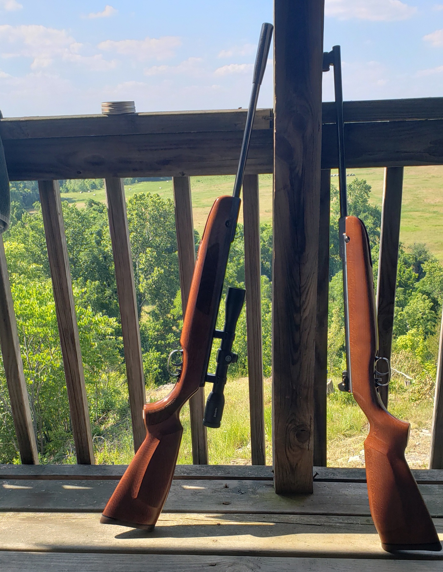

I have a Hw95 a Hw50 and three Hw30s. All of them in 177. One of Hw30s is the wife's and she much prefers it to my Hw50. Regardless of the specifications the 50 is about as hard to cock as the 95.
We've shot all three types out to hundred yard's at empty beer cans and plates when the wind is down.
The Hw95 was my first real air rifle and is a great gun. It's a Lazer beam. I use my Hw50 for carrying around the woods. It has adequate power for squirrels within 40 yards and is lighter and easier to shoot offhand than the Hw95.
My first Hw30 was my second real air gun. I enjoyed shooting it so much both with peeps and scoped I bought a second because I got tired of flip flopping between the two sighting systems. The wife and I used to shoot powder guns a lot and I got her a Hw30 when cartridge ammo prices got ridiculous. She's very happy with it.
Out of the three types the only gun I'll use for 50 yard groups is my Hw95. That said I giggle like crazy using the Hw30 on plates and beer cans out to a hundred. It's by far my favorite rifle. Including powder burners.
Hw 50 on the left, 30 on the right.
Reactions: Bolillo and Frogy
