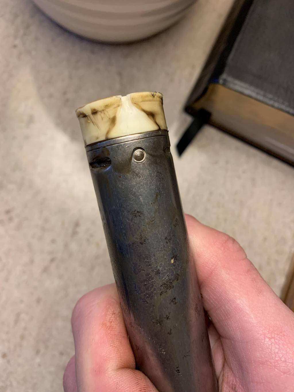

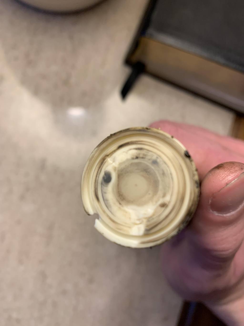

Well i think I may have found the problem. Does this seal look bad to you all? I'm a beginner, but i'm guessing there shouldn't be that hole in the rim of the seal? It looks like there was a failure and a blast backwards behind the seal. What would cause that to such a new gun? Should I just order a new seal? Also the seal face looks really dirty. Should I clean out all of the excess lube in the chamber?
That seal is "shot" so to speak. Now that you have the gun apart, make a sleeve to go over the spring. It will ease any vibration and make the gun even more accurate. Remove all the factory grease and either use a little molly or buy Krytox (it ain't cheap, but it is the best) and apply sparingly.

Yessir. That was extreme dieseling/combustion. You will absolutely need a new seal. Vortek will have it in stock. A good clean and proper lube job is in order.

First off, please send a picture of that seal and describe your experience to Weihrauch directly. Yours unfortunately isn't a rare occurrence, and personally I think they should see it.
You'll need a new seal. That's a given. When properly lubed, a factory seal will last a long time. The aftermarkets are also good options, but may require a little sizing to be at their optimum. That goes for Vortek too.
