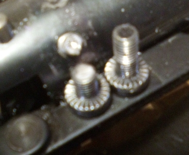

One day i figure ill get nice cap washers for the forend screws to help fill that gap between the woods hole and sctew head better ..lol.
But heck I've even had to glue in washers for synthetic stocks .
Even had one snap the forend screw
