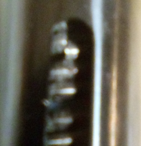

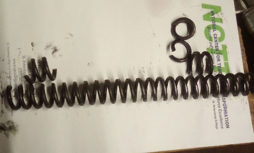

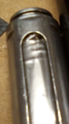

maybe a mistake but I'm going to open her up next week when the ARH kit shows up it is so noisy when being cocked . don't sound like a spring noise !! kind of nerves any warranty is void once I do that. oh well no guts no glory. the noise is like the cocking shoe is binding. I have had the stock off a couple times even cocked it slow with stock off don't see anything . my first HW disassemble kind of looking forward to it

Broken spring
That high quality german steel.😉

update . Installed the ARH spring kit notice no difference in cocking effect . But no more spring noise when being fired., an slight push no spring torque . An no noise whe cocking What did i find when opened up? Spring was dry dry . A cocking shoe had a slice dur I heck on from the sliver of wood back in the begaining. Ok about 40 pellets in will update

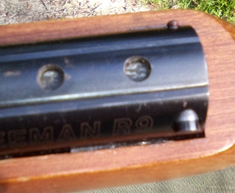

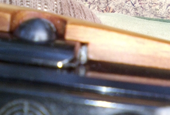

I got shims in my r9 stock. I noticed after time or high lotsa shooting the receiver fit loose in the stock . Kinda got like you discribe somewhat.
This (on each side) hard plastic stops the forward thrusting.
This (2 thin rubber innertube rectangles) keeps the receiver centered
now behind the receiver tube there's still that air gap between it and the stock wood ( forgot to take picture).
anyway with them the receiver dont move /thrust forward like it wanted and the tube is centered in the stock instead of off to one side. All screw holes line up and so far it all stays put nice and firm.
