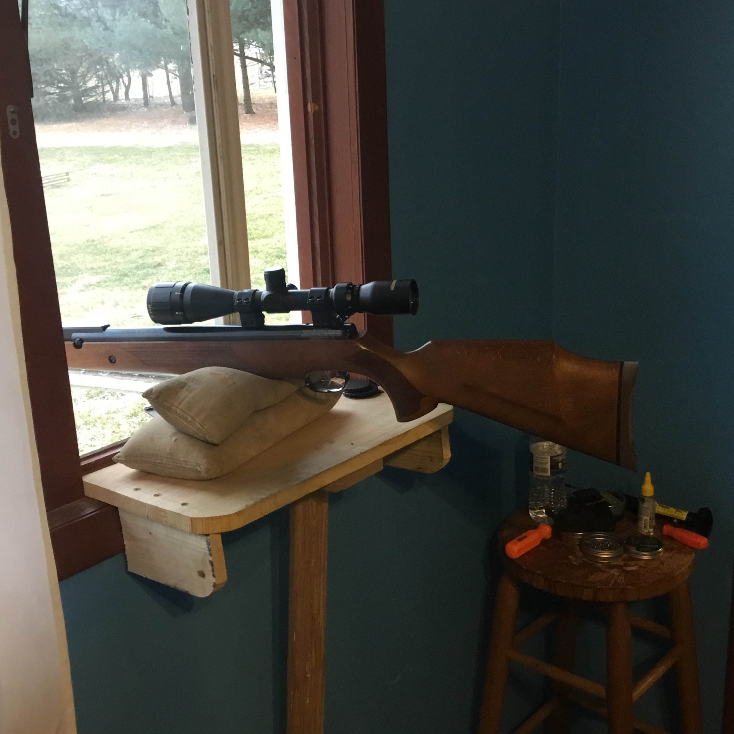

Ok check no wiggle but after some flash light work a some grease. Found a tight spot on cocking arm with a polishing stone and a little elbow grease was able to get that off now have the slights wiggle also found what looked to be wood pulp at reciev were barrel meets I think may have barrel droop about fixed going to mount hawk scope without droop mount an see were I’m at. I think I should just take this unit allllllll apart. Clean an Reassemble I keep finding little things that shouldn’t be You know in Europe they can have a pint with lunch I’m wonduring if my was a 2 pint Friday 🤣

Yes is now shooting higher. At 20 yards about 4 inches with a range of pellets. with the utg a droop mount. Installed hawk With sport match mount. ( scope) being centered Still shoot a little low but within the range of adjustments of scope even at further distance. This is my project gun I have decided 😁 I tamed a Diana 48 .177 I feel I can conquer this one 🙏. Thanks to everyone that commented I
