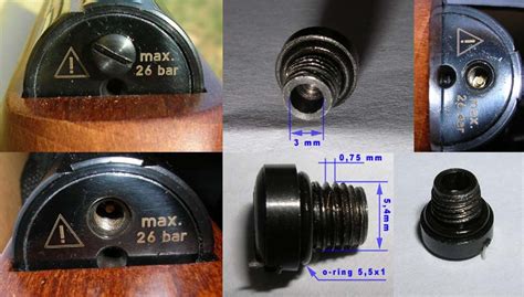

Tuning Hw90 pressure accessories
Maybe tells max stamped on it?
Fitting threads bonus
The one thing nice about the Weihrauch gage is that it allows you to progressively reduce the pressure. Each time you press it inward against the schrader the pressure drops about 0.2b. I only have two HW90, the first came in at 26b as received. The second rifle came at a lower pressure, about 22b, if I recall.

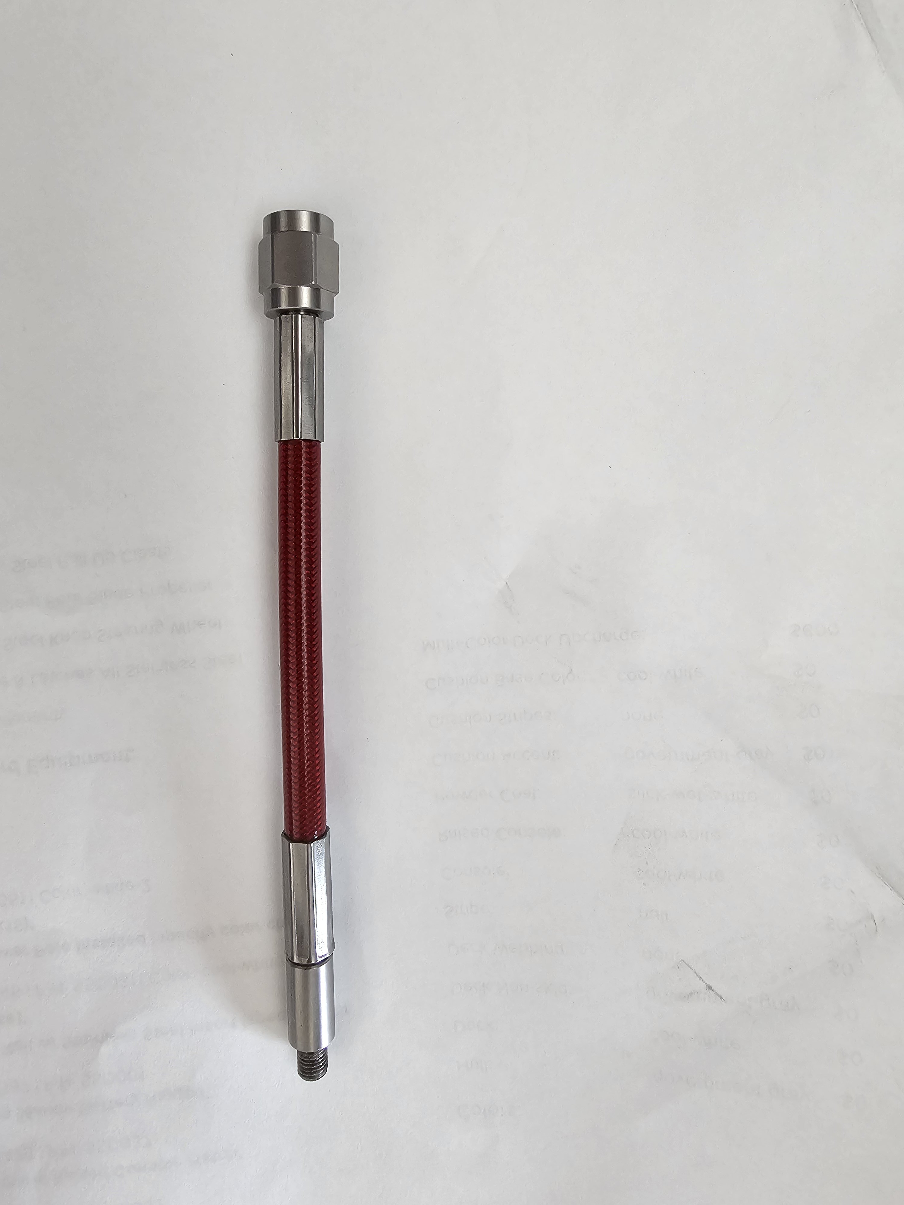

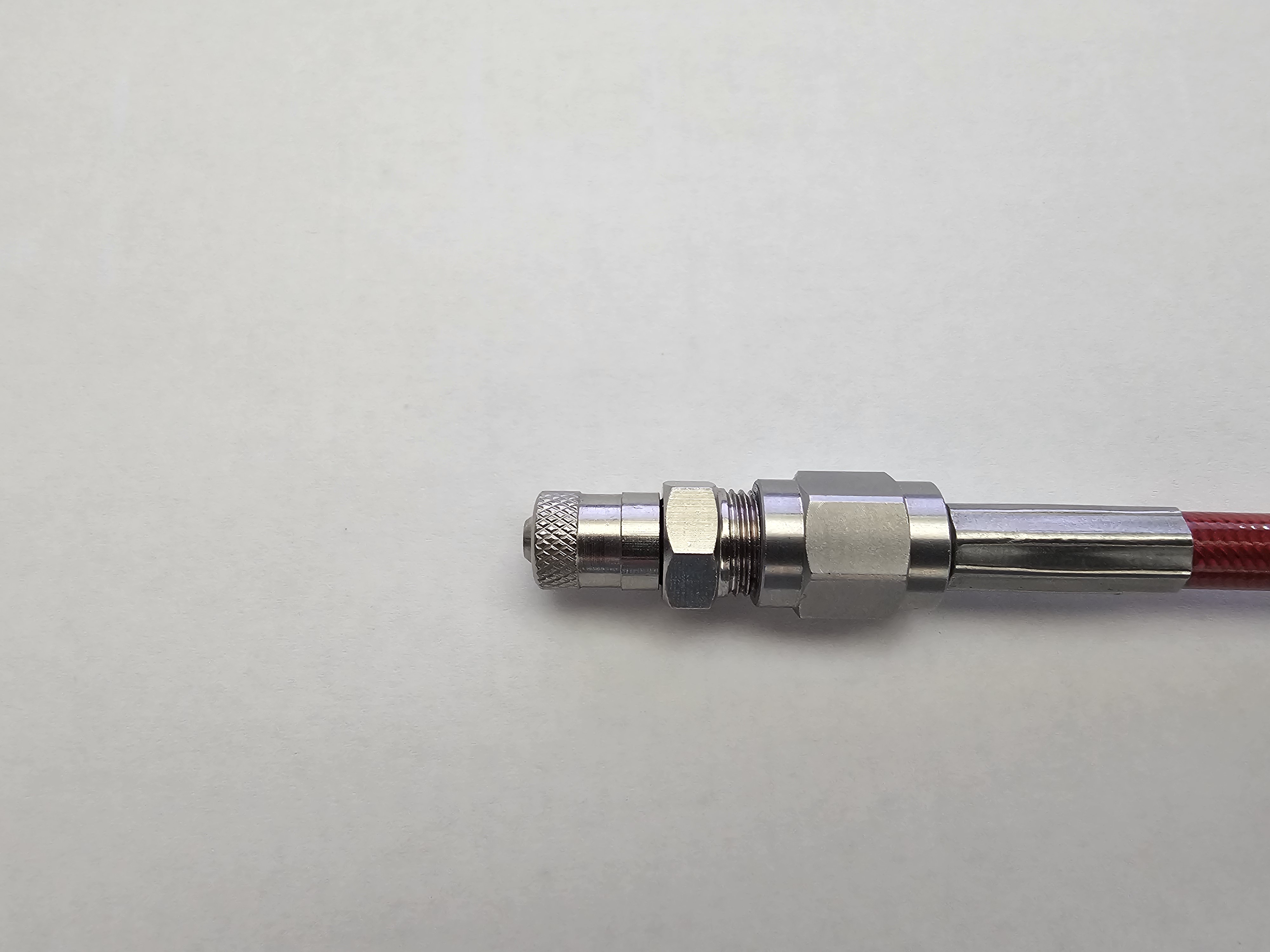

I was not able to get the shock adapter to work for my HW90. My HW90 is a newer one, received it from AOA about a month ago. The threads on the adapter were correct pitch and would thread in ok, but it would not seal. I tried a few different o-rings to try to get it to seal off but it just would not work. I found this:
They do not show a picture of it on the website but this is what you get:
It has the theoben shrader on one side and an 1/8" BSPP on the other end. I got these:
shrader valves on Amazon so that I could use the rock shock shock pump. Also I did not previously see this, so I think it is new to AOA, but they have an adapter now to:
But it has a QD on the end which would have required more adapters to get me to a standard shrader valve to use with the shock pump. I wish the shock adapter would have worked for me but I was not so lucky. Just adding my experiences to the thread in case anyone else has the same issue with the shock adapter.

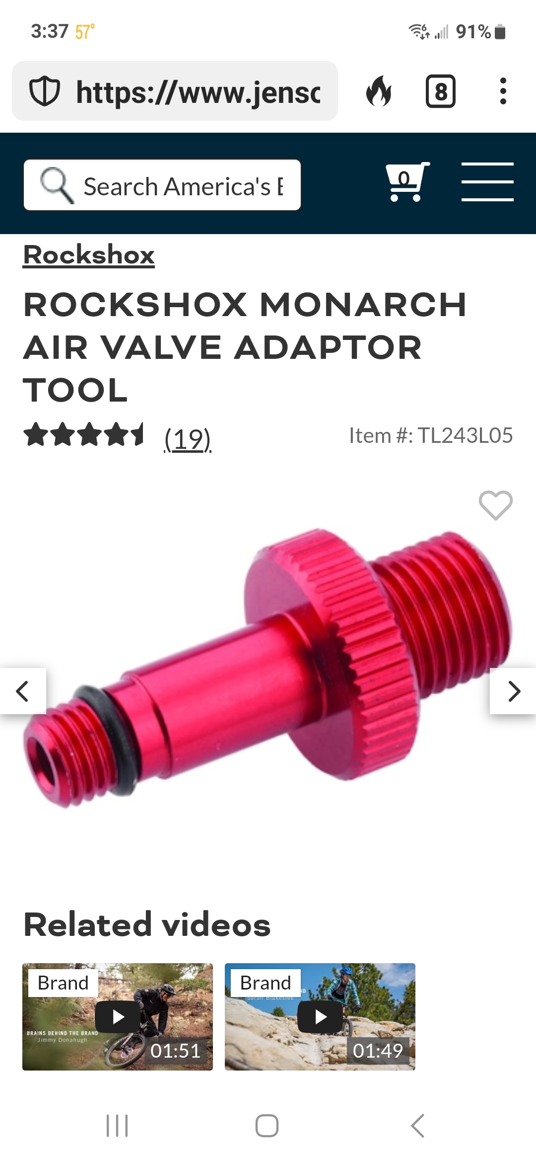

This is the Rock Shox adapter I used and it worked perfectly. Is this the one you used?

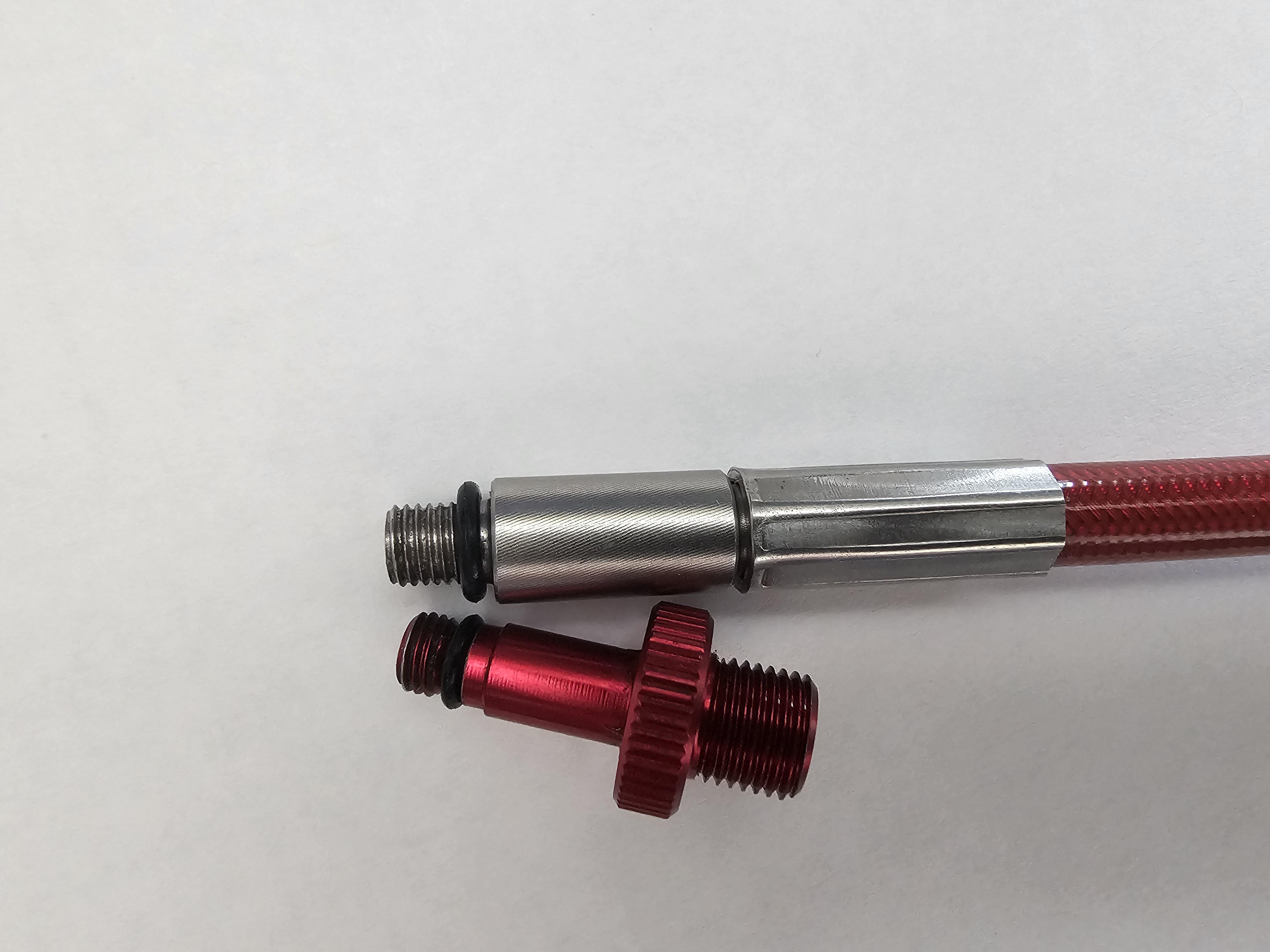

Yes that is the adapter I used. Here is a pic of the adapter next to fitting on the hose.
The hose fitting is a little longer and has a more pronounced shoulder. With the shock adapter I tried the o-ring that it came with it, a larger o-ring, and an o-ring that fit up on the step of that adapter as well trying to find the combination that would work. No combination would seal. It would almost seal. Pumping the pump, it would temporarily get up to 5 or 6 bar by the end of the stroke, but would leak off by the time you started the next stroke.
Yes that is the adapter I used. Here is a pic of the adapter next to fitting on the hose. View attachment 430490
OK sorry that happened. Mine was a 2000 RX1. I remembering lubing the oring so it didn't get cut. I think it may have have been an odd metric size or something. My bet is the gun is the same but RS changed orings. Weihrauch almost never changes anything. I'm trying to remember more.
