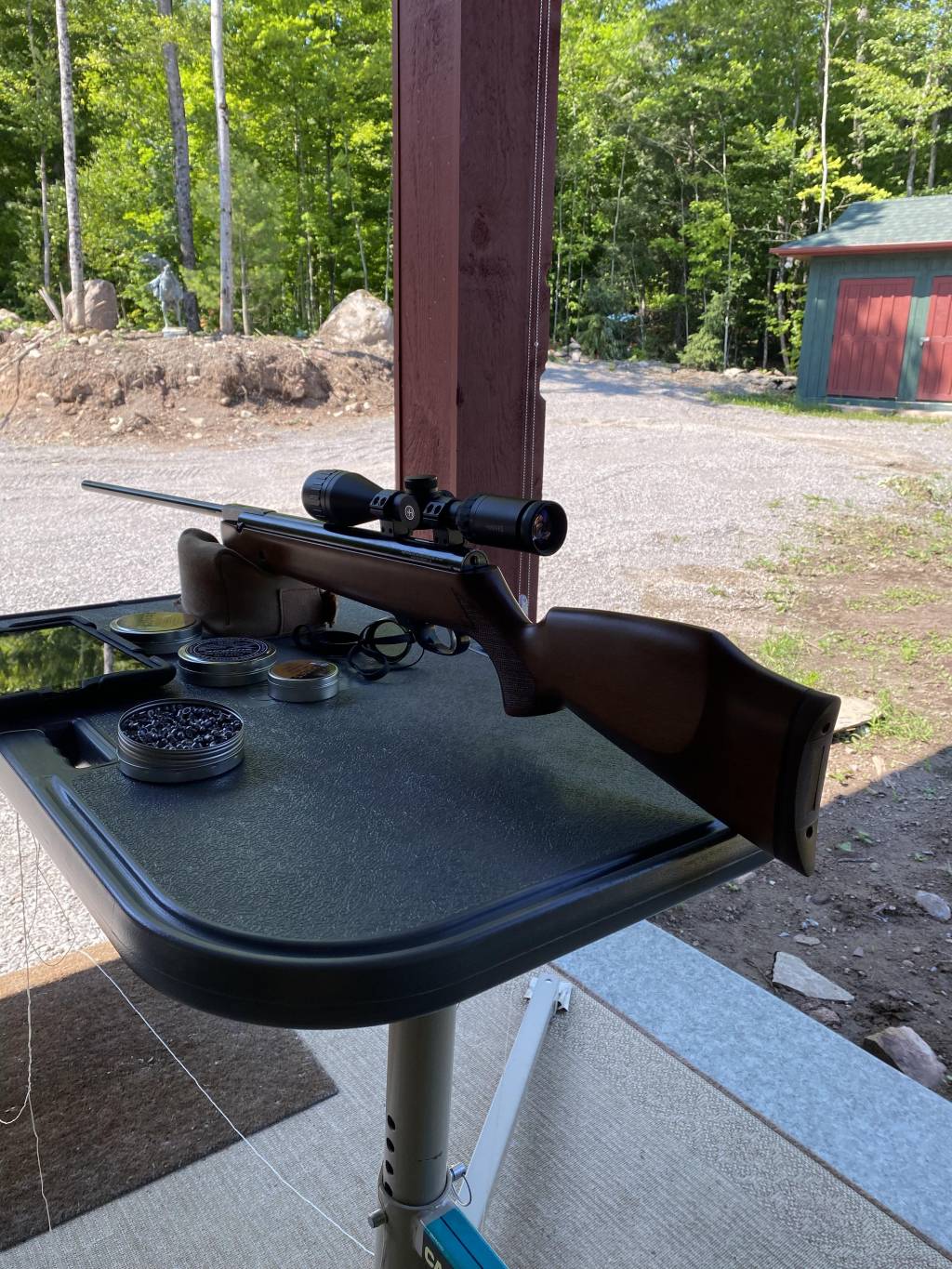

This HW90 .25 was my first Weihrauch I bought 3 yrs. ago.
 I have 6 other HW’s, their nothing like the 90. Put a new Air.Max 3x9x40 on it. Have changed dozens of scopes with no problem. This has to be the most stubborn rifle I have. I think an
 Uzi at at 100 yds would be more accurate. Was aiming where dime is. Took off scope, remounted, tightened all screws.Try again.
