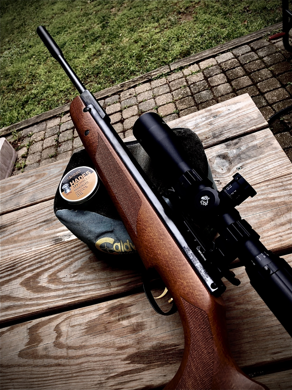

I don’t have any experience with the 80, but I just got a .177 Field Pro model 95 with a Vortek Sub 12fpe spring in it & I like it a lot. Very smooth shot cycle & very accurate. I don’t think it’s available in .20 though.
I have an HW95 Field Pro in 22. I've had it for about 3 years and couldn't be happier. No problems with the barrel. Accuracy has been outstanding. I've shot mostly JSB 15.89gr and Crosman Premier 14.3gr. At 25 yrds I get nice little clusters. I would vouch for the HW 95. Sorry to hear some of you have had bad luck with the 22s. Maybe I just got lucky.
