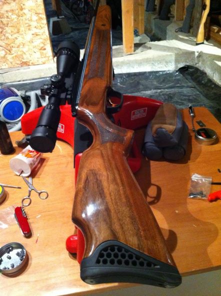

just to throw something else in @ 4 inch longer barrel
