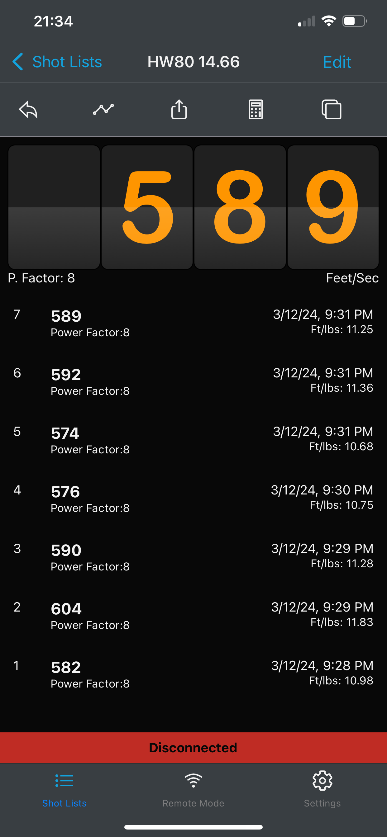

Hey so it’s new gun day for me, HW80 “long rang hunter “ .22 beautiful gun. Fit and finish is outstanding.
The problem I’m having is why does it make 13.5 ftlbs. The factory tag says so and so does the chronograph.
It’s not exactly the OG Magnum as described, so my question is what kinda power is everyone else getting? Also my HW77 only 6 months old is making 14 ftlbs so I’m guessing I must not be the only person wondering?

Those pellets should be fine from an energy standpoint. Sometimes oddball and heavy pellets will lose you a couple FPE but not those. I'd think 17fpe would be about right from the factory with either. Mine (tuned .177) is pushing 19fpe so yours can absolutely make more power if needed

My HW80S in .20 caliber shoots at roughly 18/19 FPE - shooting 13.73 JSB's at 780/795 FPS.
My gun came originally as a .22 caliber and shot at 19/20 FPE out of the box. I would expect the gun to shoot at least 16/18 FPE out of the box.
Guaranteed, the HW80 platform should be able to reach 19/20 FPE in .22 caliber. At 19/20 FPE it has a pretty harsh shot cycle and hence I wouldn't recommend maxing it out to this level. However, I've kept mine at 18/19 FPE because it's my most accurate gun and I don't want to change anything.
So the answer is Yes, something is wrong with the spring, piston seal or compression tube of the gun.
I think it will make you feel better - to send it back at their cost and either have them fix it, give you another HW80 tested to be more powerful or a different gun altogether.
IMO, they should've known better than to ship this gun with their (own) measured deficiencies. Unfortunately, sometimes vendors get busy and this is missed.

Nothing is being lost on me. I'm trying to help you. I'm telling you something isn't right. I was trying to collect information to see if it was terminal or worth addressing privately. If returning the rifle is possible I'd recommend that. Typically many people have Weihrauchs gutted and tuned because the unfortunate truth is they're buzzy and unpleasant to shoot as delivered. In most cases a tuner will be able to get advertised power while making the gun far more pleasant to shoot. And occasionally more accurately.
Since you're understandably unhappy I'd recommend you seek a replacement or a refund before being angry at people trying to help you.

So, I'll just share what is common with SOME of the new-ish hw50's which is what I have. Apprently a number came over-lubed, and were dieseling and burning up the piston seals. Mine was tuned I think almost when new. VERY few shots thru it, and the seal was burned up. This was of course replaced by the tuner (motorhead). And it does about 16fpe (.22). I think slightly above factory rating. I think generally, the guns are slightly over-sprung possibly with spring fatigue in mind? So, removing this little bit of over-sprung nature tends to increase power a little bit.
So, personally, me being me, if the spring feels like it is doing it's job, I would look into what is needed for disassembly and proper piston/spring lube. Tear it down, replace the seal which I'm sure doesn't cost much, and lube it properly. Should this have to be done to fix a relatively new gun? Of course not. But what is the likelihood the same thing will happen again. What is the liklihood your gun will get lost/damaged/or stolen when shipped? I'm good on all that. I'd sooner fix it myself.
