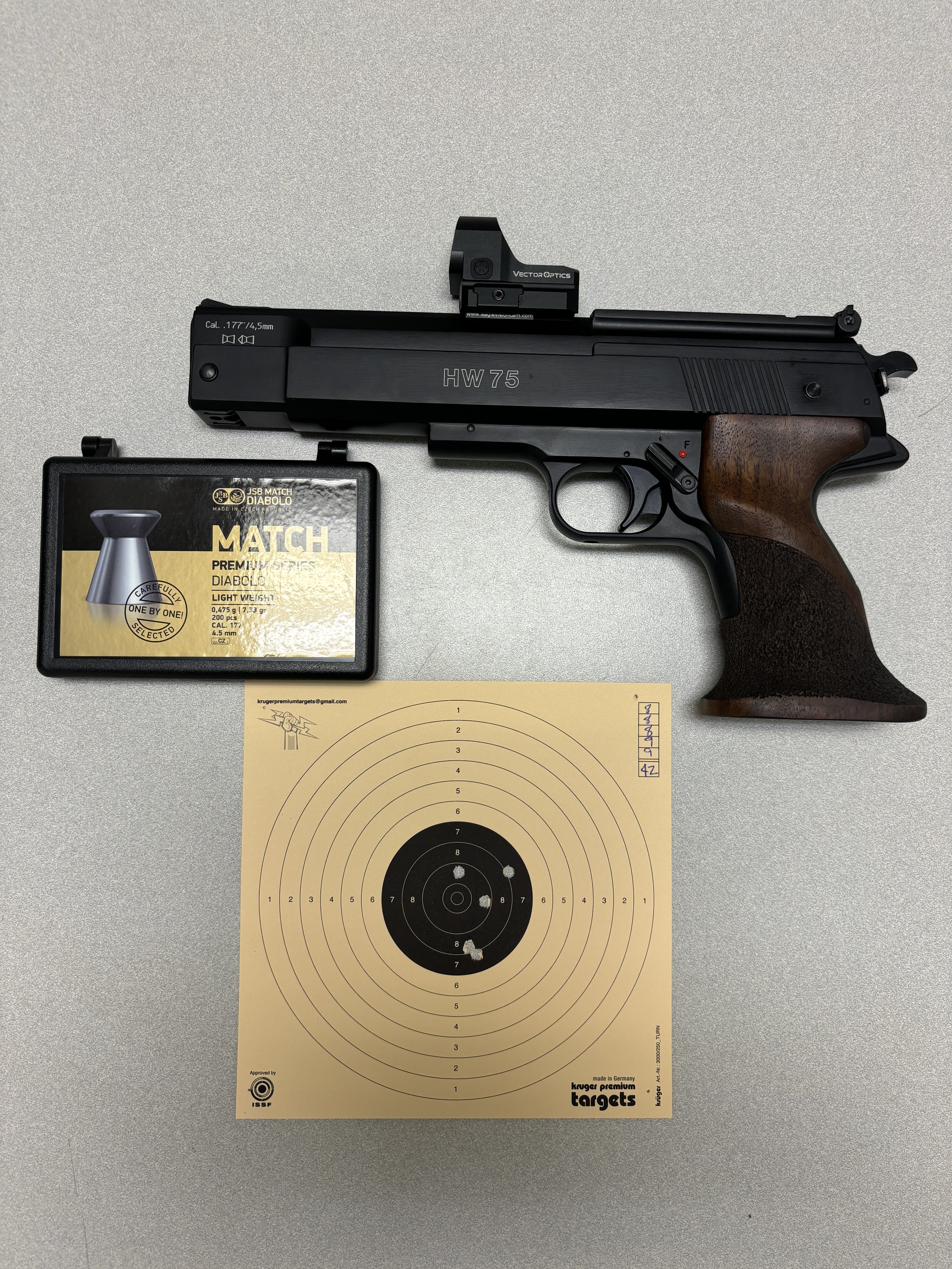

Just purchased an HW75 - my first air pistol.
I could not find a thread which listed favorite pellets. My goal is not competition at this point, but rather skill building.
Rather than buying a range of pellets, I hope to start with those that most have had success with. I have worked through finding best performing pellets for my .25 PCP and .177 springer (which likes 4.52 head size H&N 8.64 FTT's), but hope experienced HW75 users will share their go to pellets.
I assume that wadcutters on the lighter weight side might be a good place to start.
Many Thanks in Advance!

I use RWS R-10 Match 8.2 they do the best most accurate in my HW75 or any of my .177 's
I shoot 7 gr RS10's, 7 gr JSB's or 7 gr Meisterklugen's in mine. Great paper punchers and easy to cock.
even though Beerthief is using the R-10's in 8.2 which i would be using in my Diana model 75 i would thing the R-10's in 7.0gr would be better or the 7.0 Meisterkugeln or any 7.0gr i like RWS pellets but as with everything they have gotten expensive
I have tried these others and R-10 won every time , If the Meisterkugeln had won then i would be buying and using those . This is just ME . when i score a target the pellet hole has to be inside the ring to count .
