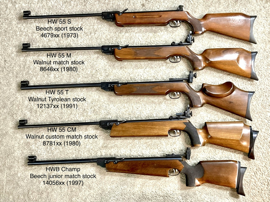

  2. Heavier stock made in five different styles over the years (per pic below)

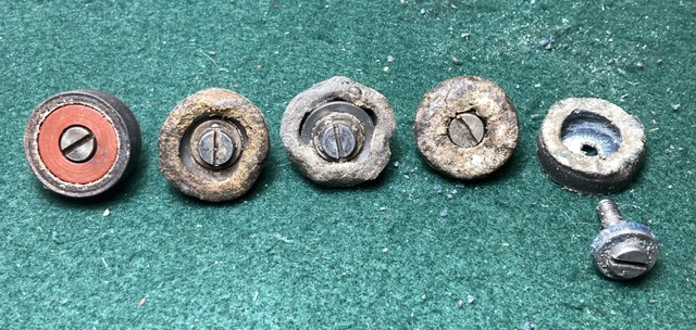

Here is the unique piston seal detail noted above. A similarly sized Diana seal is on the left, the other four are from HW 55's. Instead of the solid center piece typically used in leather cup seals, there's just a flat washer (three are metal, but on the right is a plastic one which disintegrated). If the chamber is kept well-oiled, the leather eventually wraps around the front of the washer to form a thick pad.
I assumed the first one I saw was a bad amateur re-seal, but after finding half a dozen it's obviously part of the OEM design to soften the firing cycle! Later 55's went to a more normal seal...as do I when I find the older ones.

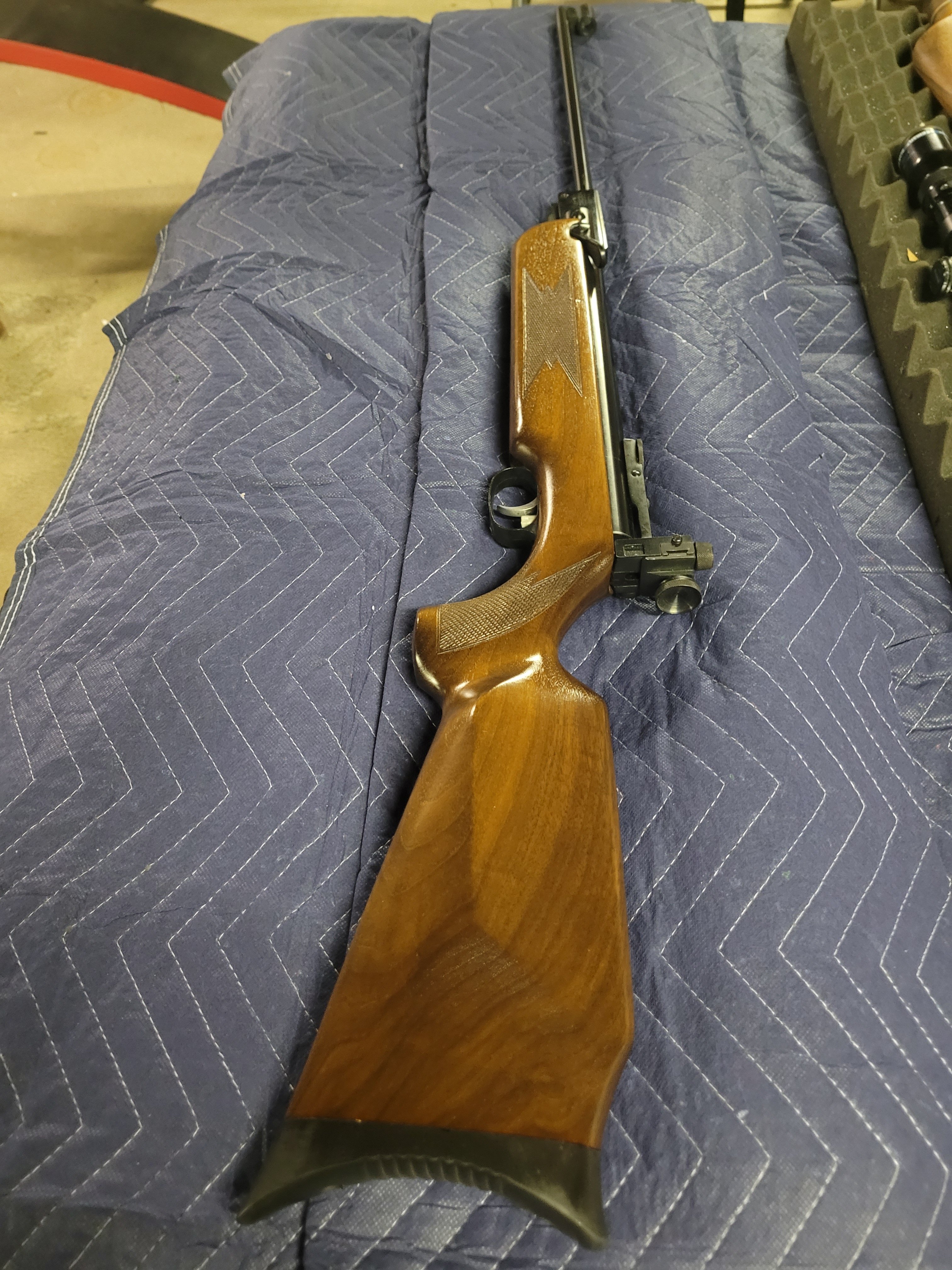

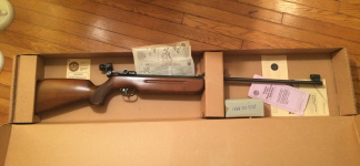

LNIB
My sweet gal bought it for me for Christmas even before we were married. In our 20's. She went to the local Beeman dealer and bought it. I have a few others and can't bring myself to shoot or heaven forbid part with this one. I picked up a nice used 55 M afterwords. So sentimental about it but she's really an incredible wife and mother. Amazing person. LOL she told me she doesn't like guns when we met. Susie spend many days outdoors shooting her R7 smashing cans with me. And she still says it's very relaxing for her to hear that pellet smack the can.

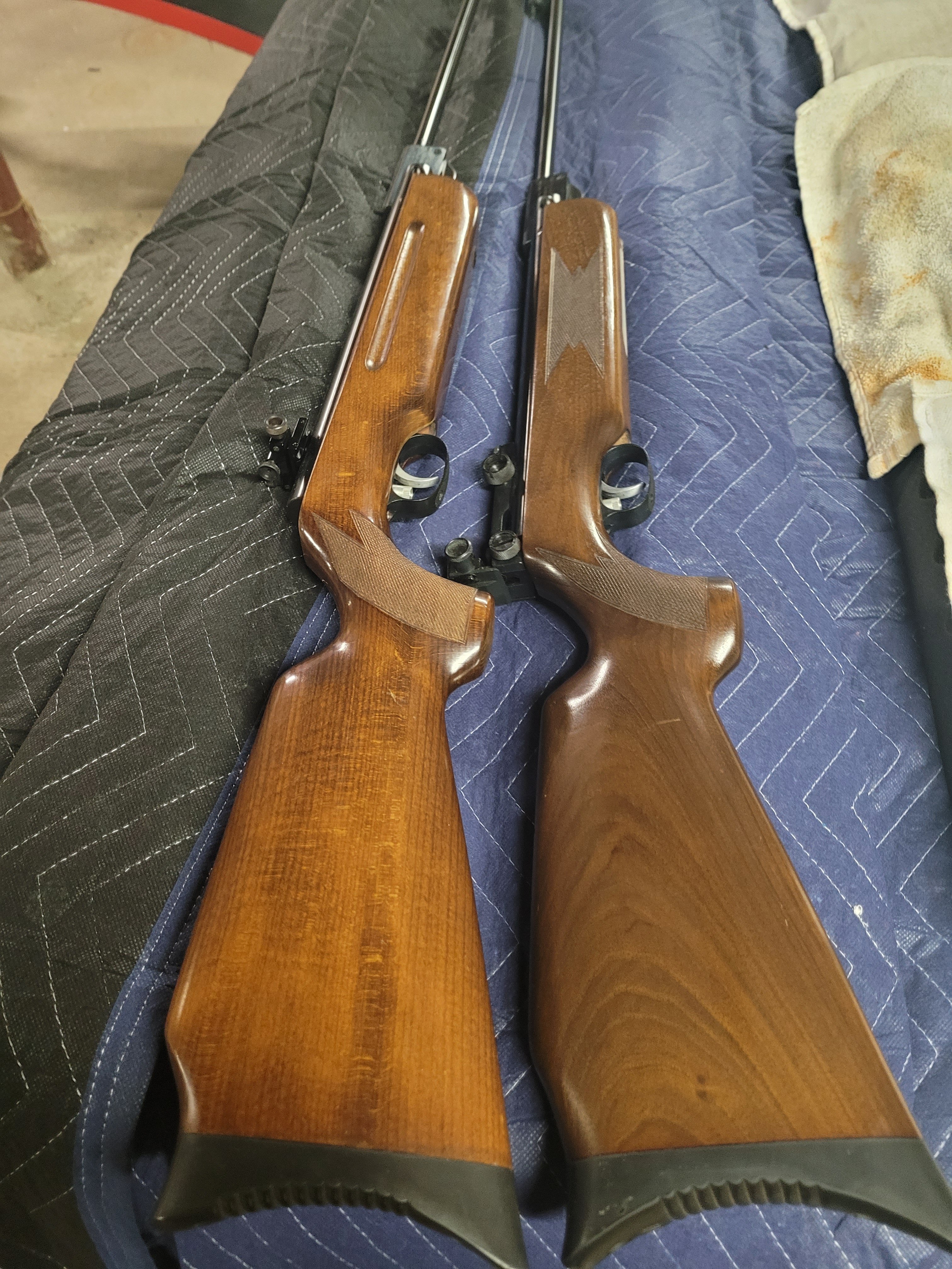

Had these 55s out on the range last night. My friend Mike came by and got to try them out.
The Sport is set up as such with a Beeman peep and a slightly stronger spring. Compared to the 55M, it's day and night.
The 55M is so silky smooth and has such a tame cycle that the 55S is harsh in comparison. The 55M produced one hole consistently. The 55S all within .5 inch. Such lovely old girls!!
