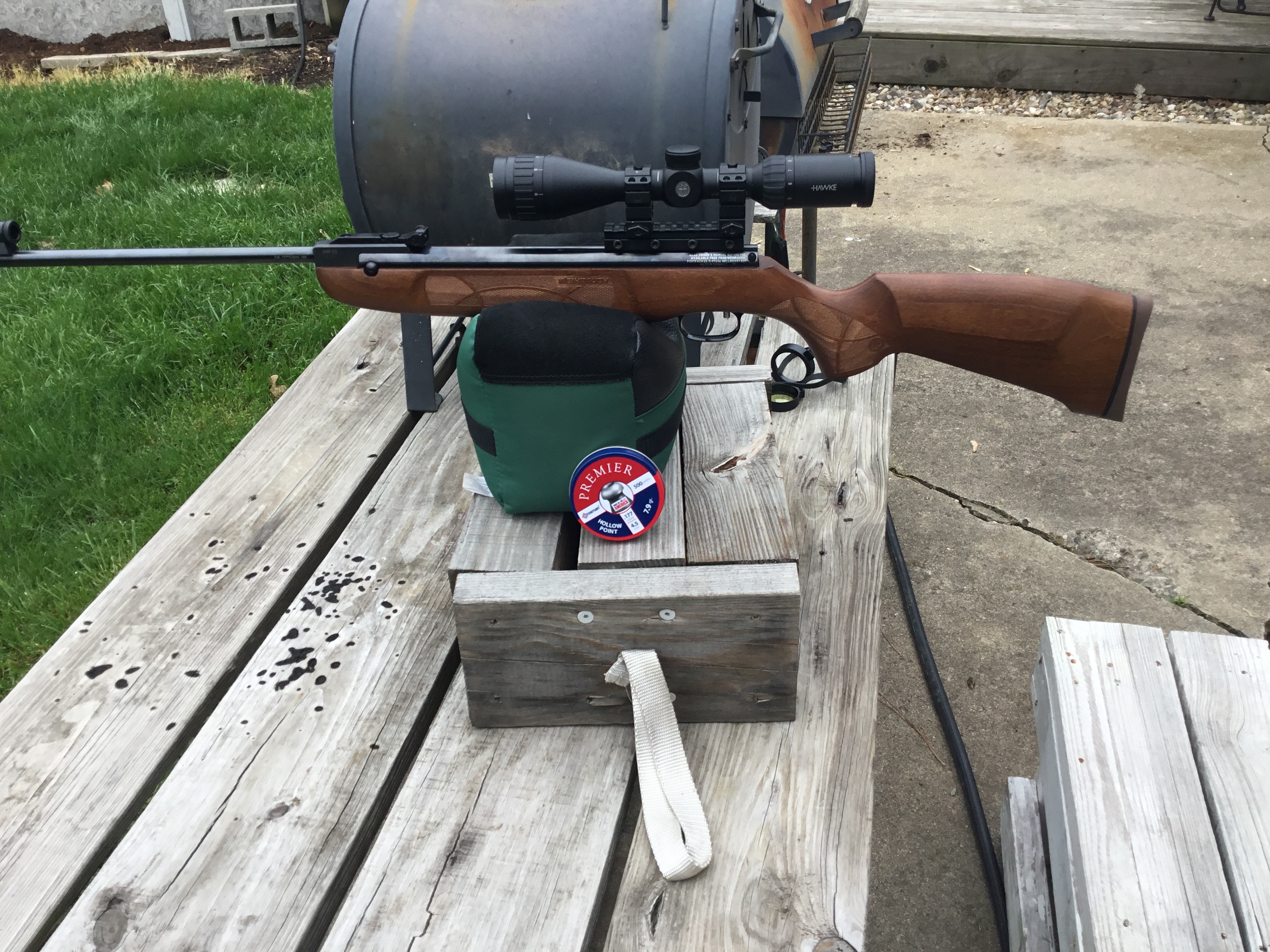

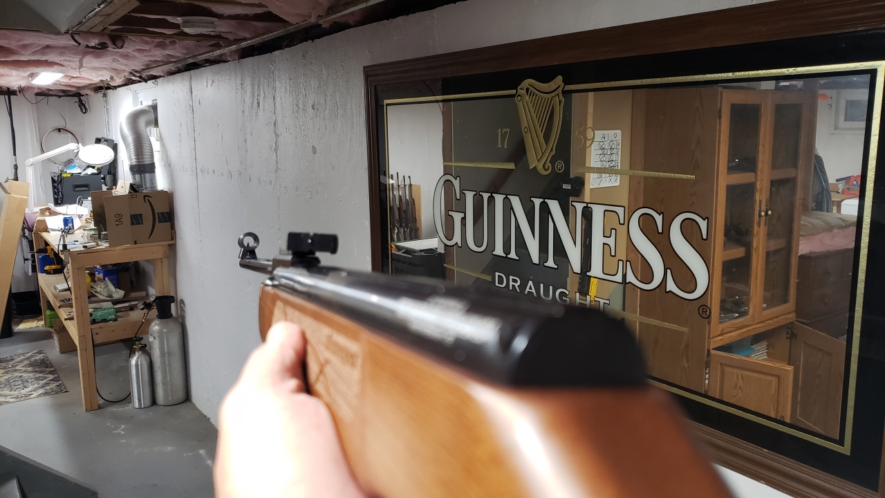

New HW50s 177 cal. My thoughts. After receiving it, I cleaned it, checked screws. ok. Mount scope. Using standard 2 piece mounts . Start shooting. , at 20 yards shot 18 inches low🤨. Shim scope several time quit at 25 Thousandths . So back to the basement. Install a droop compensator mount. It has 29 thousandths built in. Ended up adding. 10 thousandth to that . Now scope isn’t being over adjusted . Now the gun looks great. Wood perfect ,blueing is nice. Fit is good. The trigger perfect. , how does it shoot. It will stack 7.9 crosman at 20 yards. Can hit spinners at 50 yards . Heck my Diana 34 doesn’t have that much droop. My WH95. Has some droop still after fixing the cocking arm issue , My Hatsan doesn’t have that much. I’m not sure where I’m going with is thread other than to vent . And if someone new to springers would think they were doing right buy get this . guns like this give spring guns a black eye. Thanks for letting me vent . This will be my last HW. picture has the 2 piece mount not the droop mount . Calling AOA on Monday !!
Same thing happened with a new HW50 I ordered and set up for an elderly friend of mine. Subtracting distance from line of sight to line of bore, the gun had 60 MOA of droop! The bell of his new scope was already nearly touching the compression tube in medium Sportsmatch rings so there was no room to shim in the rear and he didn't want high rings. We bent the barrel using my version of barrel bending jigs others have shown here and elsewhere and now it shoots where it should.
In the days of the original ARH and Beeman's you could check a box on order forms for "select barrel angle" which got you a gun with as little droop as possible for scope use. Today you get what you get and if you don't like it and don't have the means to correct it yourself you pay to send it back and hope for better next time.

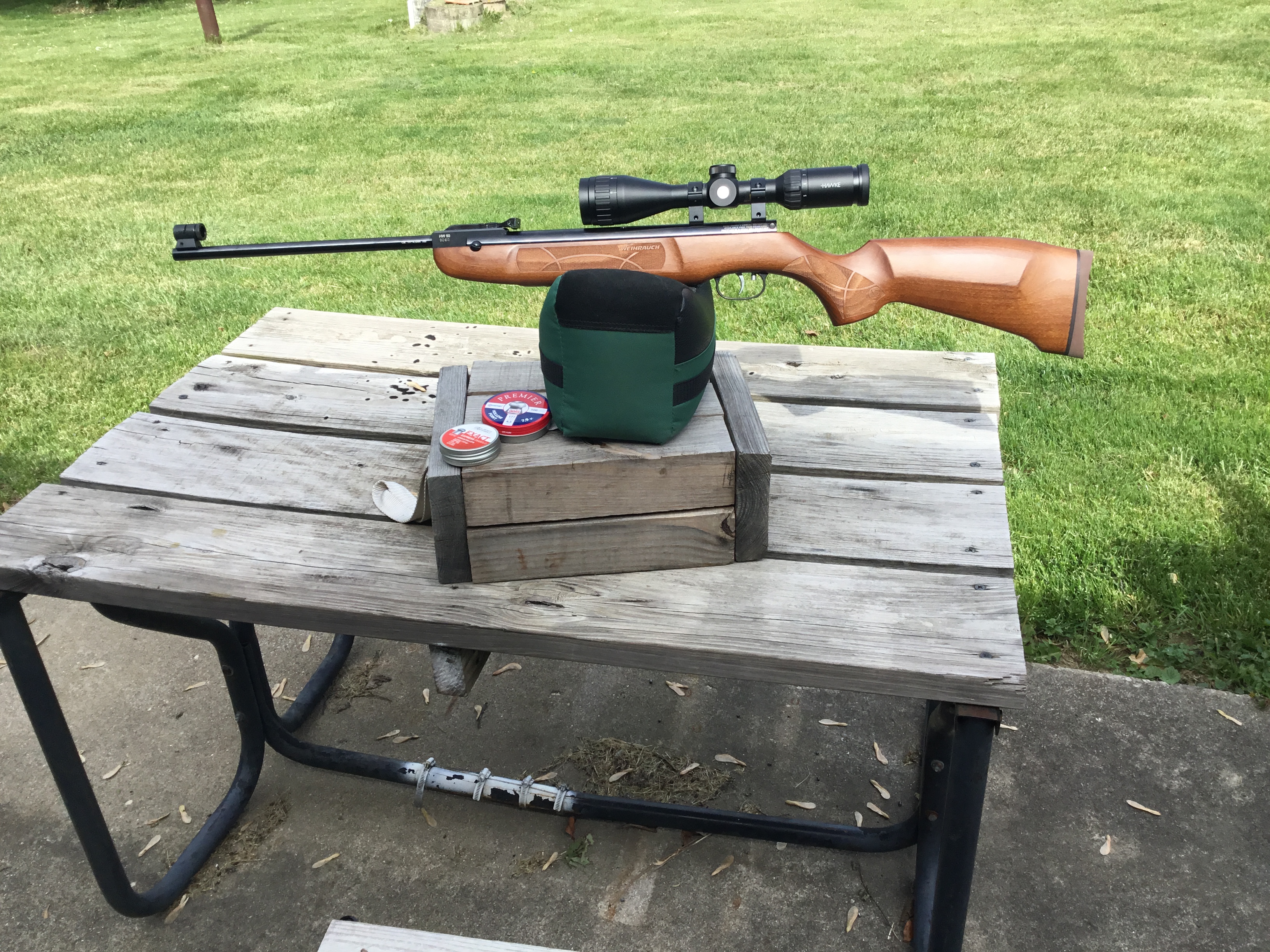

It’s a hawk 3x9x40 AO. The mounts in the picture are sports match medium No didn’t try the sights lol maybe in a year I’ll be able to use sights 😀 the sad thing the little guns shoots good even with that much barrel droop . its almost as easy to shoot as my HW97.

I have had many hw50(99). In the UK certainly with my Gun shop droop in the 50 is a very well known issue. The last time I bought one he kindly went in the store room and came back with four guns and I picked the one with the LEAST droop. Normally it is not a problem.

The droop would not affect opens the droop occurs where the barrel hinges. Both open sights are on the barrel.
New HW50s 177 cal. My thoughts. After receiving it, I cleaned it, checked screws. ok. Mount scope. Using standard 2 piece mounts . Start shooting. , at 20 yards shot 18 inches low🤨. Shim scope several time quit at 25 Thousandths . So back to the basement. Install a droop compensator mount. It has 29 thousandths built in. Ended up adding. 10 thousandth to that . Now scope isn’t being over adjusted . Now the gun looks great. Wood perfect ,blueing is nice. Fit is good. The trigger perfect. , how does it shoot. It will stack 7.9 crosman at 20 yards. Can hit spinners at 50 yards . Heck my Diana 34 doesn’t have that much droop. My WH95. Has some droop still after fixing the cocking arm issue , My Hatsan doesn’t have that much. I’m not sure where I’m going with is thread other than to vent . And if someone new to springers would think they were doing right buy get this . guns like this give spring guns a black eye. Thanks for letting me vent . This will be my last HW. picture has the 2 piece mount not the droop mount . Calling AOA on Monday !! View attachment 356388

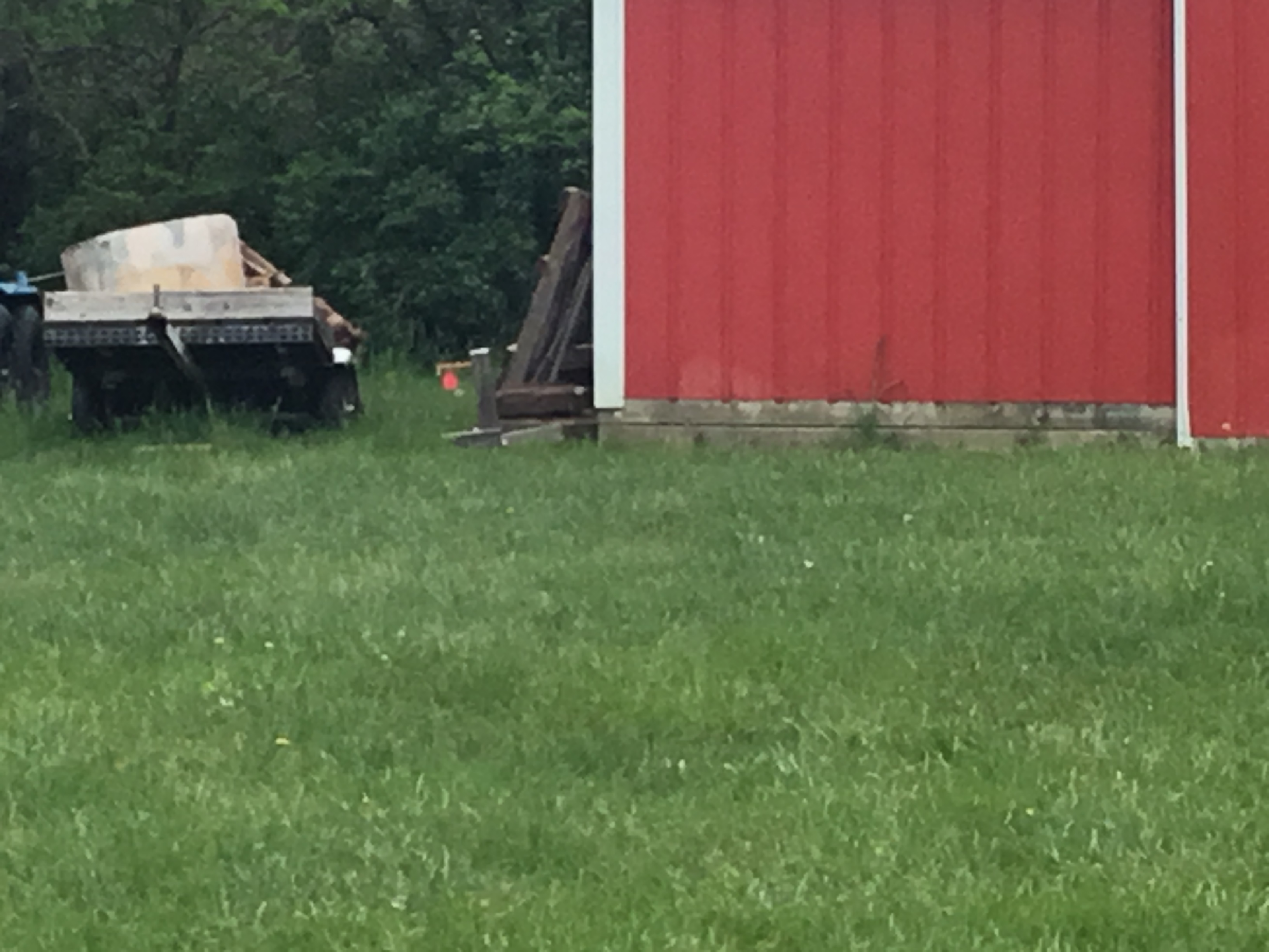

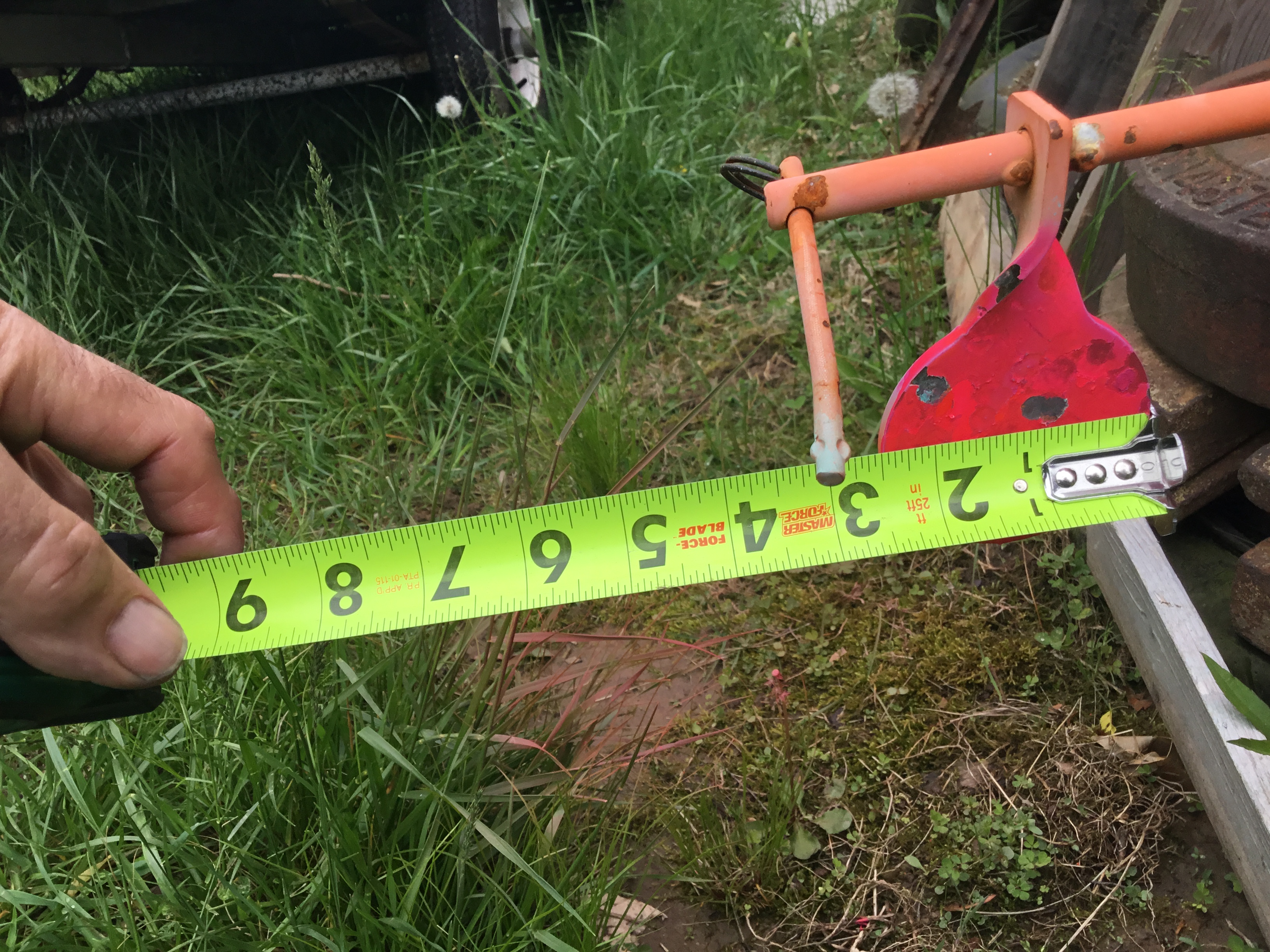

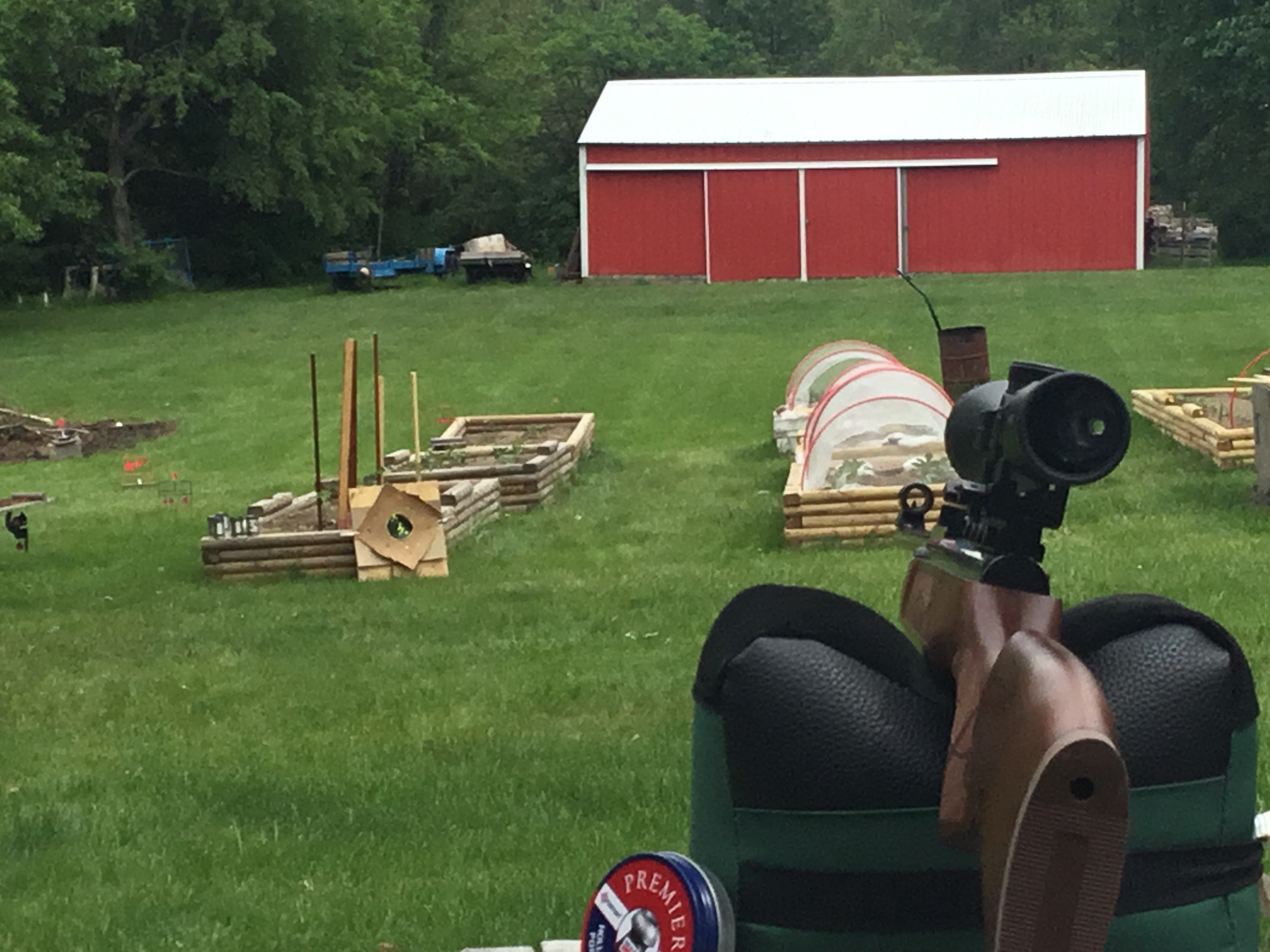

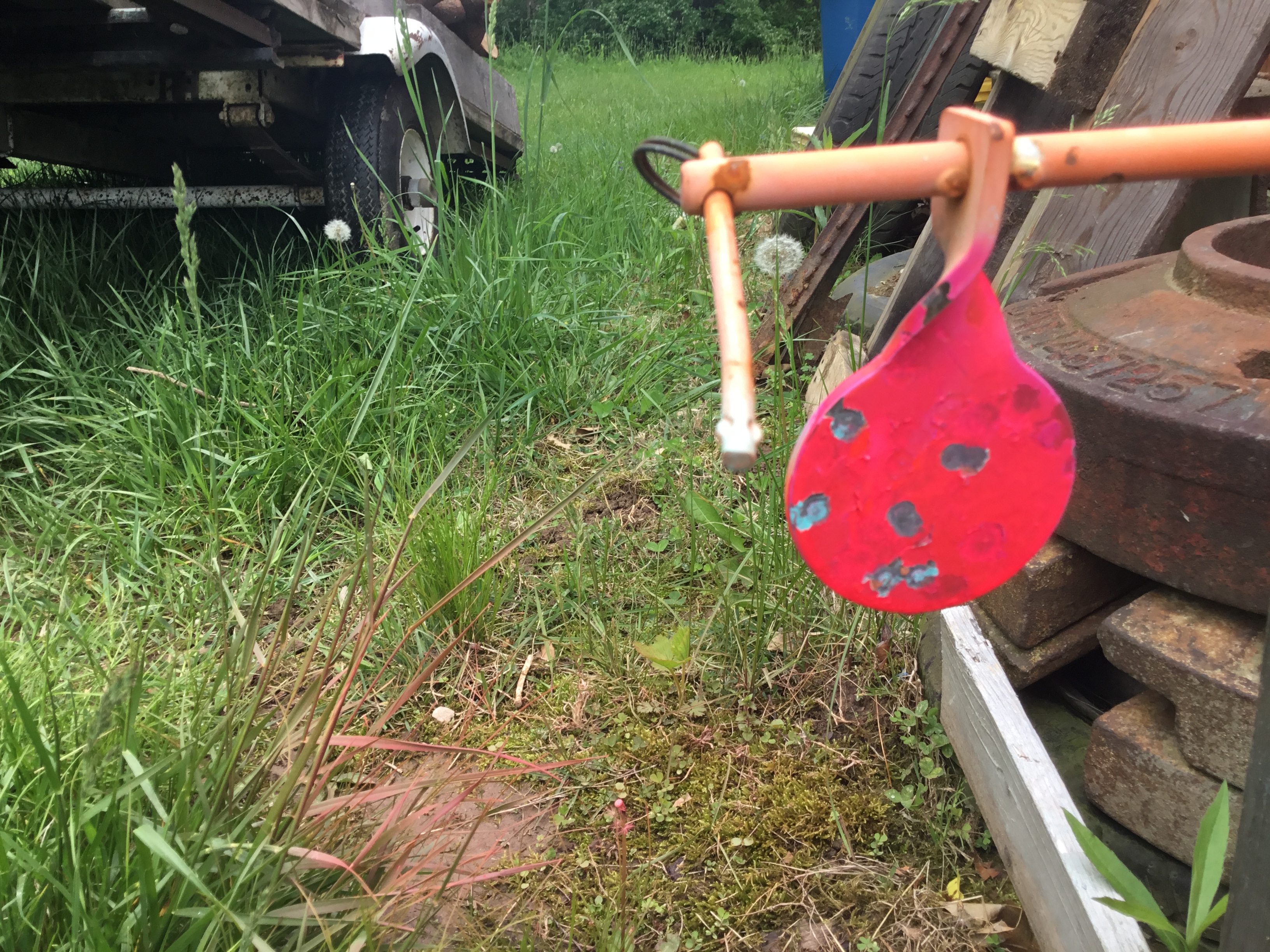

Ok update. I’m not going to send it back. (I’m pretty sure). Even though it has a ton of barrel droop. Many reason it SHOOTS amazing!! I have been able to shoot with it for several days . I am blown away how well it shoots! This morning No wind not even a breeze. So I tryed hit my 2 1/2. Steel at 100 yards I could hit😳 it .so I painted it tired again shot 20 time off bench. (I’m no sharp shooter) I’m pleased with this HW 50s 177. Shooting crosman7.9 hollow points. This picture shows the utg drooper mount. That I currently using an like. Also have this on my Diana 48 posting pictures. ( you count the hits) using a Nikon range finder it’s 100yards to front of shed from my shooting bench .
