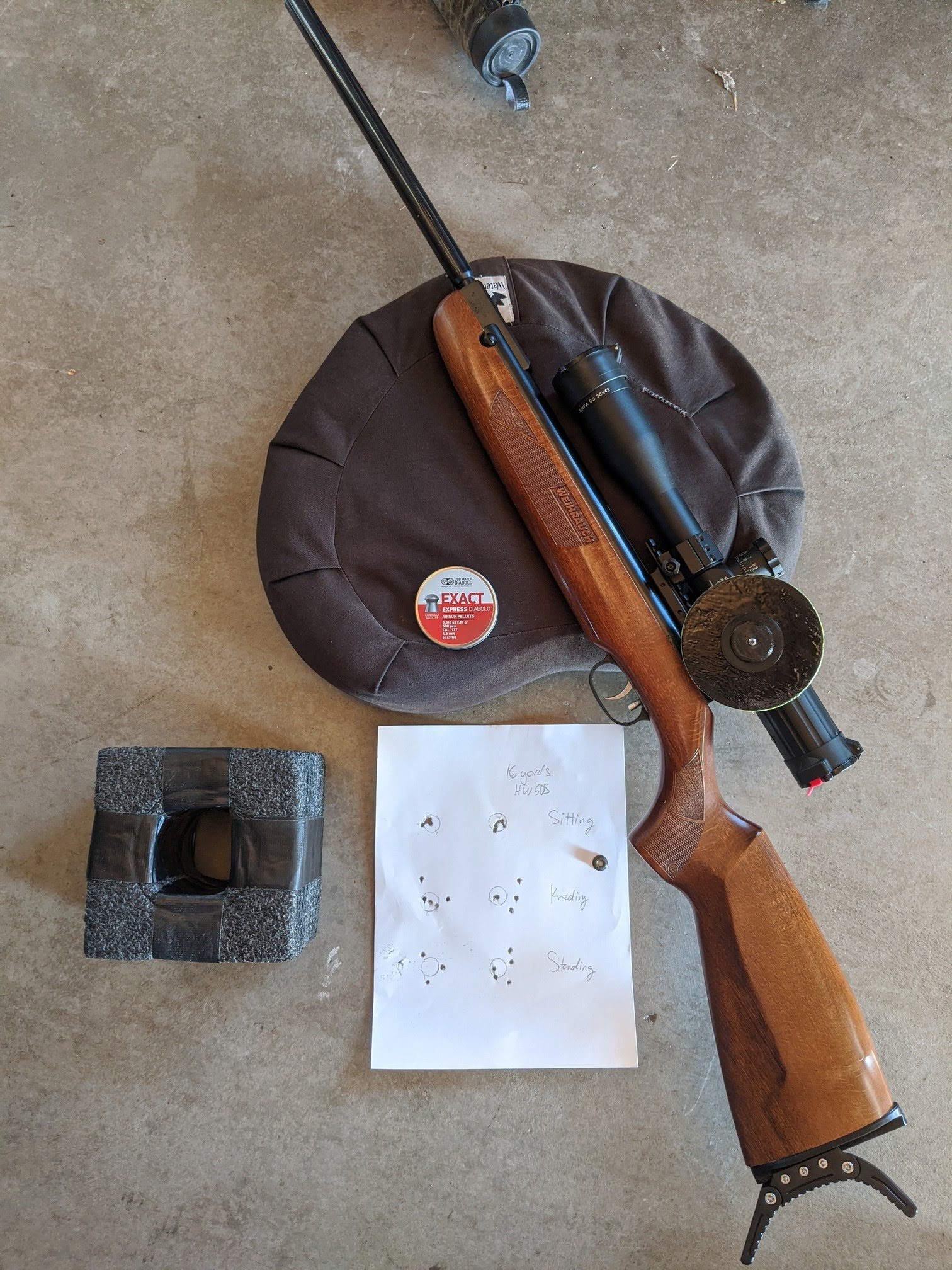

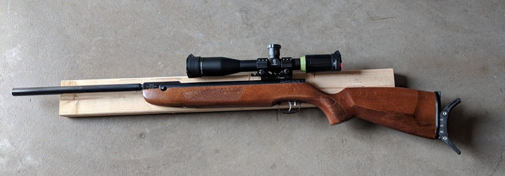

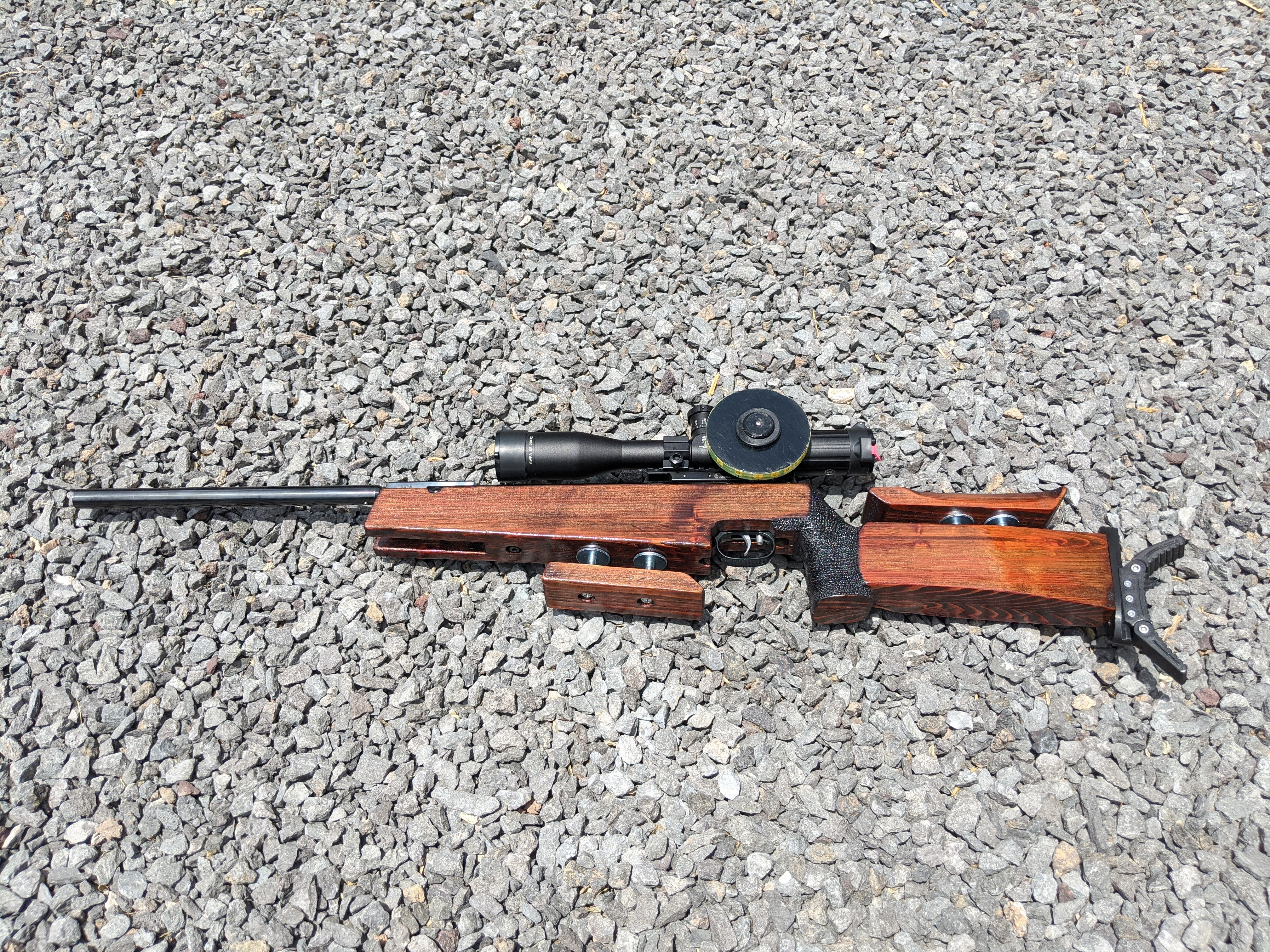

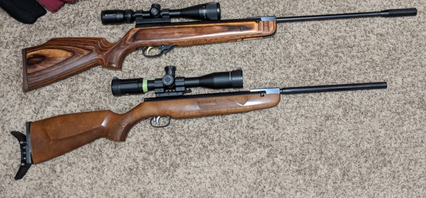

I have a .177 HW 50s that shoots the JSB 7.87 at an average of 705fps when it's hot, and about 715 when it's cold. That puts it at about 8.5-9fpe, and pretty close to what you're asking. I've stated a couple times in past posts that I like it enough that it's the only non-10m springer I kept, after cycling through a good number of high end springers.
Mine has a full power JM kit, using one of his sized Hornet seals.
I've had many comment that it's not healthy and should be putting out closer to 11fpe. But I live at 5600feet above sea level, robbing some fps. And I also like how docile it is that I have no plans to change it.
So, in my opinion, a 8-10fpe HW50s in .177 is a perfect package. Just the right size and weight (I found the new FWB Sport looonngg, and I found the RX2 and HW77K simply too heavy). I'm no longer pulling my hair out trying to keep scopes from sliding and stock screws from coming loose.
Next to an RX2 for size comparison.
And in a field target stock I made from hardware store limber.

And in a field target stock I made from hardware store limber.View attachment 362880
View attachment 362876View attachment 362879View attachment 362878

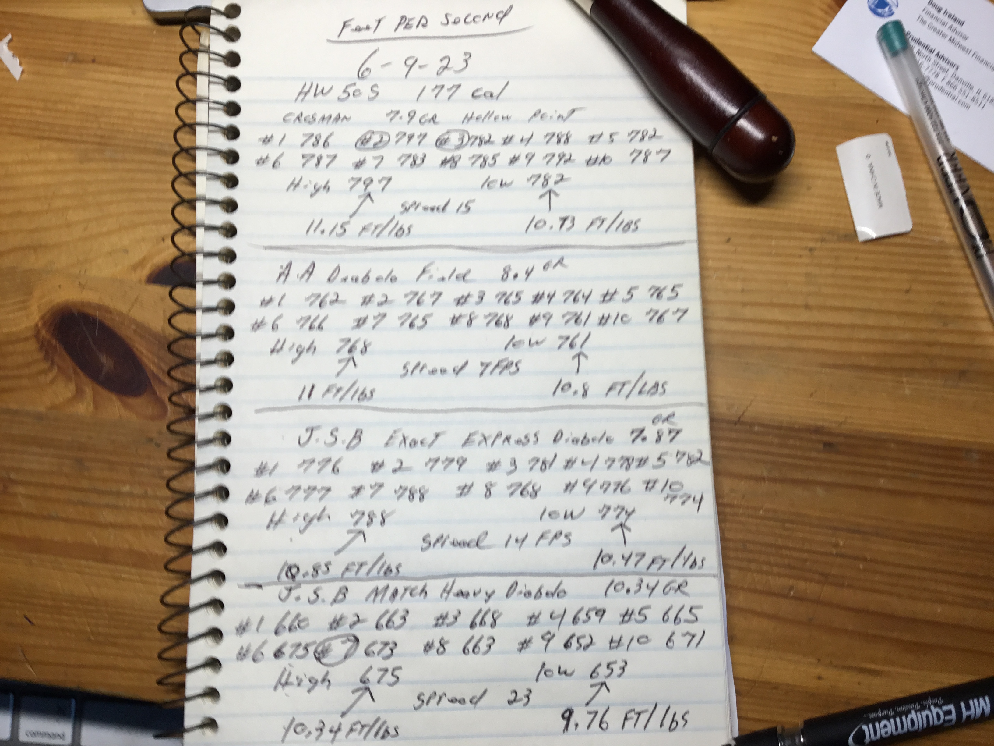

This is my new about 5 weeks old HW50s 177 cal 1000 pellets shoot. Never been apart Just ran her over the crony this morning
Feet per second and foot pounds of energy 4 different pallet

This is my new about 5 weeks old HW50s 177 cal 1000 pellets shoot. Never been apart Just ran her over the crony this morning View attachment 363282 Feet per second and foot pounds of energy 4 different pallet
Thanks Frogy. Thanks for sharing your notebook. Those power levels are just about what I’m looking for; especially with the 10.34 pellets. Your rifle seems to shoot a bit low for a factory tune. Do you live at a bit of a high elevation?
