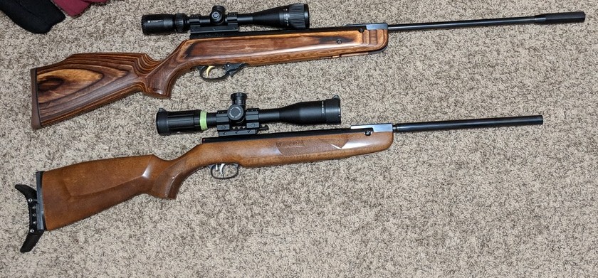

The jointed cocking linkage that you mention is still present on the current HW50s guns. I kinda have a theory that that feature is a big reason why the gun is such a stable and consistent performer. The jointed cocking linkage allows the slot under the forearm to be much shorter, which in turn allows the screw(s) fixing the front of the action to the stock to be under the forearm instead of the two normal screws on either side of the stock forks. I personally think that the screws that hold the gun through the stock forks are a big reason why guys have trouble with inconsistencies in springers. If you look at a springer stock without the action, the stock forks look just like a tuning fork. I feel like that allows the vibrations of the shooting of the gun to create some kind of resonance that makes the screws loosen. That's where you get the star washers, and the blue loktite, and the other band-aids like steel posts to bottom out the screws on. All of that is to combat the fact that the side screws through the forks simply won't stay tight. You've also got the possibility of those thin wood pieces of the fork contracting and expanding with temp and humidity levels. My HW50s never needs the screws to be tightened-they never loosen. I think it has to do with only having two screws holding the action to the stock, both of which are on the bottom of the gun and none of which are through the vibration-prone fork of the stock. Just my thoughts, based on personal experience.
