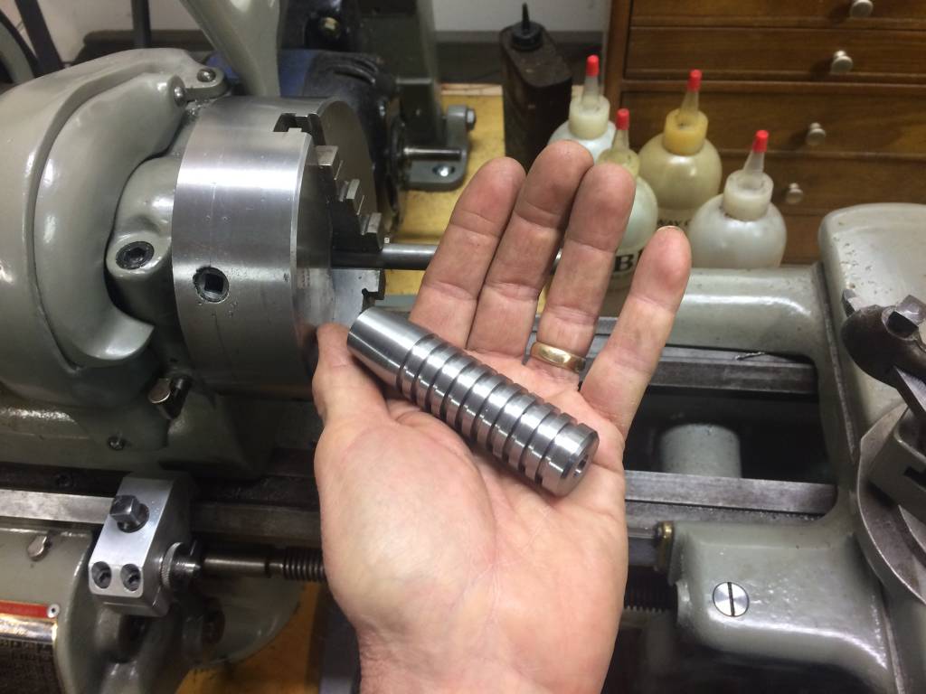

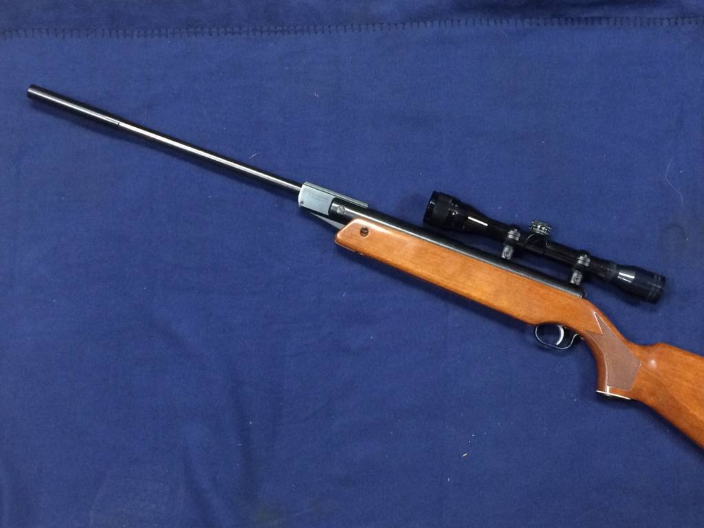

I make some with a shim like the old Beeman brakes had so you don't have to worry about the dovetail crimp. The shim slides on past the crimp NP.. Then the set screw goes onto the shim preventing the set screw from damaging the barrel..
I've also made sleek steel ones painted with a tough black epoxy paint. Held on with blue locktite. This one adds zero length to the already long FWB 124 barrel.
