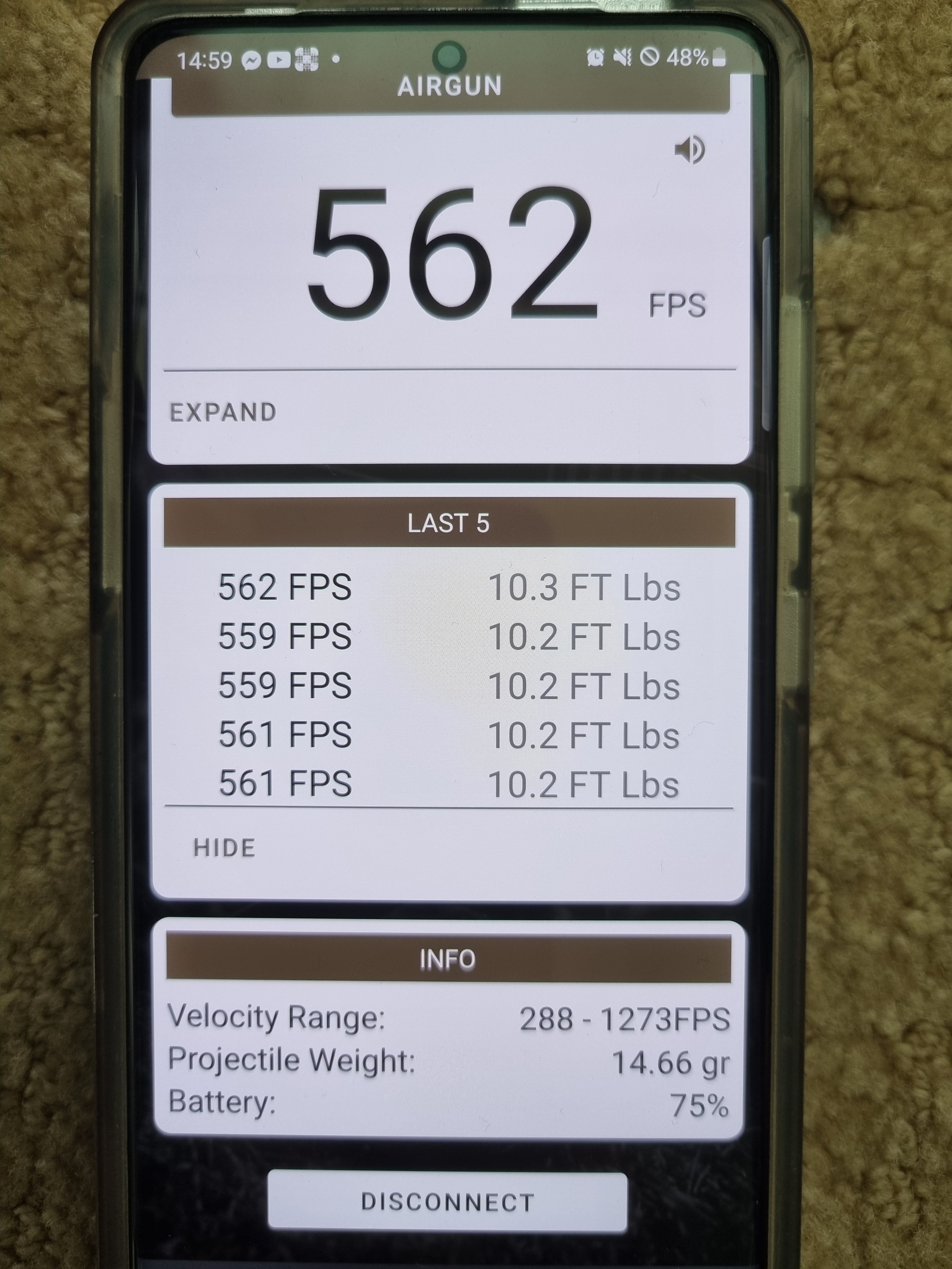

Just chrono'd the new 50. First shots were 617 and 605. I shot about ten more shots checking barrel angle before the ten shot chrono strings. Started decent at 591 the first string of ten. Steadily declining to 558. Big ES too 20 and 26 respectively. That's 11.37 declining to 10.13. There was no hint of dieseling. I imagine it might improve with use but I don't see it happening.

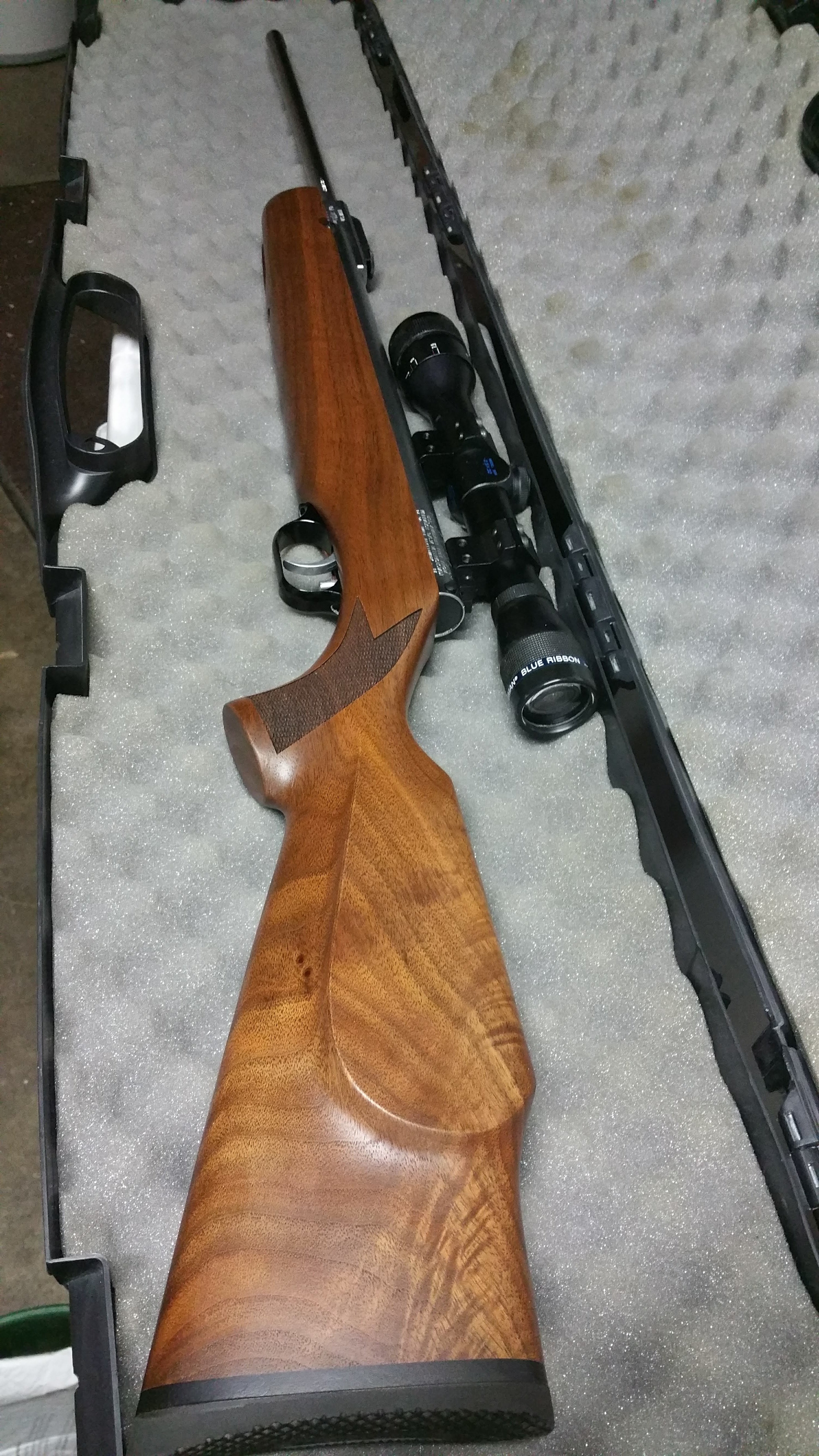

The HW50 in .22 can be a potent rifle if tuned properly. Mine has a Vortek kit in it. This guy has great knockdown power. Much improved over a factory tune. Also I added a JM walnut stock to compliment the beautiful stainless. finish.

Mate did you get it sorted? I replaced the original seal in mine with one I got from target tune india many years ago when I put in a tbt maxi pro kit. It went from just over 12ftlb from factory to a consistent 10.2 I tried installing a power washer but the rifke would not cock

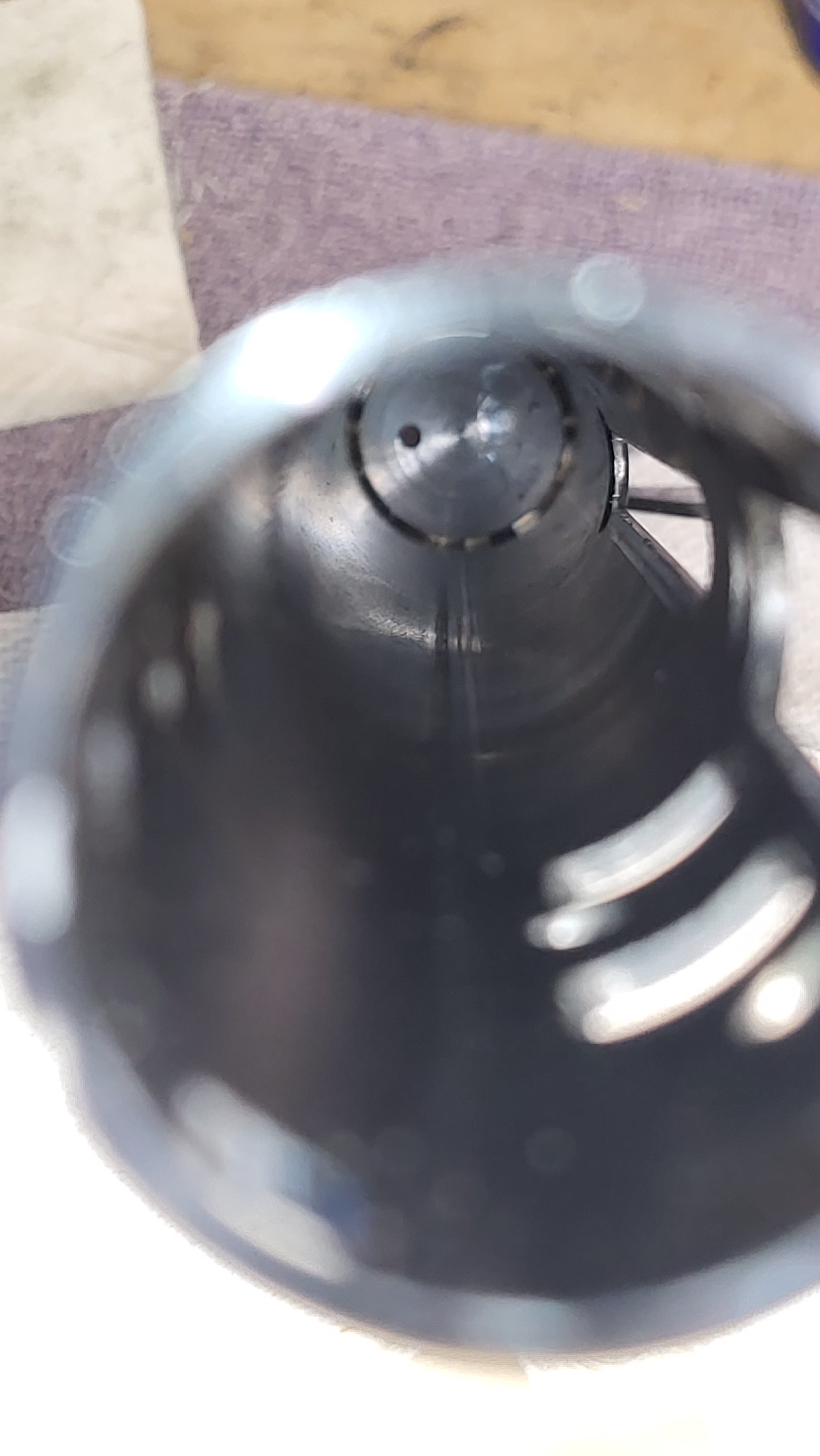

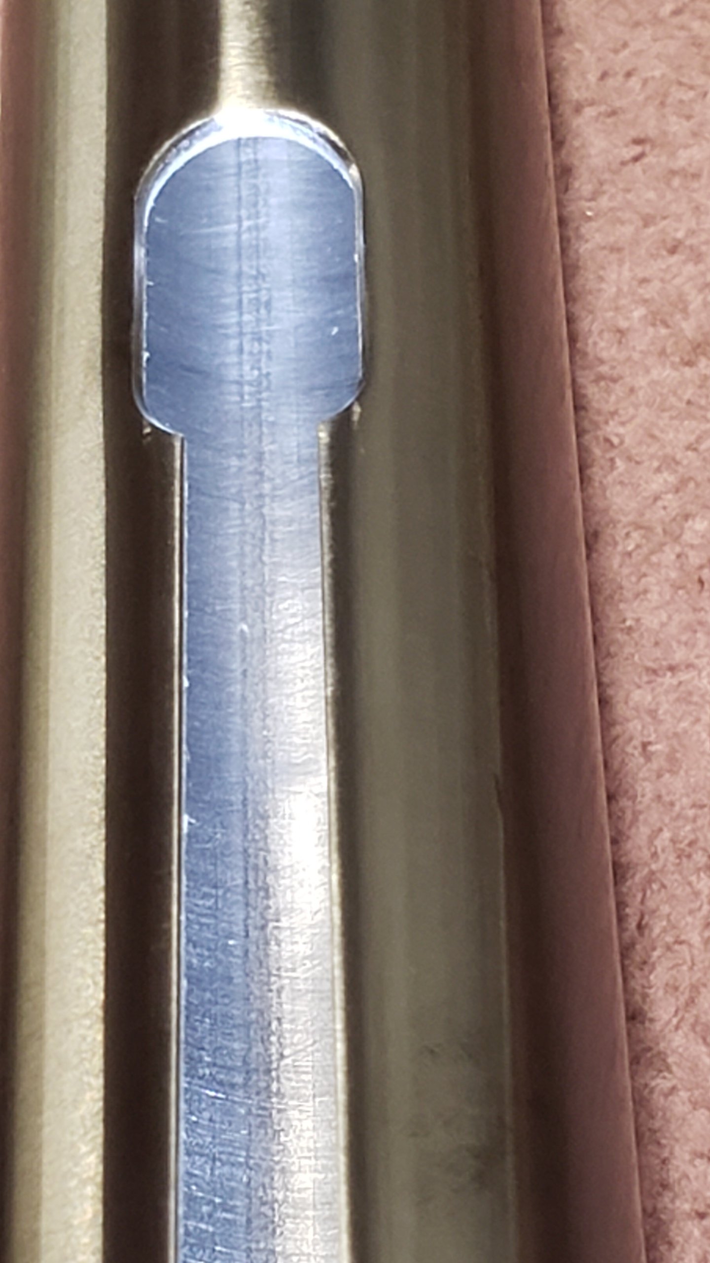

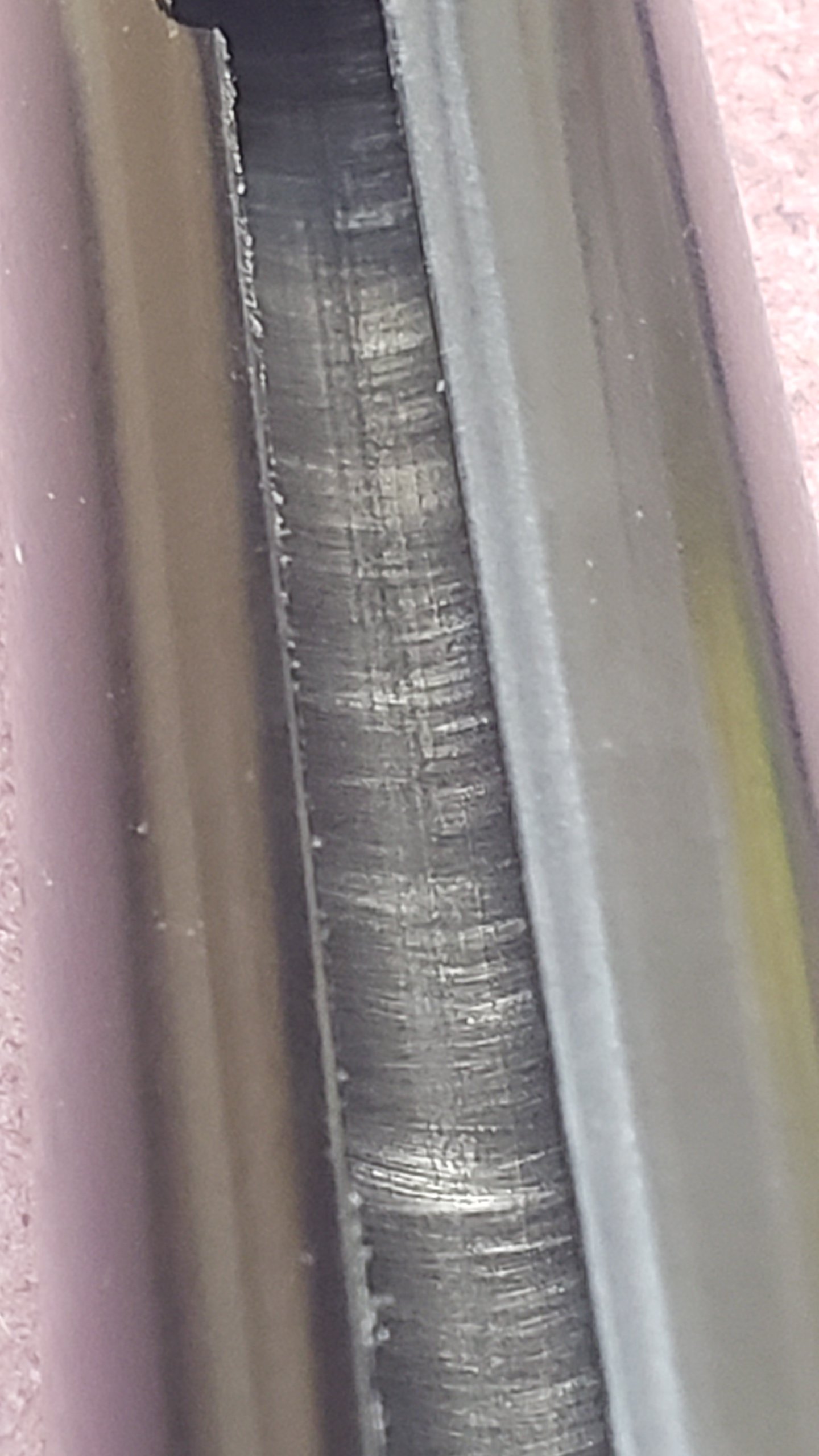

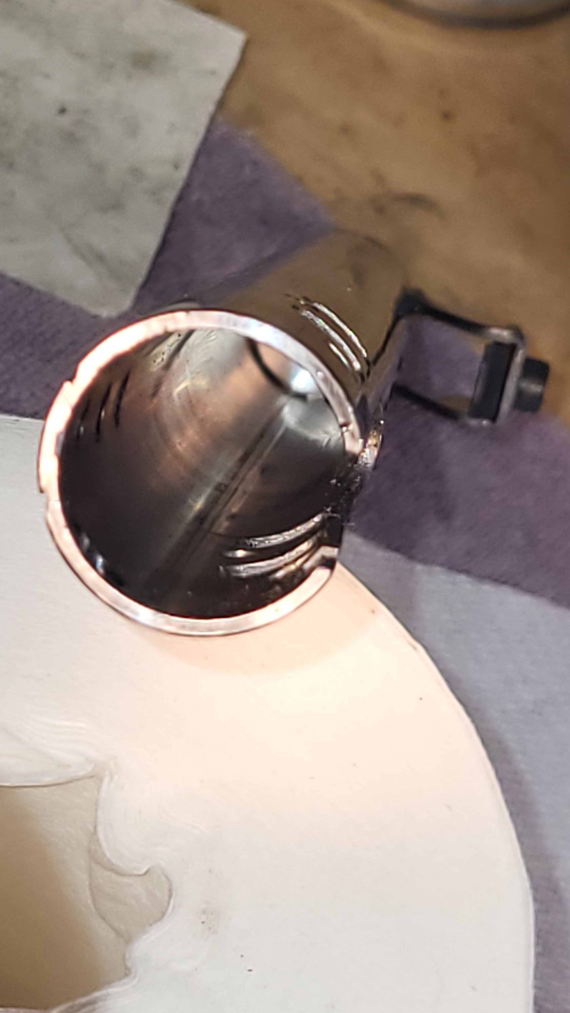

The latest problem I've had with varying degrees has been Weihrauch has been using welded tubing instead of seamless. If they've been using welded tubing in the past, they machined the seam out of it to where it wasn't visible or detrimental. The last three new Weihrauchs that have been sent to me (two 50s and a 98) had visible seams in the compression tube..
Visible and tactile are two different things. Neither are ideal when trying to seal a cylinder. The last rifle sent to me would never make full power or shoot properly. The seam which of course runs the full length of the compression tube will perpetually leak pressure and eat piston seals.
Nothing short of honing the cylinder oversize would fix this gun. I've honed plenty of scored up used guns. It certainly shouldn't be necessary on a new gun. This one was beyond reasonable salvage. I recommended the customer get their money back if possible.
