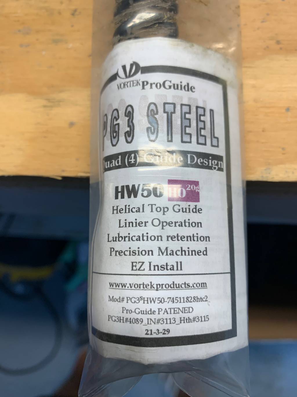

@Jlowe, I've been reading with interest about your HW50S / Vortek tuning and I'd like to get your opinion on my situation.
I have a new HW50S .177 and plan to install a Vortek kit in it shortly. The kit I received from Vortek is an 'SHO' kit (not 'HO') and I've been reading that this SHO kit has a thicker spring wire than the comparable HO kit. Based on your experience with both kits, can still use this SHO kit in a .177 HW50S without any issues?
Thanks in advance for any advice, your HW50S posts have been enjoyable to read!
Check post #10 in this thread; I attached a photo of the kit I received.
