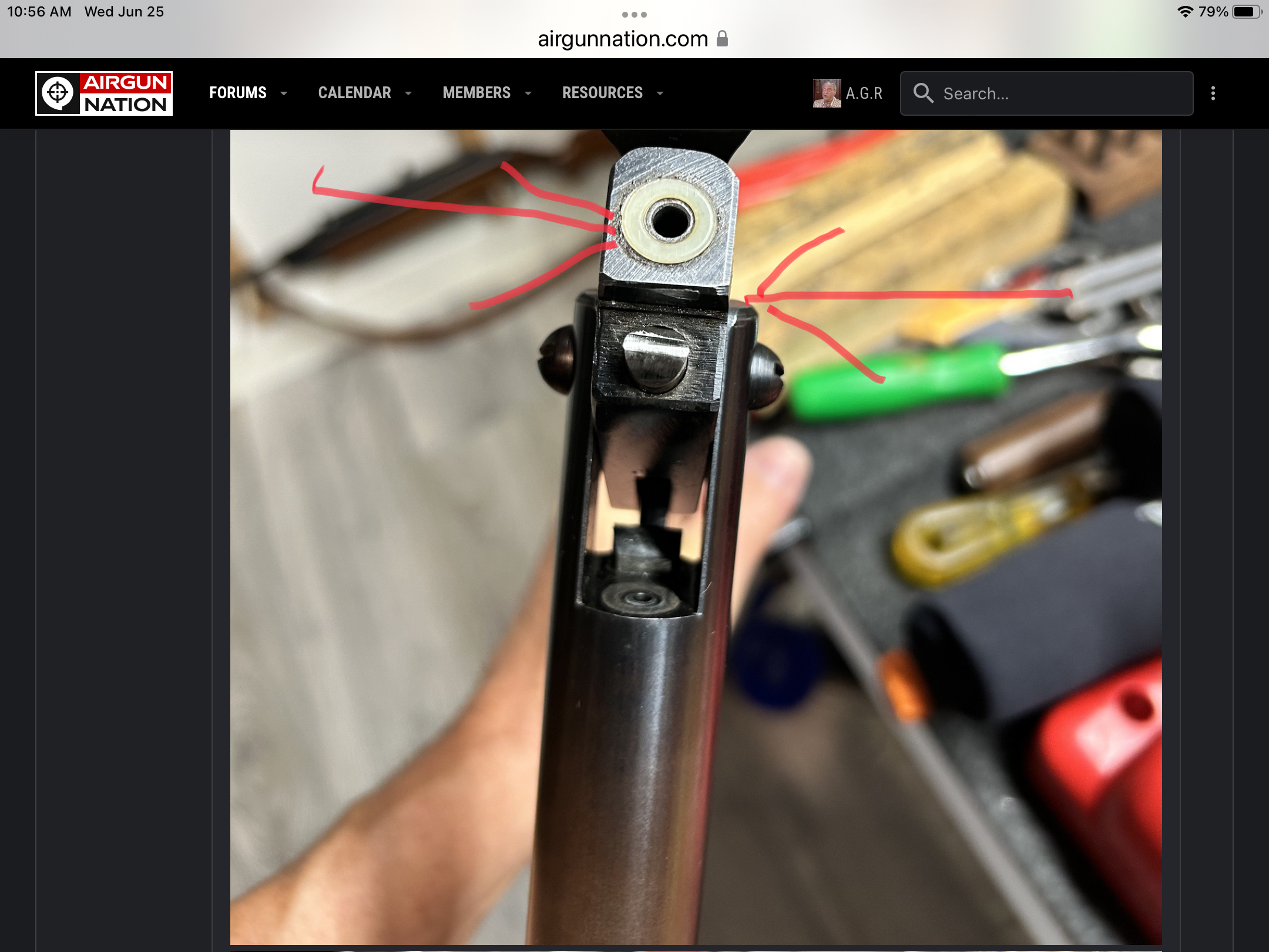

When the barrel bends due to the piston breaking off ( triggering off ) the barrel sticks up, not down.There are only two options here: either the barrel is not original, or someone tried to repair the wear in the hinge ineptly. In any case, the road to Gunsmith. Anything else is unlikely.
I well aware of what happens from up flying barrels. I never said it had anything to do with droop. Give me a little credit. I was only addressing the suggestion the fork fit might be a result of it.

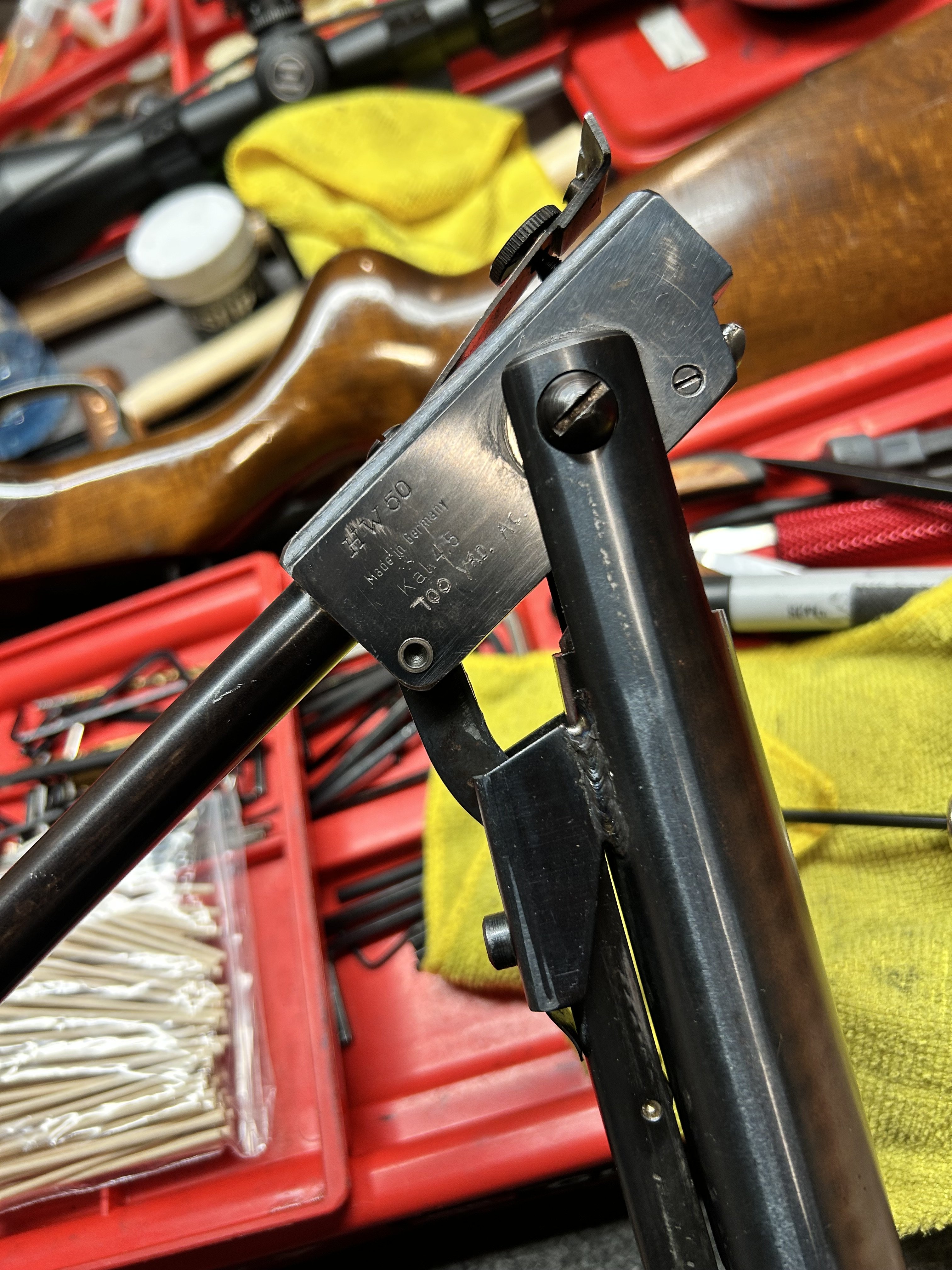

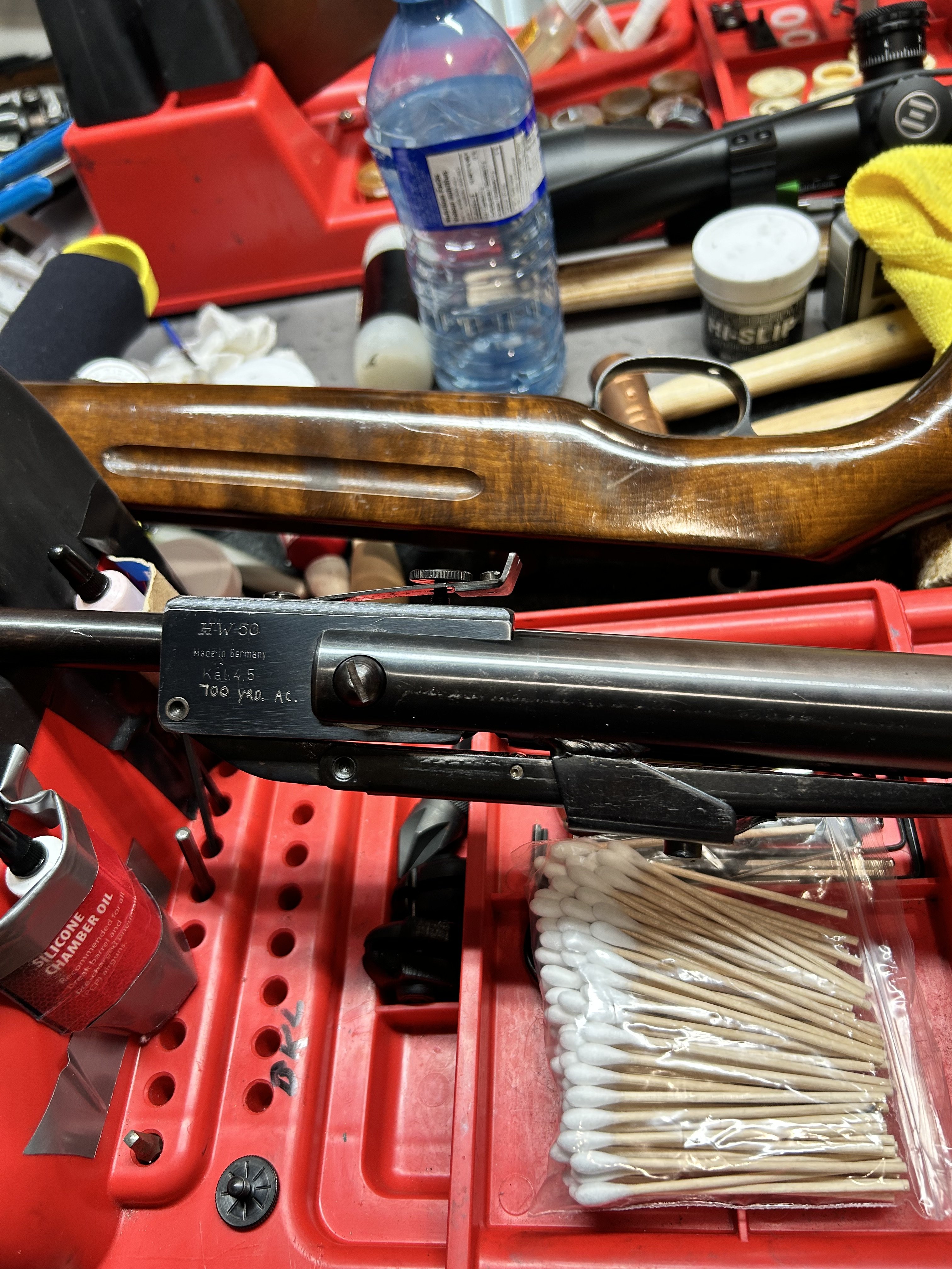

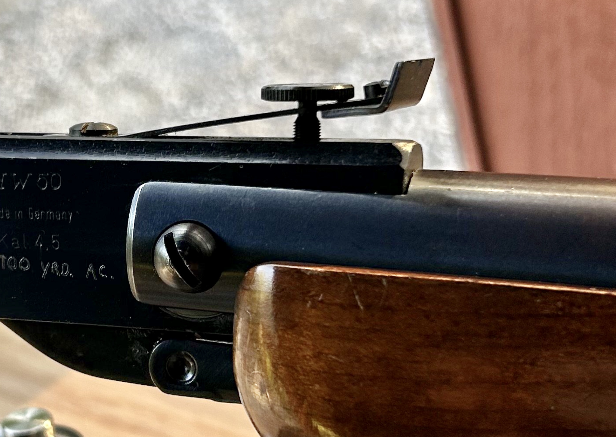

I wonder if that is an economy version gun made for the non US market, using the less expensive rear sight than we were getting in the US by 1972, and if it's a "club gun" that is very heavily used, with all the blue worn off the barrel and receiver?
For many years the HW 50 was made in two versions. The cheaper "HW 50M" typically had the simple signts and Perfekt trigger, and the upmarket "HW 50S" had the better sights and Rekord, but it was easy enuff to mix'n'match parts. There were also upgrade stocks available. Air Rifle HQ was the biggest US importer in those days and had both versions.

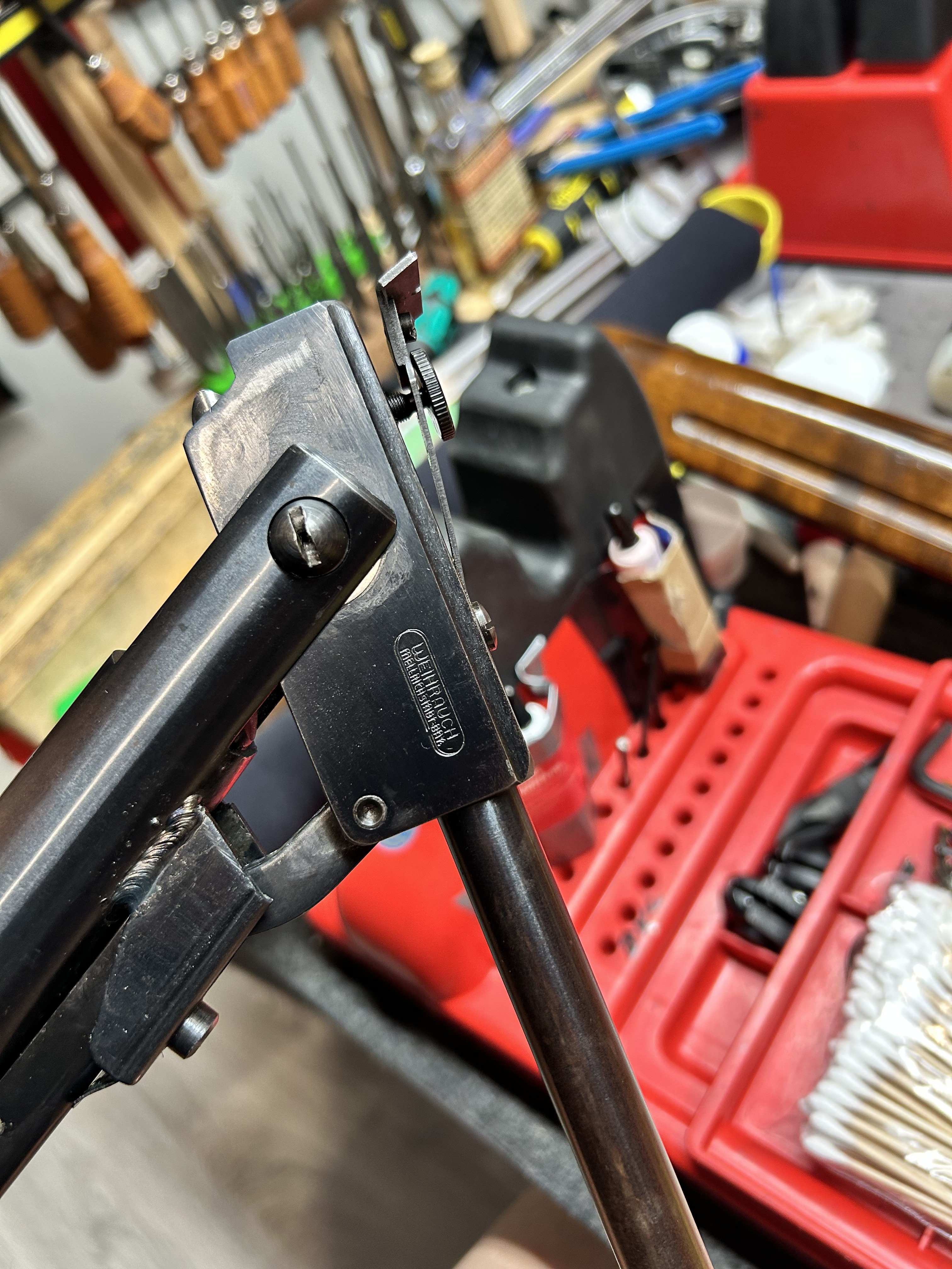

I would kindly request 2 or 3 pics of the action taken out of the stock, including 1 or 2 with the breech fully open. That would limit the number of dumb suggestions I can make, LOL!
The rear sight adjustment screw is wrong thread. It will only turn 1/4 turn. Crow
I can do that for you. Have to be in evening. Crow

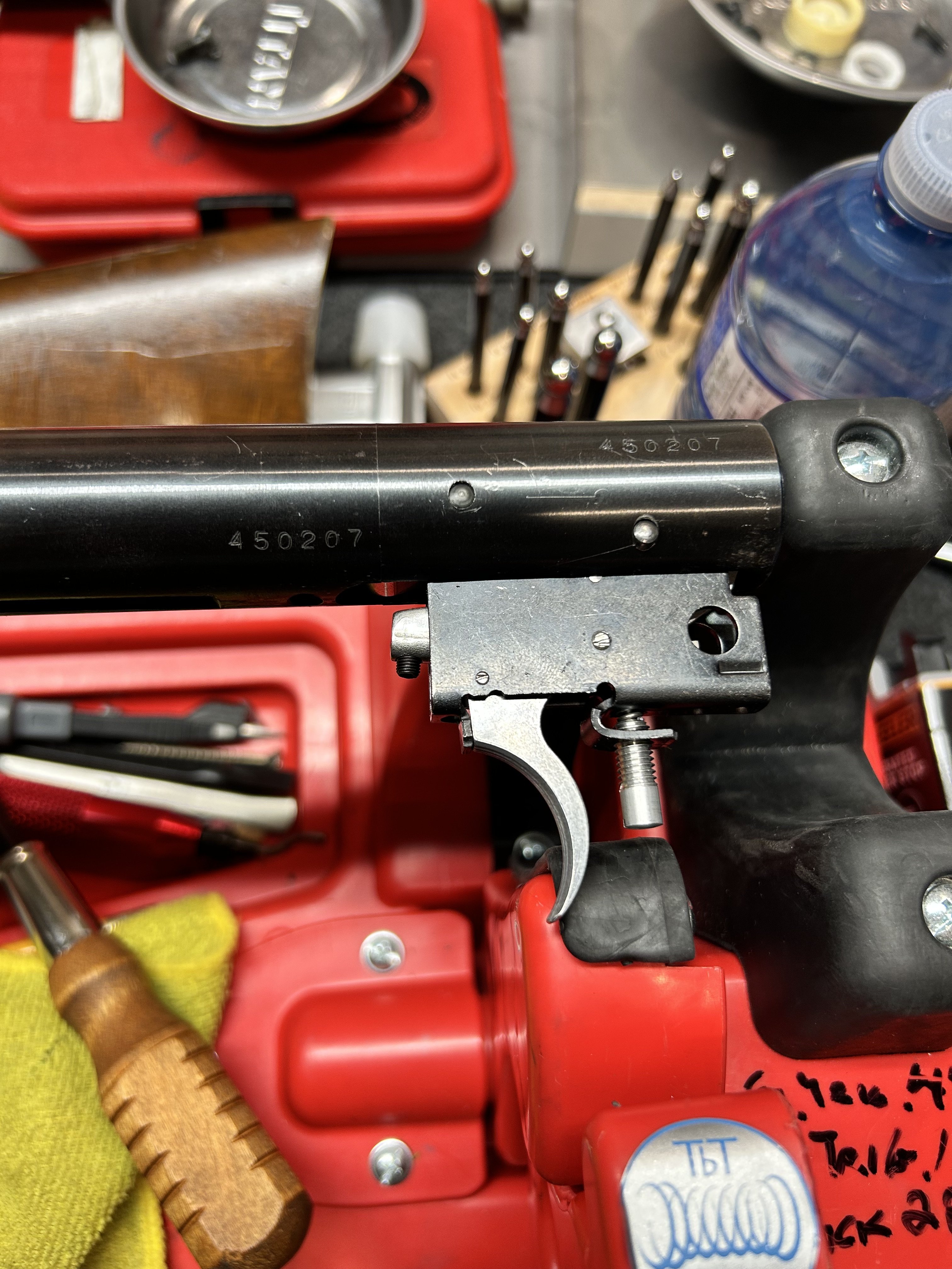

If I remember correctly some trigger assembly parts were crushed. I got the trigger from UK.
