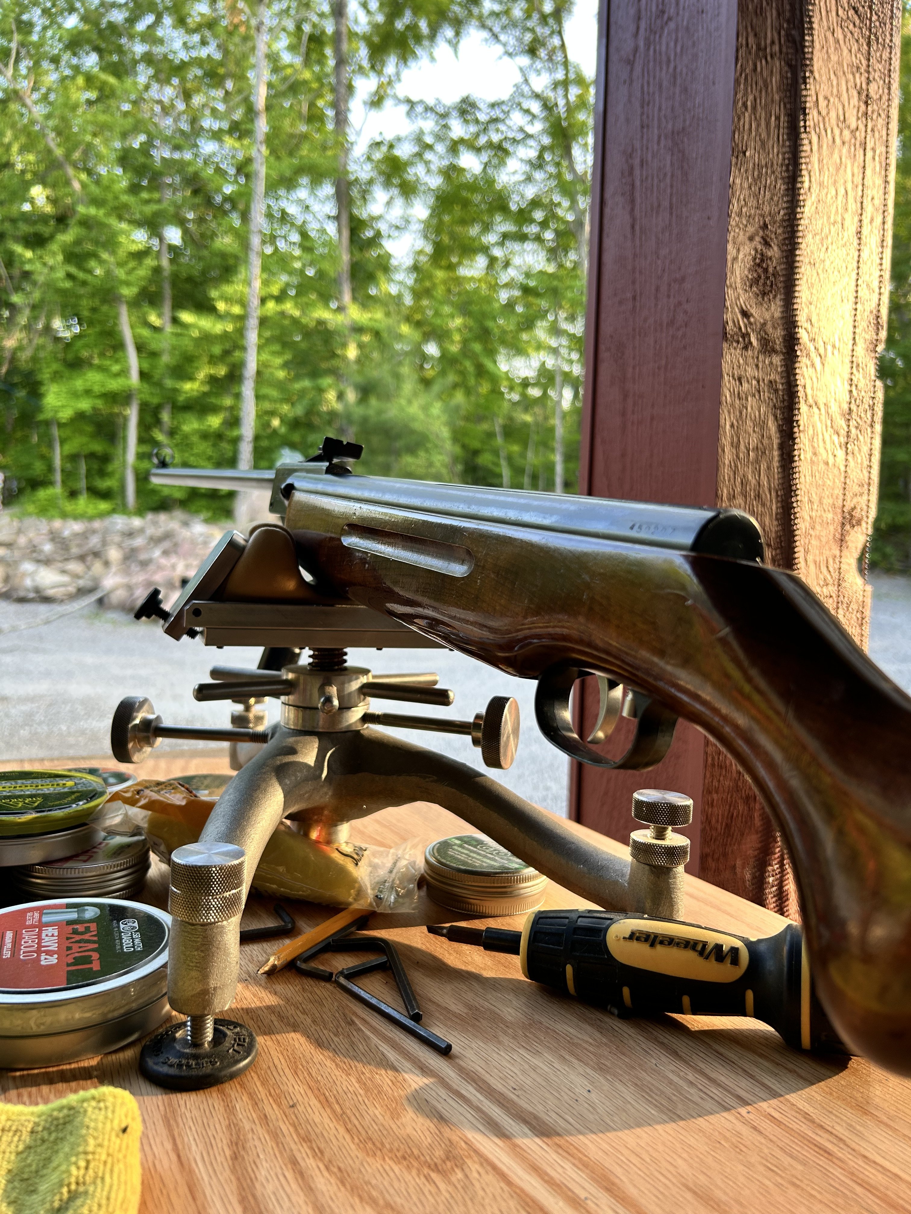

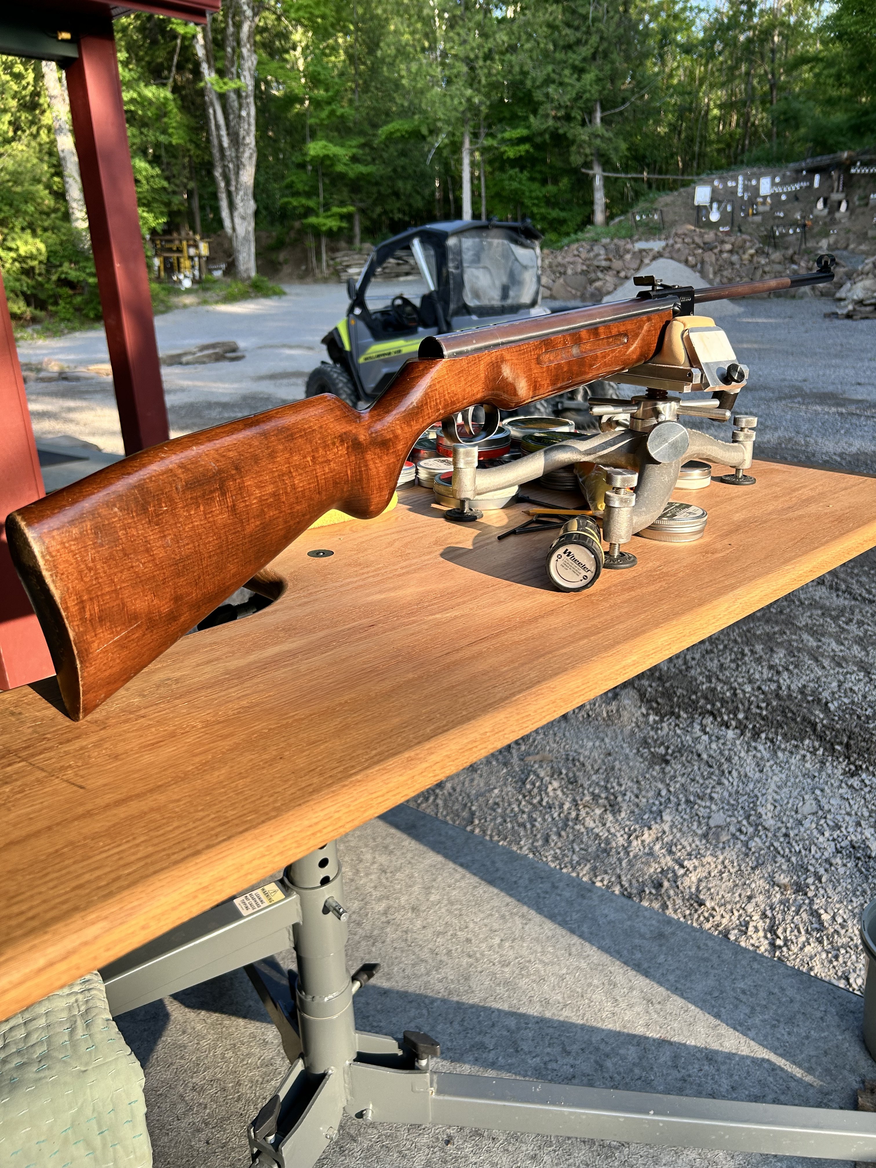

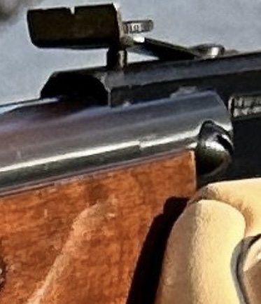

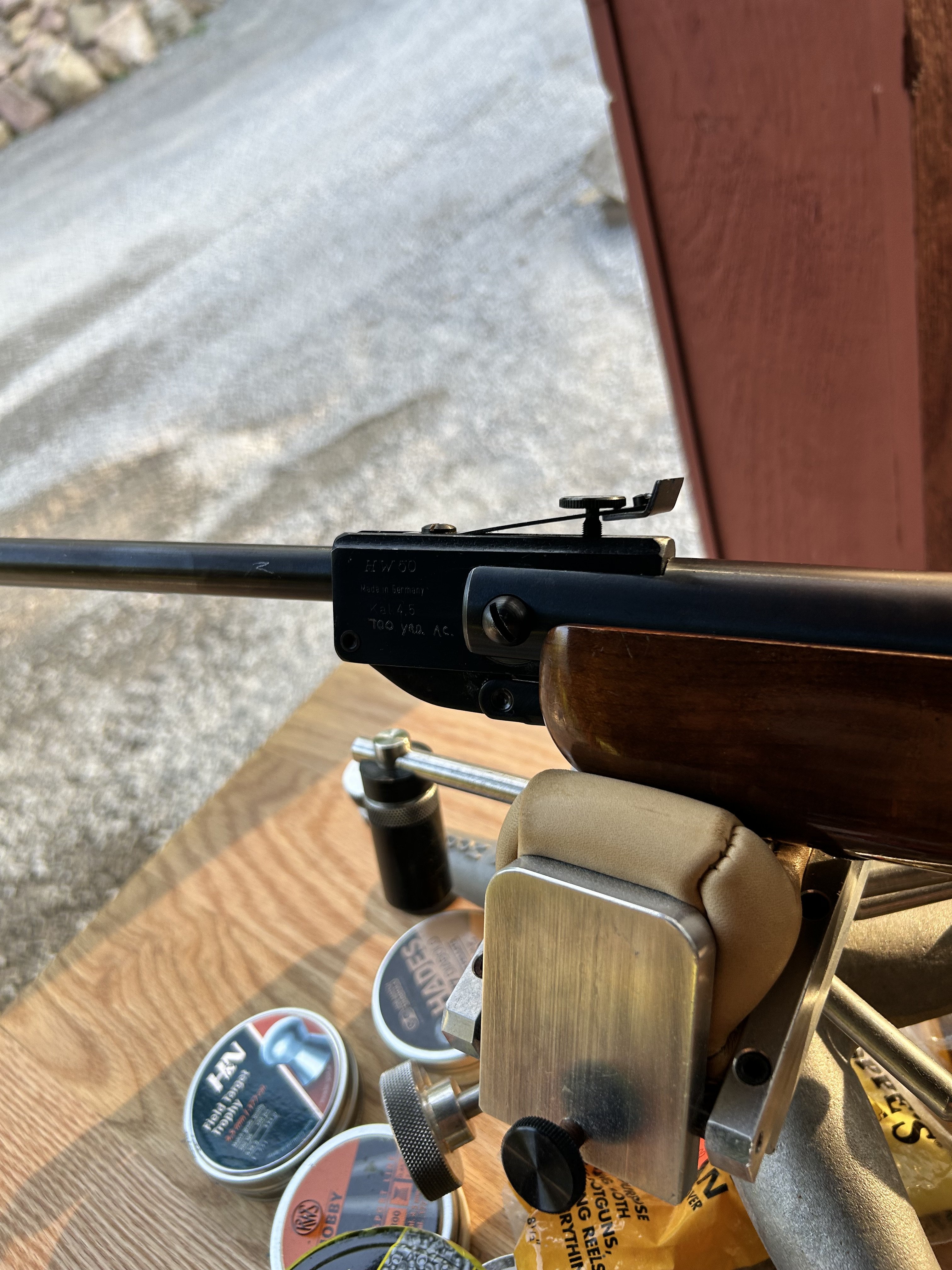

Yesterday I brought it to the range. Shot at 25 yards the Center of a 12 inch plate. Swing and a miss. Hmmm. Aim for the top of plate. Swing and a miss. Aim for the bottom. Bingo. Barrel droop. Check this out.
I have no idea of this guns history. I’m wondering if the barrel was swapped out.

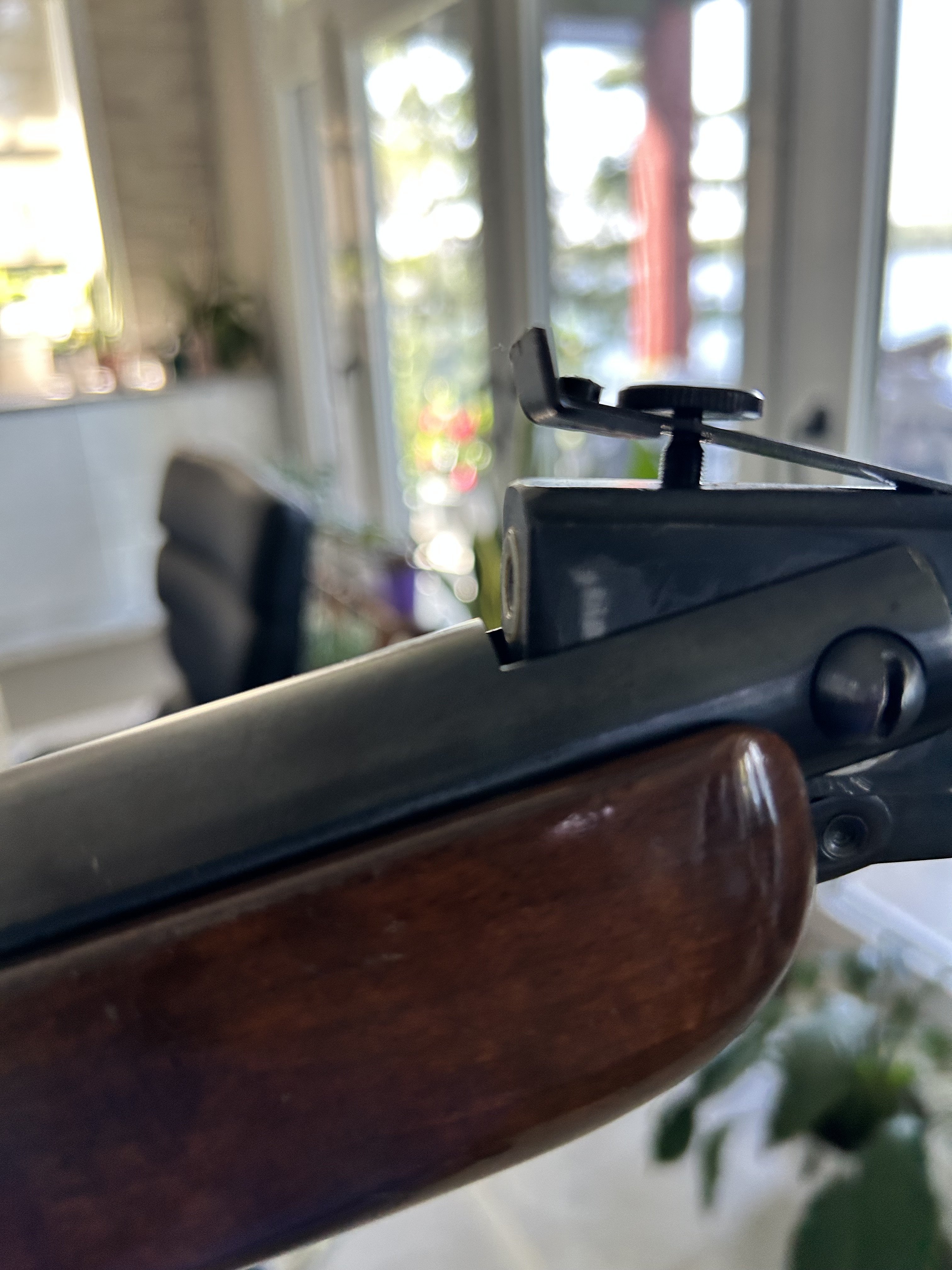

I don’t think the breach fits square.

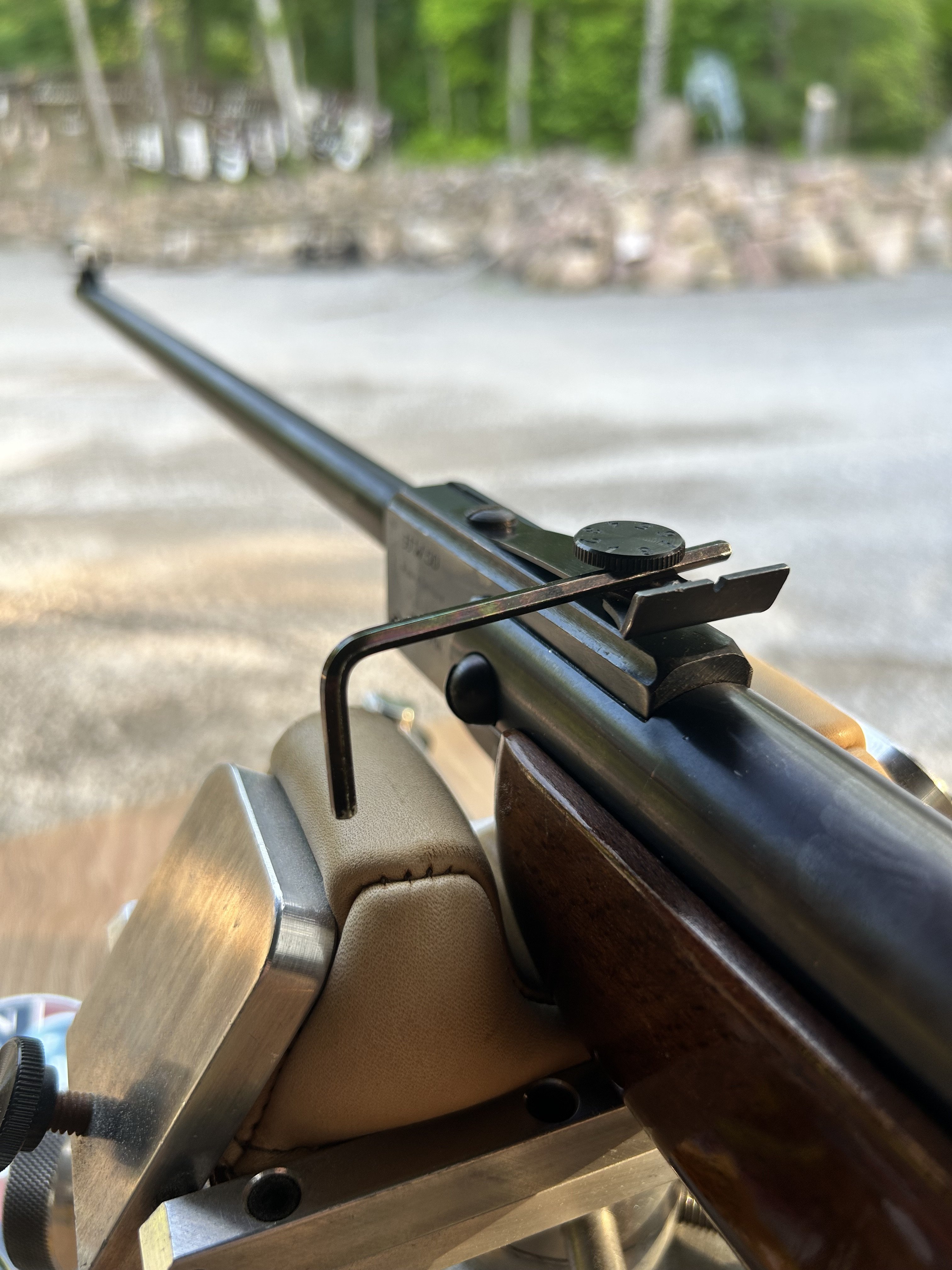

I couldn’t adjust the sights down, even the adjustment screw seams wrong. Got it closer with an Allen key.
It shoots and sounds great. But I‘m stumped.
Is there an adjustment to make breach fit better?
Bend the barrel?
Any suggestions?

That’s breech hang up. The bottom area under the block need to be filed to let it drop to level it as well as may have to relieve the face a tad. Depends. It’s all by experiance And feel . Seals will need to be fitted to.
It happens mostly with barrel swaps as tolerances can carry and .05/+- mm can make a huge difference when the breech hits that flat area under the chisel detent
HW RARELY have barrel droop and mostly from fly ups while cocking.
You need to disassemble it check the breech for strait ness to barrel .. I use my granite counter top
Bending won’t fix a poor sealing lock up. Only slight material removal to fit the action will you can clearly see innthe pic the difference in the side pic of the breech line to fork gap.

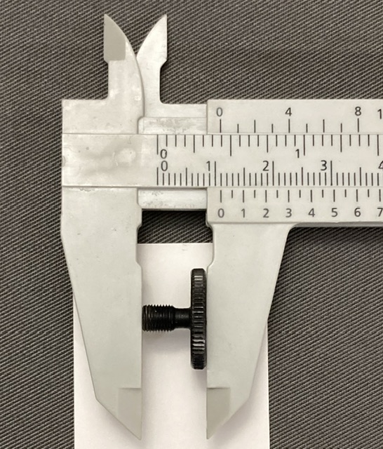

The droop is a non issue with both sights on the barrel. I'm pretty sure the adjustment screw is wrong. It looks too tall. Probably from a later sight. Stack washers between the adjustment screw and sight leaf until it works right. You might have a problem with the adjustment screw obscuring the notch.

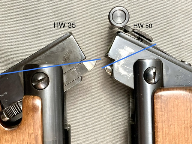

3. Don't bend the barrel. Your pics look like the barrel aligns with breech block, so IMHO you are correct - the issue is how that breech fits. You really have "breech droop!"
4. Check first if the breech seal is properly seated. The gun may have had a leather seal that was not completely removed before sticking in one of the current plastic ones, or some such. If the seal is OK, you may be right about its having a barrel/breech block from another gun (see pics below).

Mycapt65 is correct, a little droop shouldn't matter per se. But with such a severe misalighment, at 25 yards the wild disagreement between trajectory and sights might be very low velocity from the transfer port not fully aligning with the bore?
Can you post a pic of an open breech? The seal should protrude only a few hundredths of an inch.

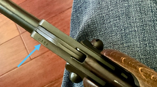

A 50 that old may have part of the serial number under the breech block, if so that will immediately show whether it's original to the action.
the easiest option is to bend the barrel , carefully ! a little goes a long long way . MY HW30 looks the same @ the breach .
