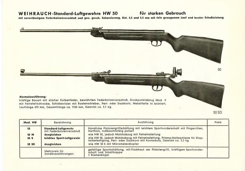

"1953 Weihrauch was also building the HW35 (in 4.5mm and 5.5mm) and the HW55 (4.5mm only) alongside a sporting version of the HW50V, the HW50S. The "first series" of HWs had a seagull symbol stamped into the left side of the breech block and short trigger blocks. V
So some kinda sporting models?
Could be just trigger or sight difference between the 2 ?
Another mention from garvin
I am now reliably informed (thanks specie!) that "V" stands for the German word for "improved." So it may very well signify the switch from smoothbore to rifled barrels. IIRC the occupying Allies did forbid rifled barrels for some years.
I have a 1959 HW brochure in which the "V" is gone. But "M" denotes an HW 50 with a simple trigger sear-engagement adjustment, "S" adds a grooved receiver, and "SD" adds a match sight Also there is a note at the bottom of the page for an upgraded stock. The HW 35 and 55 had the then-new Rekord, but apparently not yet the HW 50.
