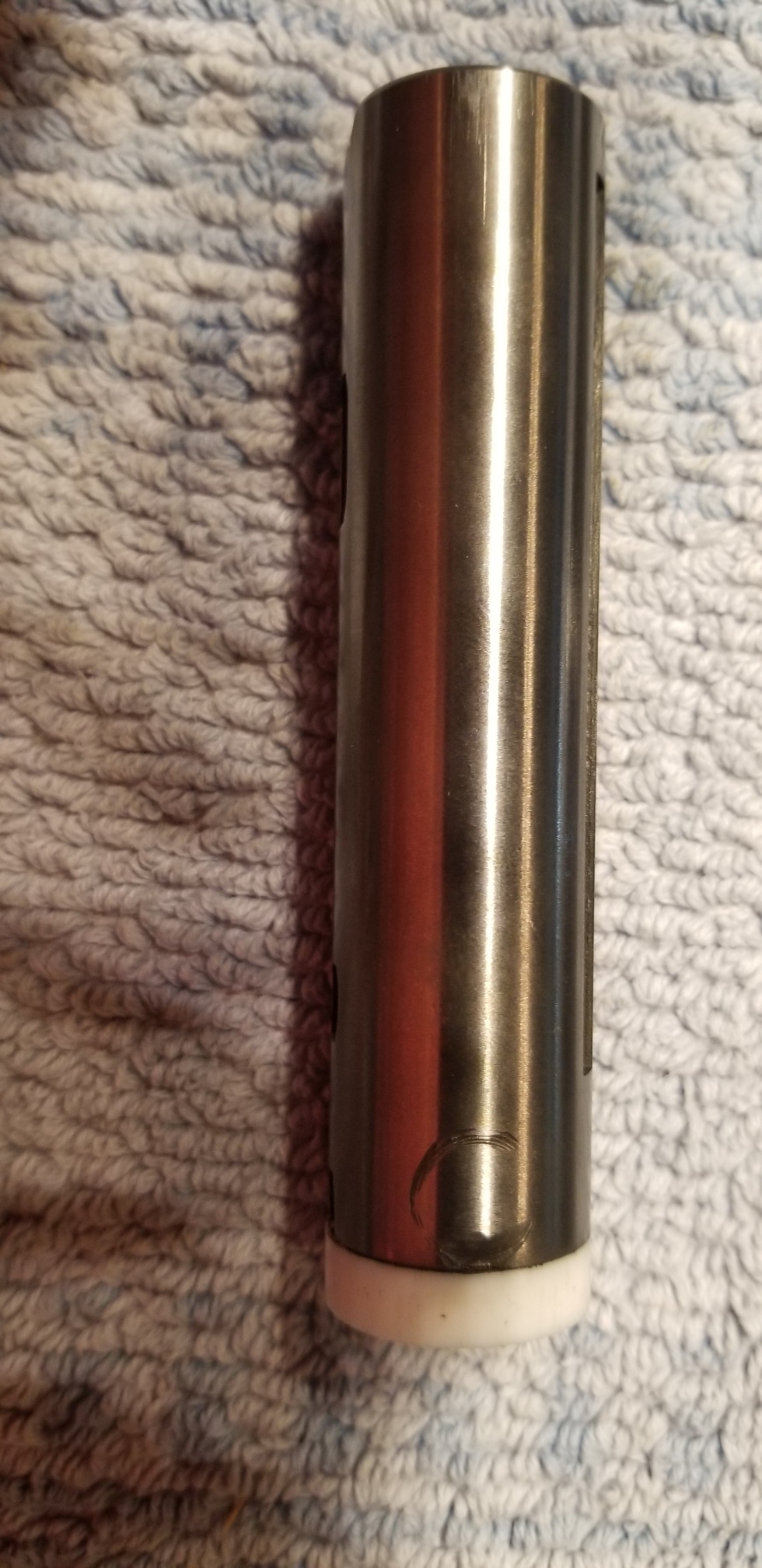

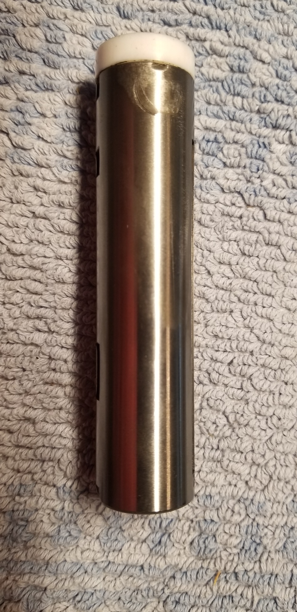

Any of you HW experts seen this before? Extreme spread was too great so I took it apart and found this. No metal in the gun, compression tube looks great, all the other internals look great. The gouges are 180 degrees opposite each other and are perfectly round except for the big missing chunk near the seal. Bought this used and description said it was still dieseling from the factory lube, so wondering if this could have been a manufacturing defect?
HW45s never stop dieseling. There's a lot to learn about that gun. Too much for me to post. Plus it's already available. Just Google about the gun. I don't see any defect in the piston. The scraping on the tail end is superficial and I believe the marks left on the sides near the seal are remnants from the manufacturing process. Neither is the reason for a wide extreme spread.
Yeah, I’ve had some good reads and discussions with Steveoo and some others. The pictures don’t do it justice LOL. The circular mark near the big gouge by seal is surficial. The big gouge is 0.25 mm deep. Circular gouge on the other side is 0.20 mm. The small indentation near seal on that side is also 0.25 mm deep and looks like it was meant to be there, so I’m guessing maybe a piece broke off on other side. I wondered how it would affect things since the scratches are behind the air mass and the piston shouldn’t touch the compression tube. I’ll take your word for it and will just replace the piston seal and see what happens.
