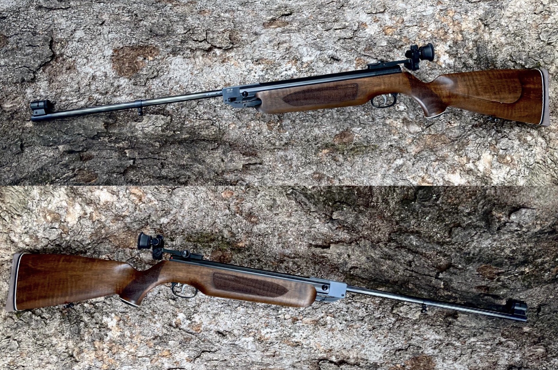

HW35E with Weihrauch Diopter
HW35E in .22 caliber. The new checkered version. Equipped with a Weihrauch diopter. Came from Krale a month or so ago. Waiting on Tom at Vortek to get the 35 tune kits back in stock. Will not use these Weihrauch’s with the jointed lever until it has a kit with a sleeve. The sleeve eliminates the possibility of the lever galling into the receiver. Looking forward to working with this 35. Considering the weight and caliber, anticipating a buttery smooth firing cycle.
Update: Going to use this 35 with the factory spring and see if indeed Weihrauch has addressed the issue of the two piece lever galling the receiver. Will keep this forum updated.

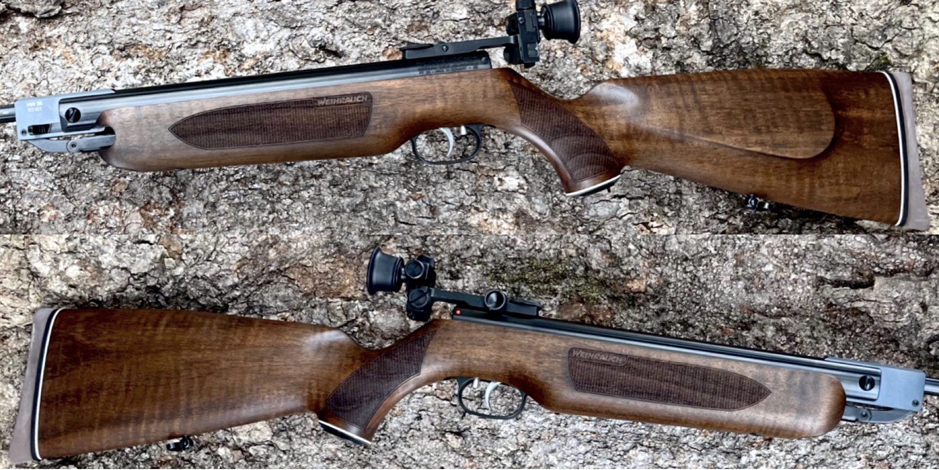

Love the sight, and WOW you definitely won the wood lottery! Stunning rifle.
