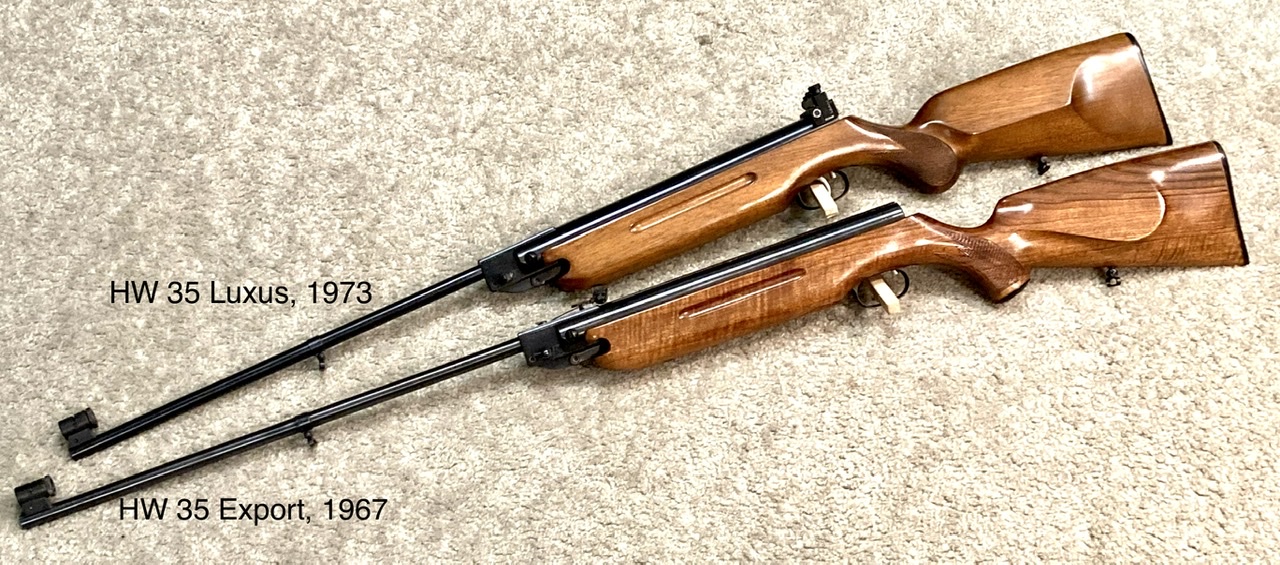

I've never had a 77, but the 35 is an old favorite. The attention to handling and balance on these older designs is obvious.
The traditional finger-groove stocks on the 35 balance right at the fore-aft center of the groove, with the standard 19" barrel and open sights. The fore end is as narrow as possible and rounded underneath, neatly masking the bulky receiver tube. If you slide your front fingers back to the rear of the groove when shooting, the gun has a pleasant, slightly muzzle-heavy "hang."
The balance of the "HW 35E" with the 22" barrel is much more front-biased - even that little bit of extra weight, when so far forward, makes a striking difference - but feels more neutral with a heavy diopter sight or scope.

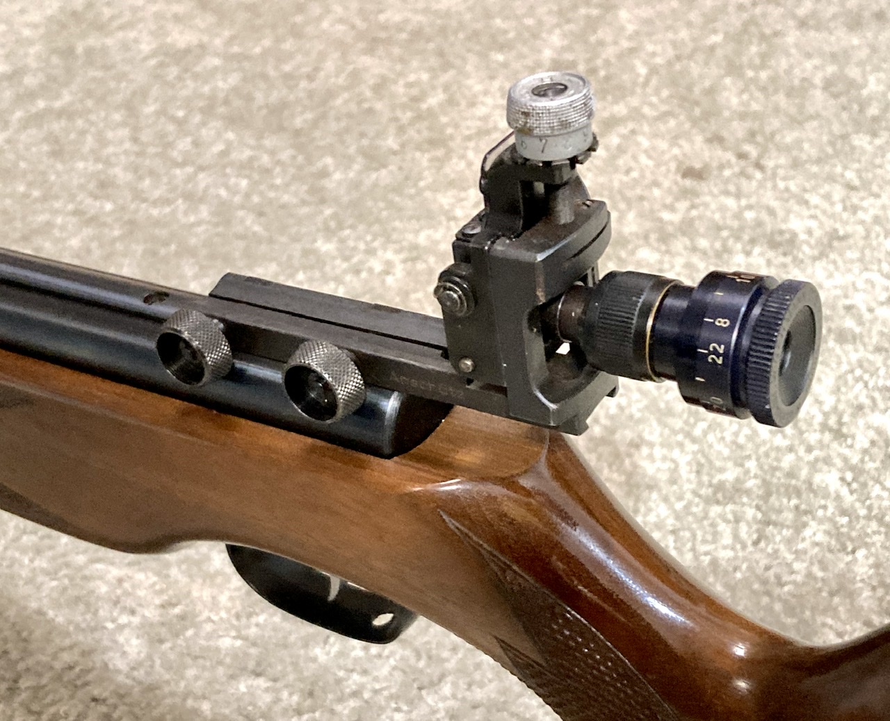

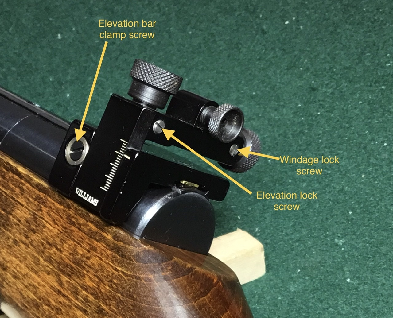

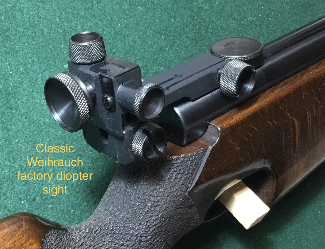

What peep sight do you recommend Thumper?
Please forgive the following bad imitation of Thumper! 😬
The Williams FP-AG series is the traditional choice for a hunting peep sight. They are small, light, and leave a good field of view around the target.
The 11 mm scope grooves on a new 35 will take either the traditional HW match diopter, or an older Anschutz one (which I rather prefer as they are lighter and smaller). For sporting use you will want some means to get a eye disk opening larger than the usual one (around 1.0 mm) used for target shooting though.
Williams:
Weihrauch:
Anschutz 6702 with Gehmann adjustable iris:
The "HW 35E" with the 22" barrel is much more front-biased - even that little bit of extra weight, when so far forward, makes a striking difference - but has a more neutral balance with a heavy diopter sight or scope.
The 11 mm scope grooves on a new 35 will take either the traditional HW match diopter, or an older Anschutz one (which I rather prefer as they are lighter and smaller). For sporting use you will want some means to get a bigger eye disk opening than the usual one (around 1.0 mm) used for target shooting though.
Williams:
Weihrauch:

Great information sir, thanks!
