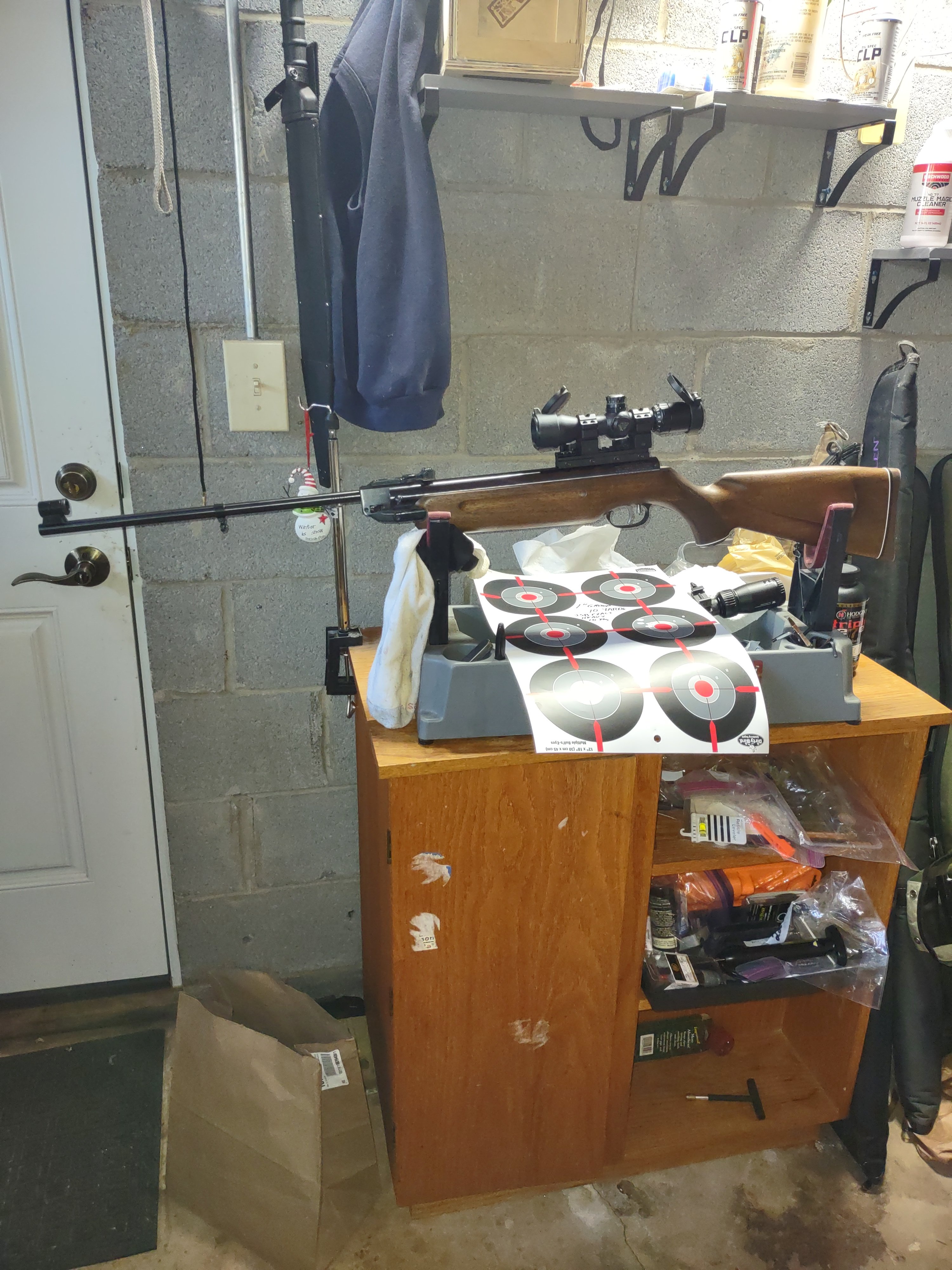

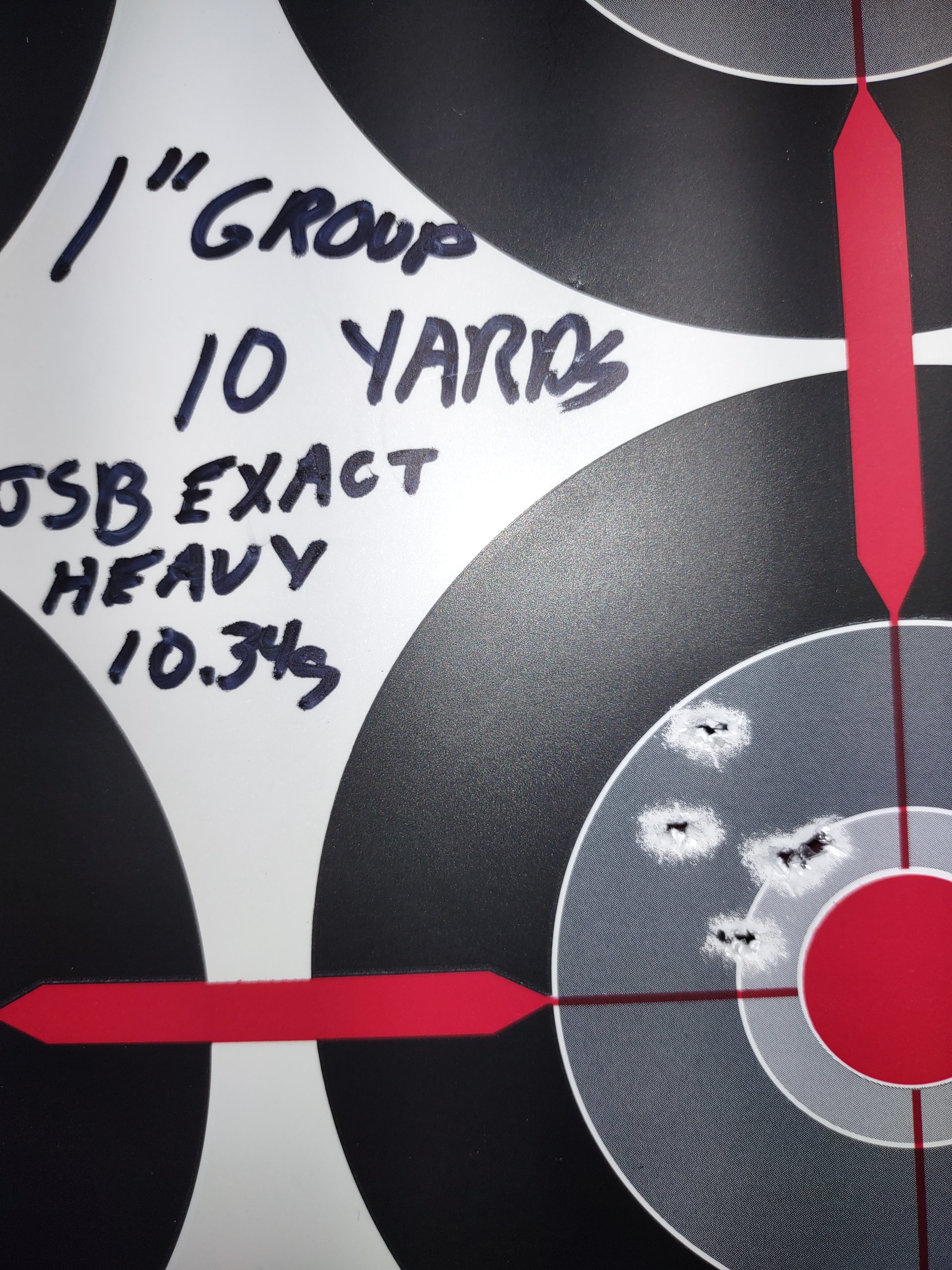

Below is 5 shot group with UTG bugbuster 3x12 set at mid range elevation and UTG Piccany droop mount ( I checked the mount screws and scope rings, all torqued down good and no movement. Do not have a scope to try on the dovetail but do not think the mount is the problem.). Gun had a vortex spring installed when purchased. Yardage was 10 yards with JSB Exact 10.34 gr. Got 1" group that was 5" low. I think, from some of the comments, the problem is I may have over-tightend the pivot bolt and bent the forks holding the barrel thus adding a little variability in the lockup. Is it possible to do that with a screwdriver? The forks are very thick. Maybe I destroyed the shims. I could not tell if they were even installed by shining a flashlight on them. Had to take the barrel off to verify. Maybe I should try new shims if you guys think that may be the problem If I bent the forks, I will need a new receiver, The big increase in barrel droop also probalby happened after the over- tightening. Was never this high when I shot it last year. The barrel droop problem happened after I did the over tightening I think. Still rattles but the chrony says notihng is wrong inside. Like I said, it shoot great with irons and the chrony says the power plant is working. Please advise. Thanks so much with sticking with me on this problem. Only thing I know to do now is drop it off and Airgunwerks and let David Slade look at it.
Wow! That is a huge group for 10 yards. The ES is decent, not great for 5 shots. Have you tried a different scope on the drooper mount. I hate drooper mounts, feels like a crutch.
Yes, tried 3 scopes. Wish that was it. Looks like $$$$$ unless anybody has something else to try. I got the breach seal coming and thinking about new shims.

Looking at the picture of the whole gun looks pretty stright in it . I kinda figured a noticable droop look.. seems a nice gun to me ..

9 fps in 5 shots aint so bad. id like better ( who dont? Lol) but I've seen far worse. Then that could be the pellets used. Id call it good . No big swing is key on that
That gun should shoot one ragged hole at 10 yards. Are the groups better with the irons? If they are I believe Ron is spot on. Think about it. The sights are mounted on the barrel and breech block in front of the pivot and on same plane like he said. In theory, you could bend the barrel down x inches and long as you can line the sights up it should still hit on target. But, if you’ve bent something in the pivot or introduced play and it’s not locking up consistently then your shots are going to scatter because the scope and barrel are aligned differently each time because the scope is mounted behind the pivot. If you can find new shims might as well try them and see. Cheap fix. If the forks are bent they could probably be straightened but well beyond my capabilities. If new shims didn’t work I’d take it in.

Iron sights shoot good. I intend to post a 5 shot group at 10 yards. I think you guys are right. My idiotic over tightening of the barrel pivot has added play and addtitional droop to the gun. I am ordering the shims and breech seal. I put a micrometer on it but could not detect any bending of the forks. However. when I wiggled the breach when closed, definite horizontal visible play, may 1/32-1/64" or less, between the forks. Barrel does seem to come back to original location but the change may be too small to see. However when I cocked the gun and left the barrel down, definite visible wobble, maybe twice the horizontal movement that I had with the breech closed. Maybe I damaged the shims so will try the new ones when they get here. After the breech seal and barrel shim replacement, I have no solutions. I am liking the clean lines without the scope. Going to see in good light what I can do at extended distances with iron sights and may not even repair it. However it bugs me. I paid over $700 for that tuned gun. Therefore may still go to Airgunwerks at least for an estimate and find out what the hell happened to my beloved gem. Wishing I had the Beemans warranty although they may not have not covered this repair.
