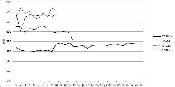

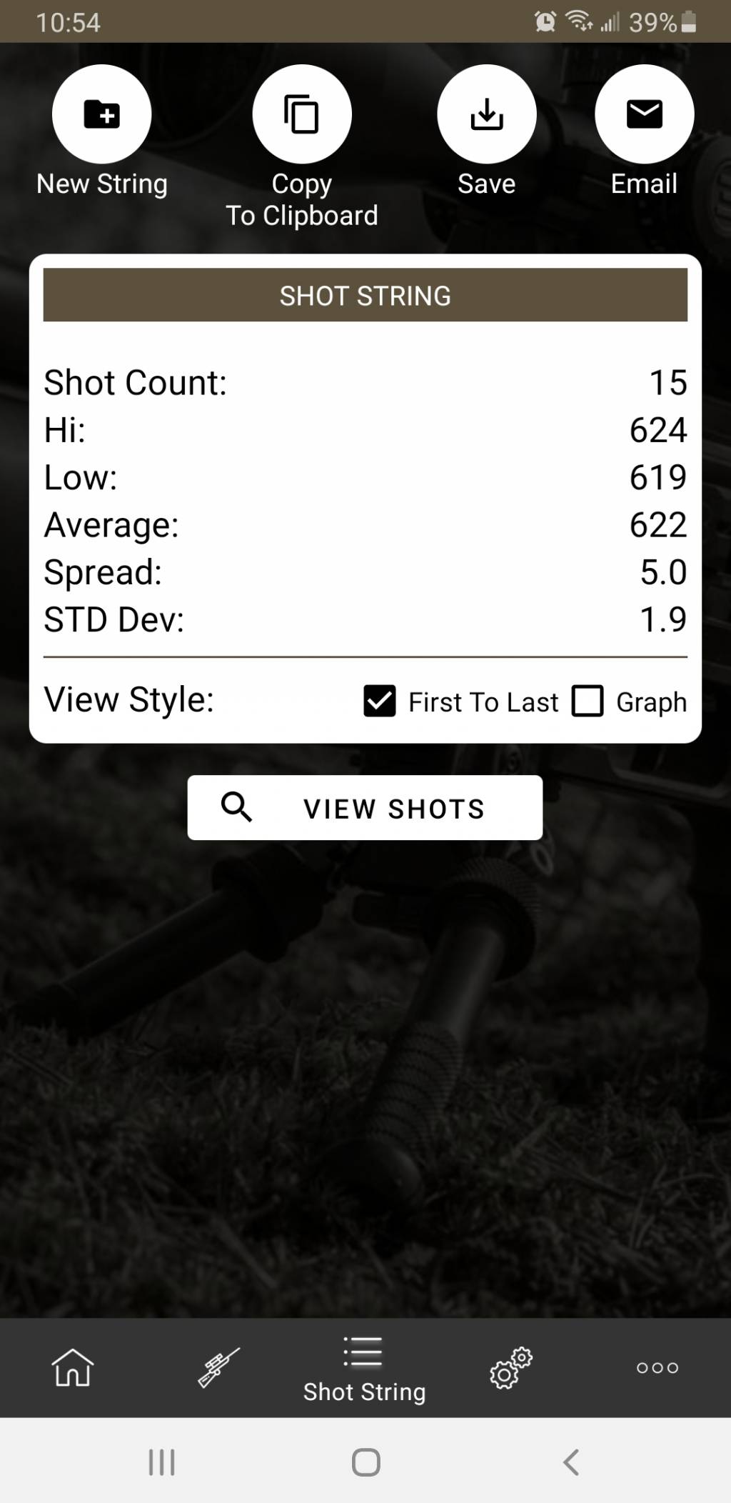

Received an HW35E in .22 cal few days back. Gathered up the new out of box chrono numbers on the pellets I keep around. Out of box, pivot bolt needed about 1/8th turn to tighten, forestock bolt the same and the bolts on trigger guard were pretty snug. First shot through sounded pretty smooth enough. Couple early shots gave a bit of buzz. Started with the AA 16gr and got an idea of how it sounded and then changed up pellets for a comparison. Each brand/weight pellet sounded just a bit different. Overall though there was a change toward the springer "doomp" sound. Seemed to quiet down as well. No aroma of gross dieseling, only occasional wafts when break open the breech. Chose the dot on post front sight and v-notch rear and can do alright at 20YD with some inchish-groups (FX 18s, AA 16s). At 25YD opens way up. My eyes won't let me do that too long, so tried a couple scopes, a Bugbustah and a springer-rated Optisan. Meh, accuracy wasn't really warranting that treatment so back to irons. Did get a Mynah at 25YD using the fat front post, and will take that as a lucky shot.

What was length of run-in for your new, not tuned, HW35Es? Number pellets?
What are the long term consequences of shooting the heavier 18.1gr pellets versus a 14-16gr pellet? (recent post)

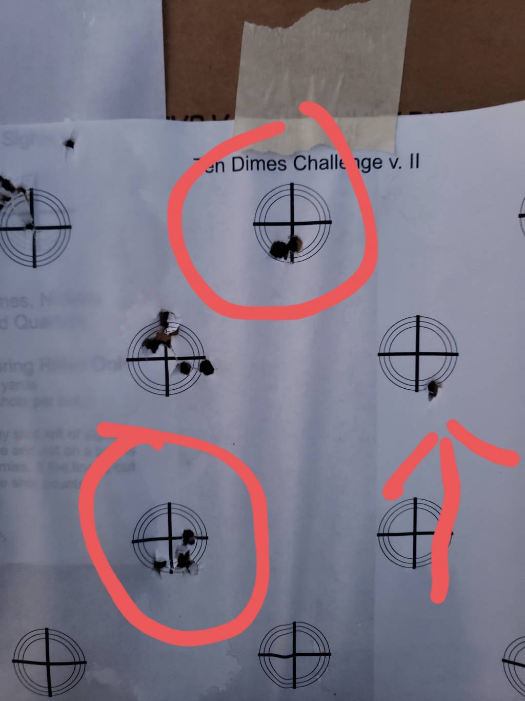

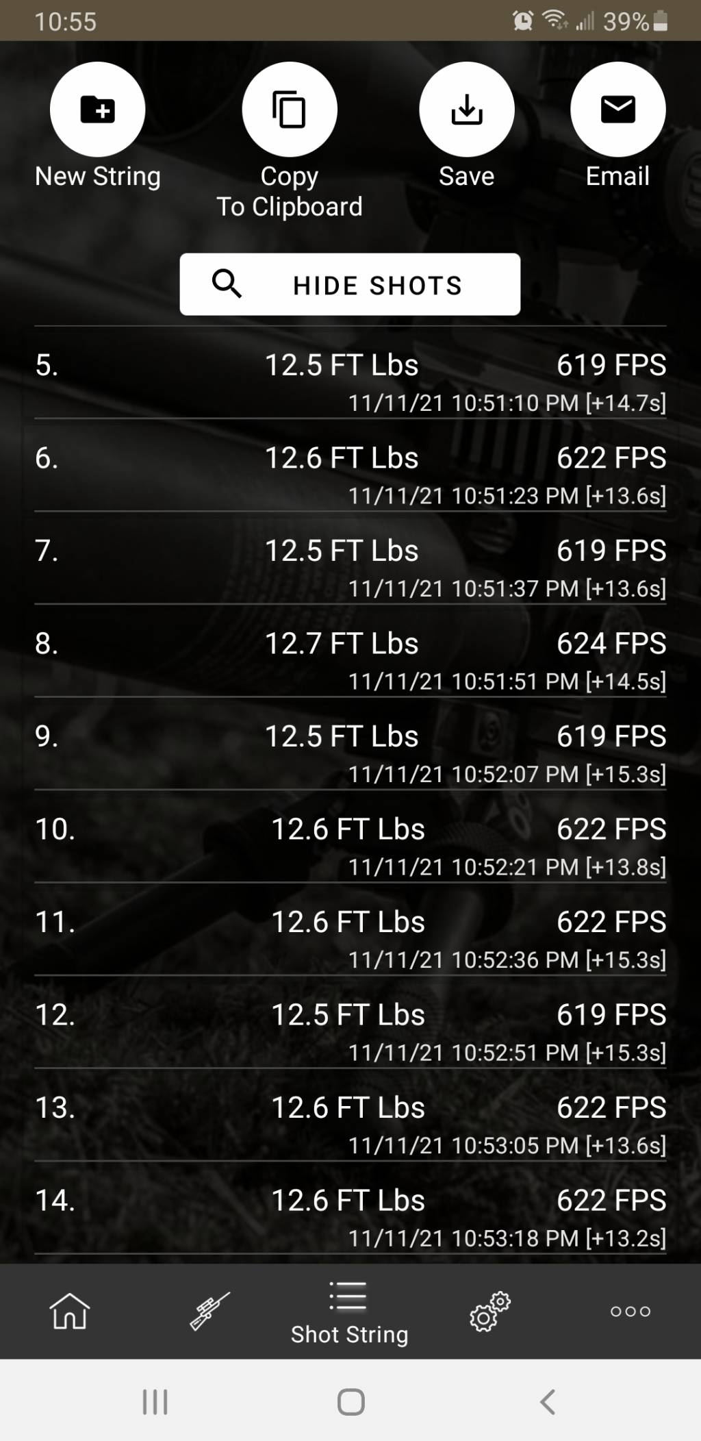

I got mine in last week too and pretty much immediately took it apart because it wouldn't group to save it's life and my chrono numbers looked pretty similar. The spring ends were pretty badly done and the cut out it the tube had a pretty nasty bur that was marking the heck out of piston. After giving everything a good polish, bore pasting the barrel, and re-lubing she has become a tack driver. I have about 500 shots through mine now.
This was with 14.66gr FTTs (5.54 head size)
GROUPS BEFORE CLEAN AND POLISH:
GROUPS AFTER (SORRY ONLY PIC I HAVE AT THE MOMENT)
These are all 5 shot groups at 35 yards with 5.54 FTTs. The top group was my first group and I thought I was missing the target so took that sighter to the right. To my surprise, the gun was officially putting pellets on top of each other. The real kicker is that the recoil impulse has changed drastically. Prior to my little "tune" the gun had a habit of kicking up and right when fired. Now it's on a dead forward and back line. This gun is quickly becoming my favorite now.

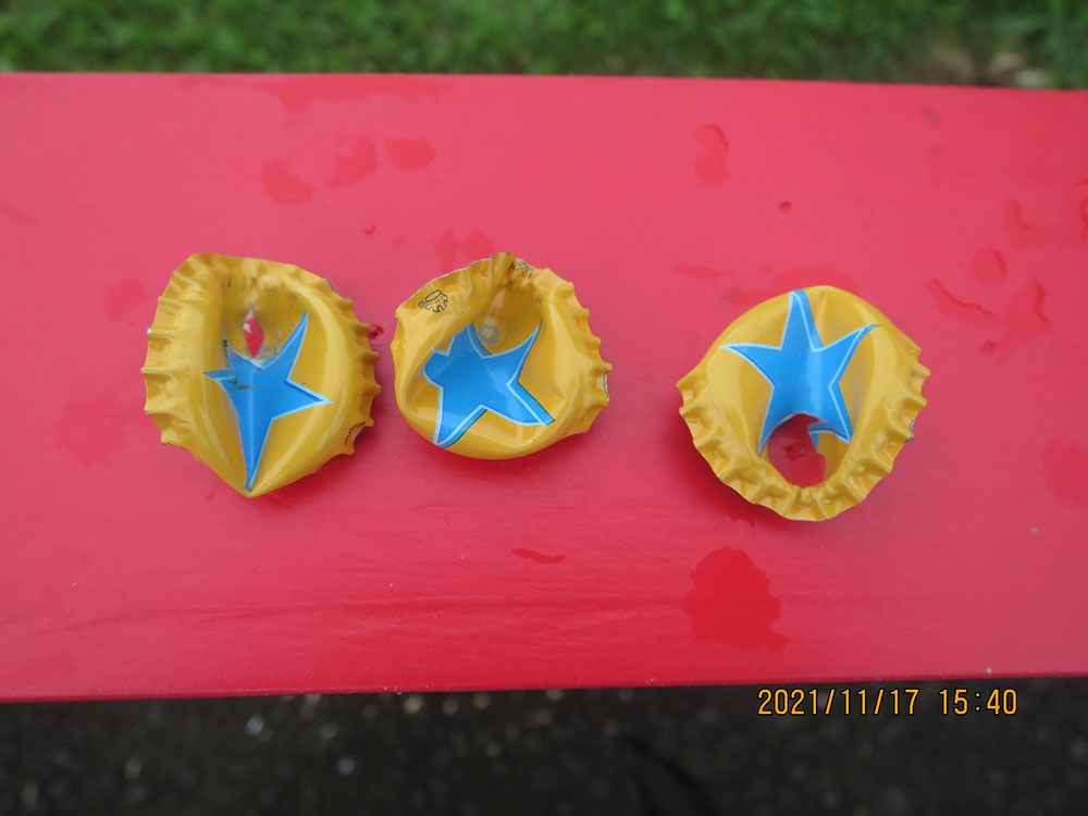

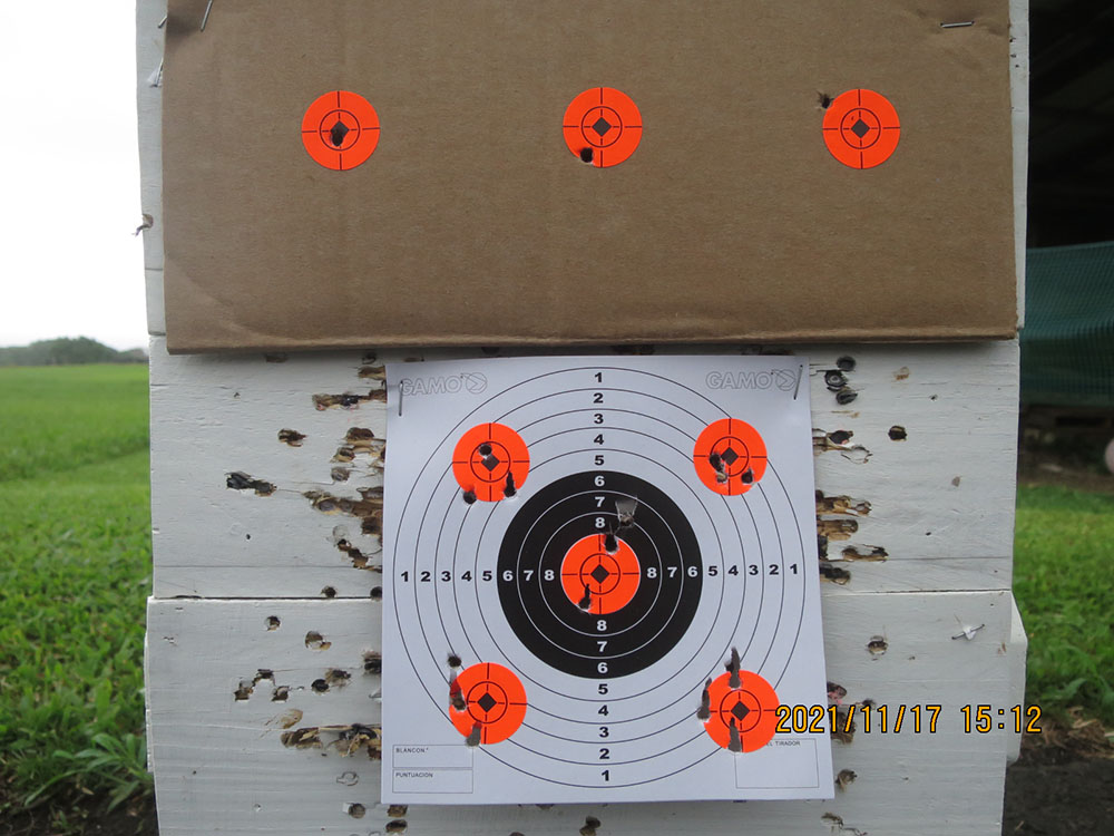

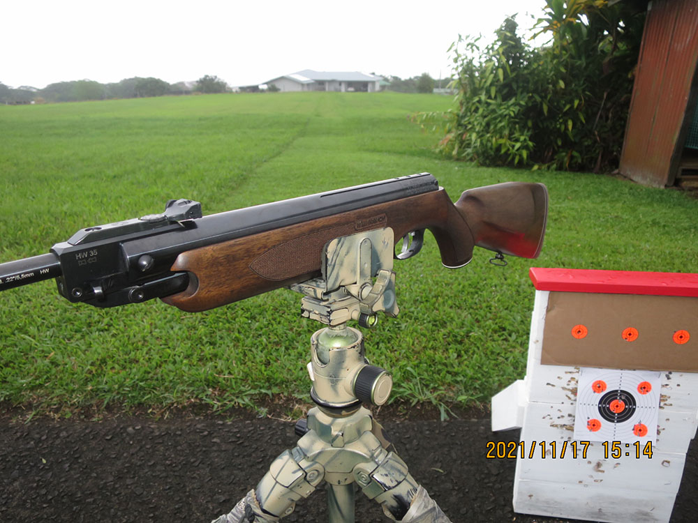

Caught a brief round with the 35 at 16YD. Sighters at top row and 3 each to the 1" target dots. Definitely gonna have to scope this rifle, but hey I shot bottle caps at 20YD with...much trepidation. All one shot hits, but yeah eyesight not what used to be. Shot over a rolled up towel for a rest.
I don't feel like I have any issues with my hold on this rifle, am not a death grip shooter, not a free recoiler, just somewhere in between. Been a while since shot open sights, so practice still in order.

I will circle back around to the FTTs on your recommend. What I have are 5.54s and was getting 638FPS, but the fit in the breech was crazy tight. Hunter Extremes and the 'cuda Match didn't group so great. Not averse to stacking HN tins if the pellet is good.
