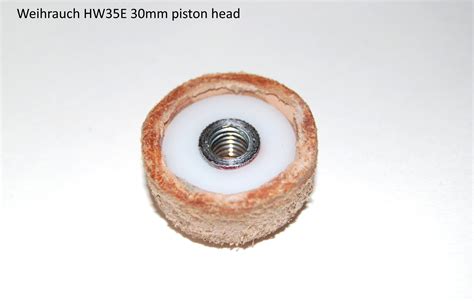

Nothing Wrong with an undamaged leather seal. I have seen reports of upgraded guns seeing improved performance by going back to a properly treated leather seal. Perhaps the loss of stroke from the seal adapter is detrimental?
I've recently been working on a 1980 Beeman-import HW 35 with a leather seal. The piston is slightly longer than the plastic-sealed piston which replaced these about 1983 (i.e., = shorter stroke). As rokonman notes, the leather-to-plastic conversion sets for these make the piston longer still, and are heavy to boot.

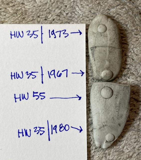

Another oddity in these old 35's is the transfer port size. In current plastic-sealed HW's, the port is about 3mm. On old leather-seaed 35's the port was 4mm, BUT seems to have changed to 3mm after Germany's "pentagon F" power-restriction law that went into effect in 1970, while smaller leather-sealed HW's of those years stayed at 4mm. There are probably other factors involved, but I've had much trouble getting good power out of my 1980 3mm one.

Leather-sealed HW 35's used two different details for attaching to the piston. The oldest ones have a fixed threaded stud on the piston, while later ones use a separate screw that passes through the seal's center plug. The Punctum seal is for the earlier type, I think the Gunafrica seals are the later one.
It's possible the two types have some interchangeability, but I don't know.
I believe that the seals are same same between the two affixing methods mentioned above, but the filler piece is different between the two variants. One accommodates a simple screw, while the other accommodates a wider slotted nut to affix the seal. This is just supposition based on looking at both seals and assorted bits.
I really like the replacement leather seal assemblies from TW Chambers as they are the closest to the OEM set up on the models with the screw affixed seal IMO.
Mike, I have a 1980 model (serial 784069) with an older Vortek HW35-PG2-12 Tune Kit and piston seal adapter. It's getting 10.5fpe with JSB Exact Express 7.87gr pellets.
I have a Beeman import 1980 model serial number 804123 and as near as i can tell it has a 3mm port. The leather seal assembly is bad and I have not found a supplier for the Assembly. Would like to keep it leather but may have go with the newer plastic version.
If its 3mm a 1/8" drill bit won't fit in the port. If it fits in there it's 4mm. Its important to know what you have
