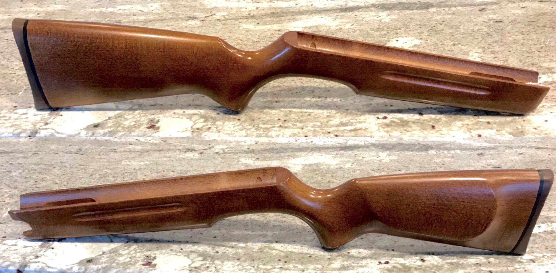

I like the Finger grooves much better.....
Me too!
Some don't like the look of this traditionally German detail, but I love 'em, and more thought went into this simple detail than you might think.
I have kinda dinky hands, and appreciate the secure feeling of my fingers "sinking in" to the stock a bit. And the grooves were carefully located so that their mid-point is near the balance point of the gun (with iron sights, that is...all bets are off with a bulky scope). This makes for stress-free carrying, is a good reference point for a consistent hold, and sliding your fingers to the rear of the groove when shouldering the rifle gives just the right slighly muzzle-heavy "hang."
