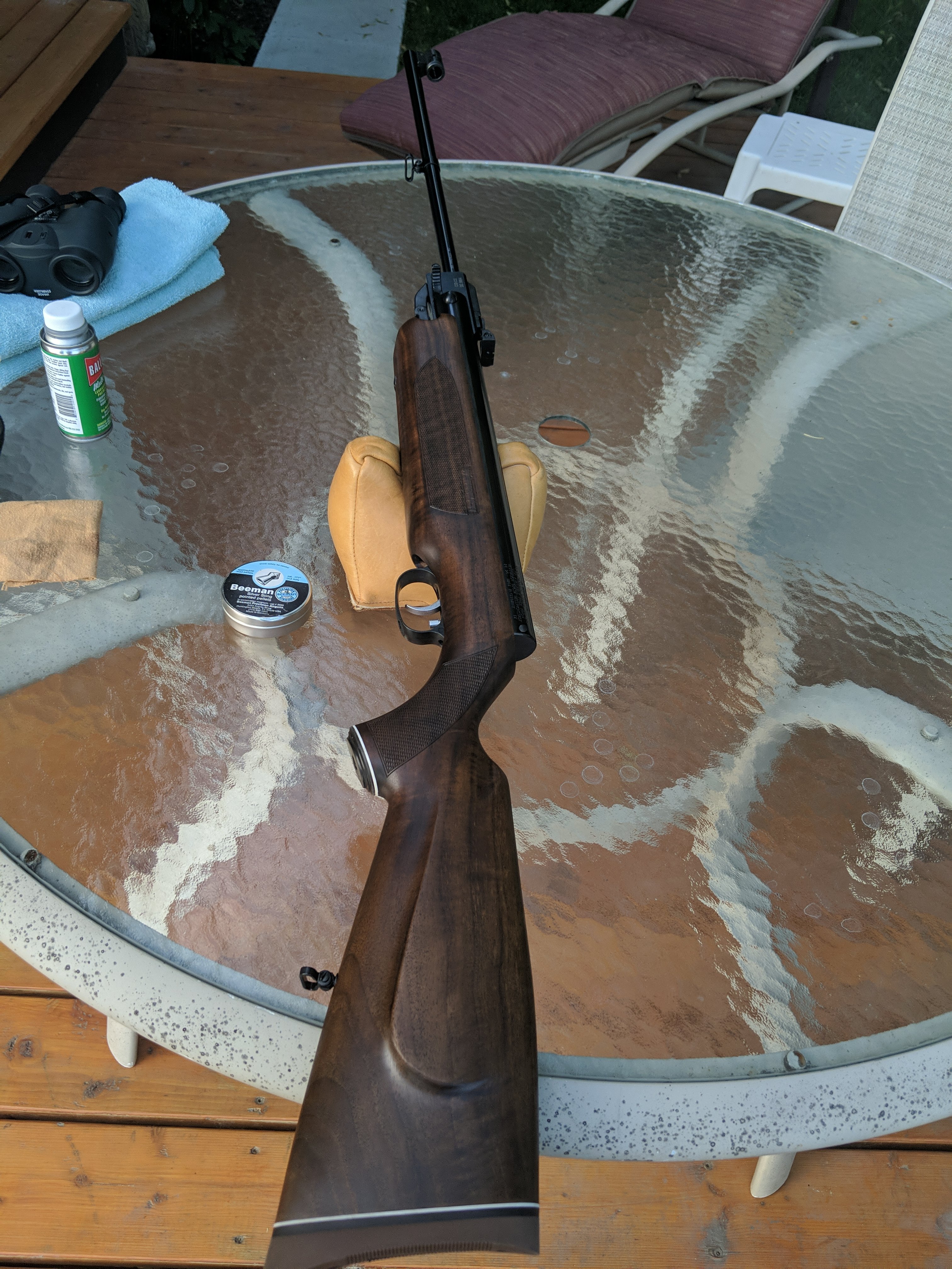

Well, it’s very clear this gun was not New in box. The stock has a lot of wear to it in a few ding marks. The bluing is not perfect in the front sight has been butchered. It shoots very clean, and the trigger is awesome. There’s no clanking or twang in the shot cycle, so I offered him $150. I am now the proud owner of a HW 35

It’s not that old in that box and with a safety button. Plus that rear sight is the new model. Definitely not a leather seal.
