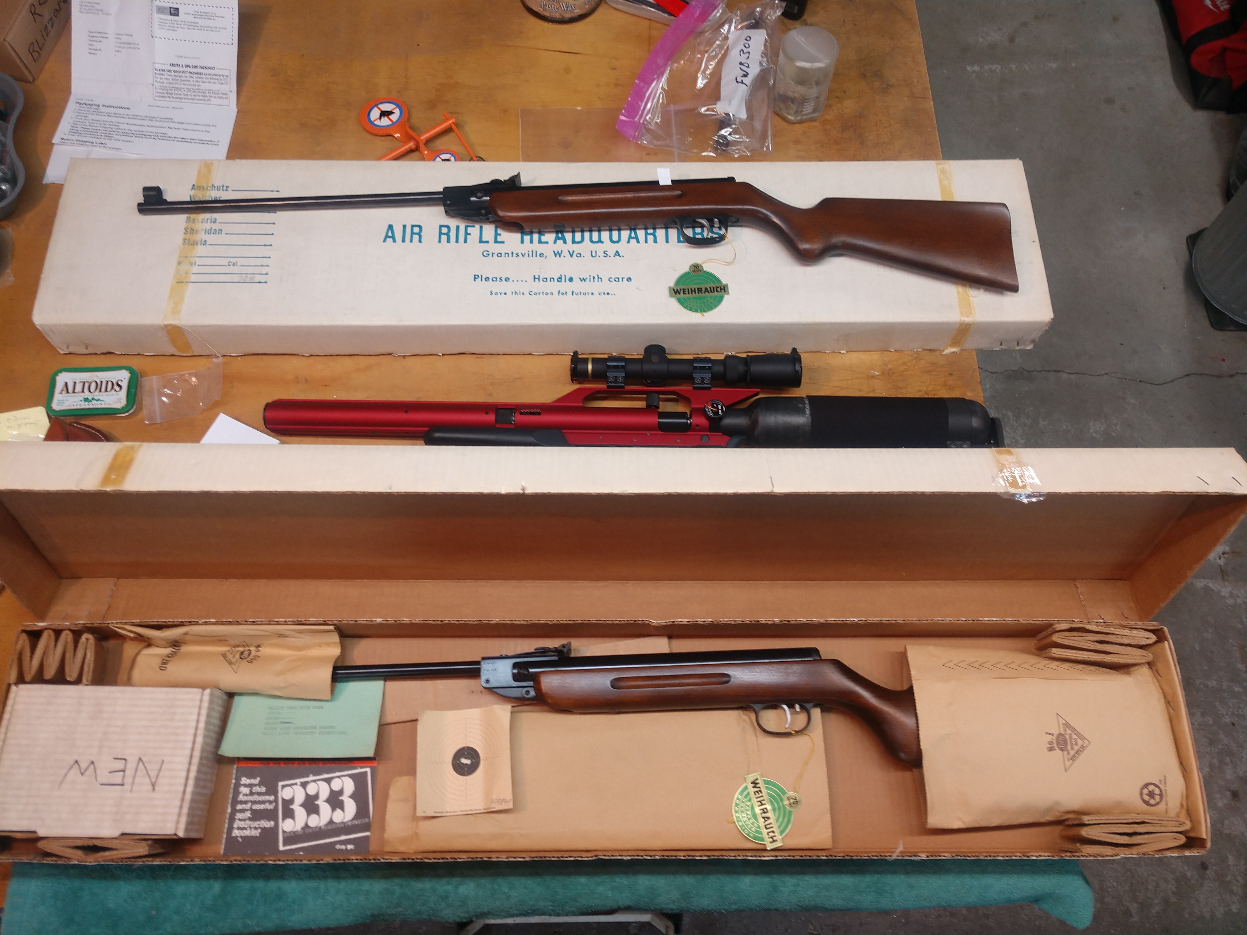

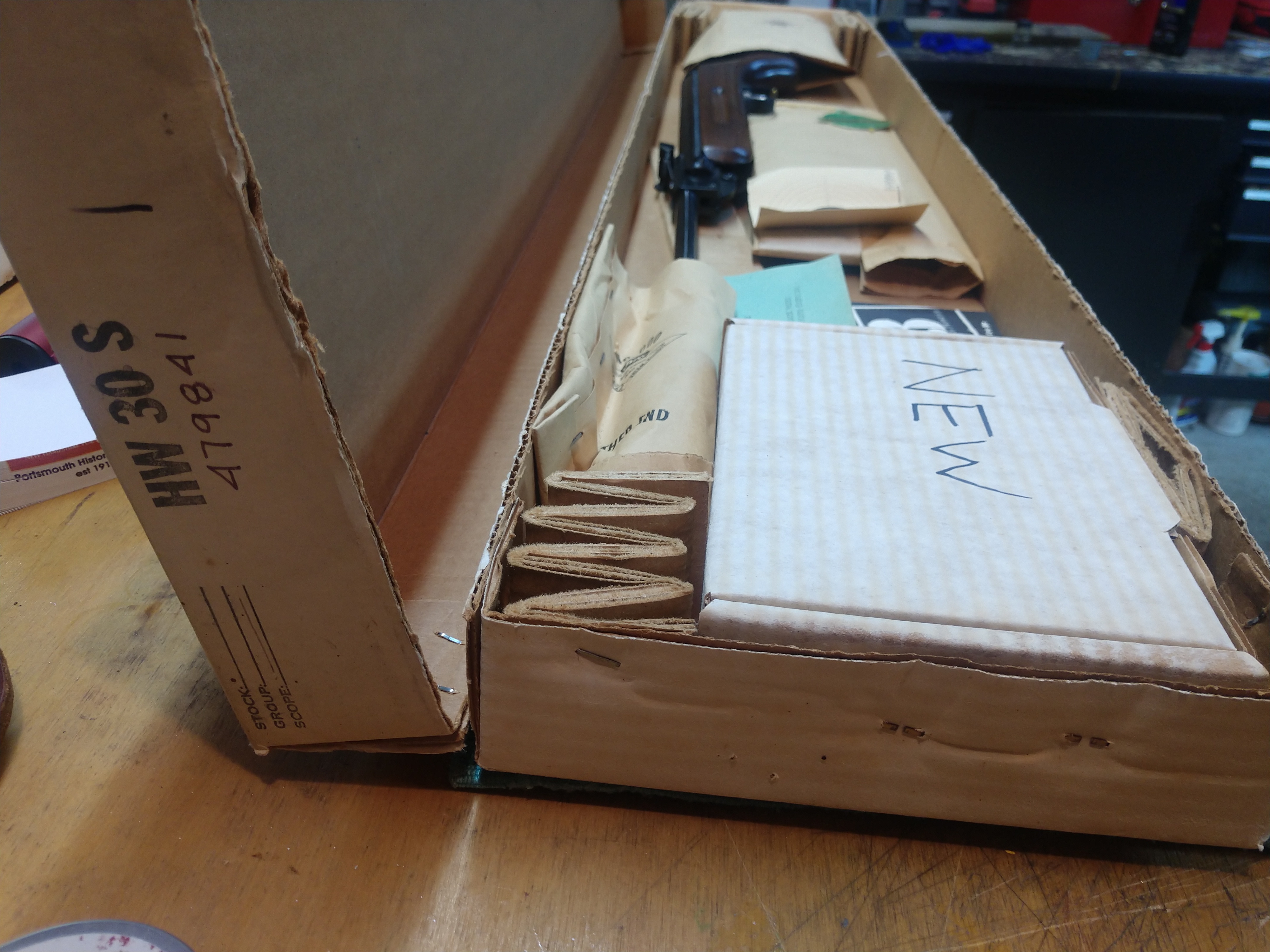

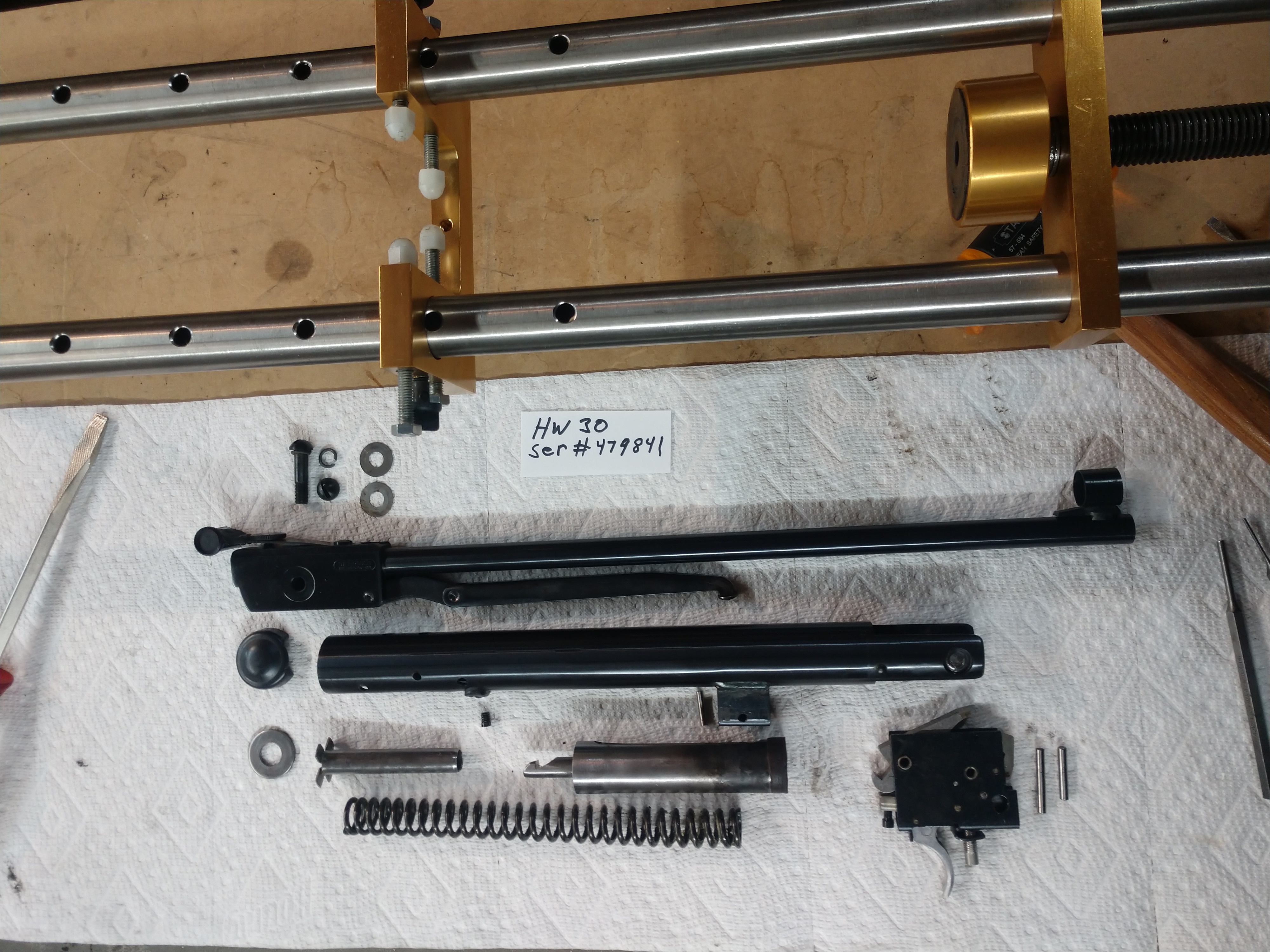

I bought these 2 HW30S rifles recently. Both were NOS (new old stock). Problem was i was told they weren't shootable in their original state. This was due to dried leather seals and gummed up lubes from 50+ years of sitting unused.
So, I brought them to Airguntunes.com in New Hampshire. Scott Blair is the fine craftsman who delicately disassembled both guns and brought them back to life.

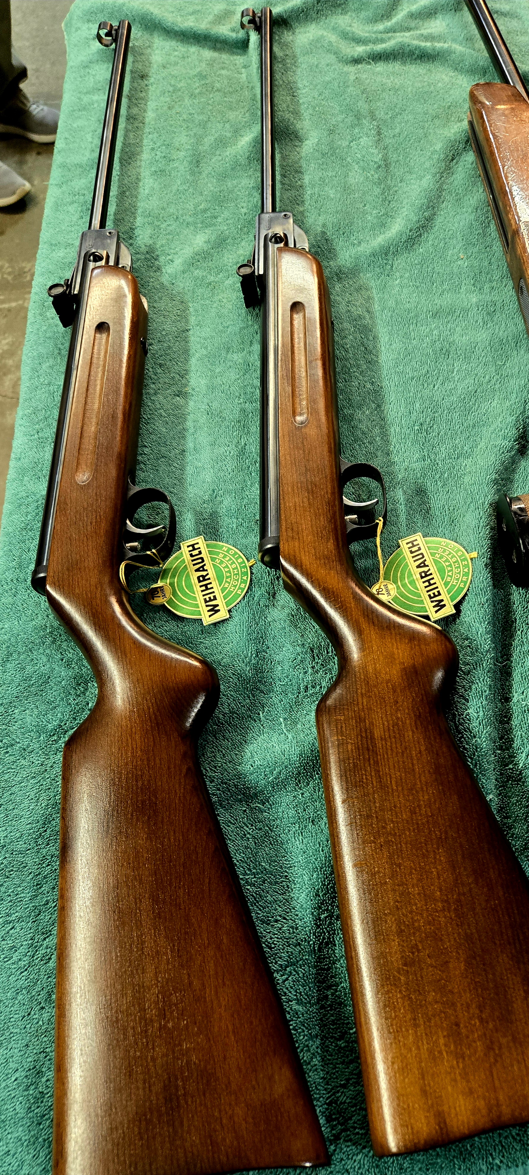

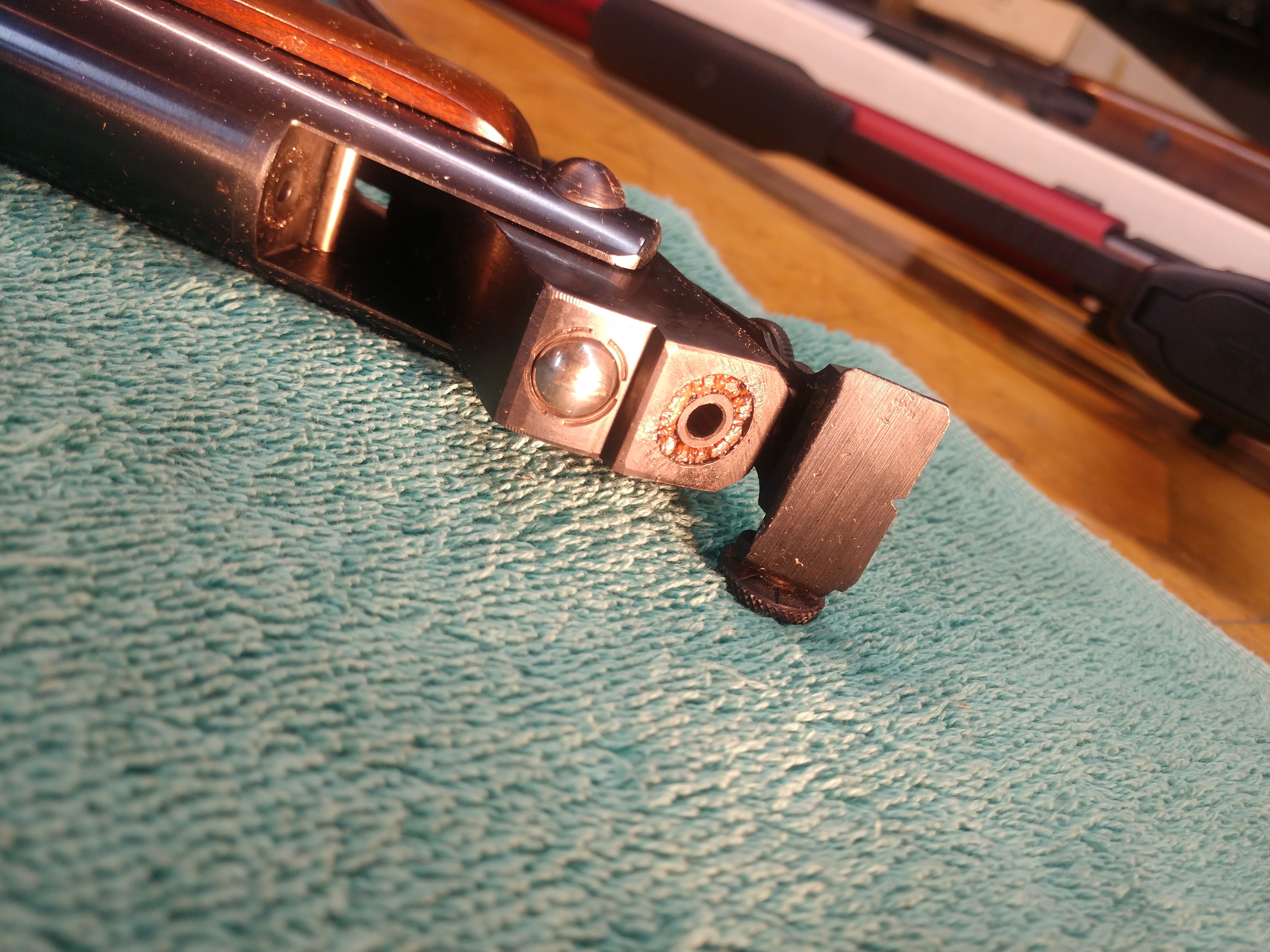

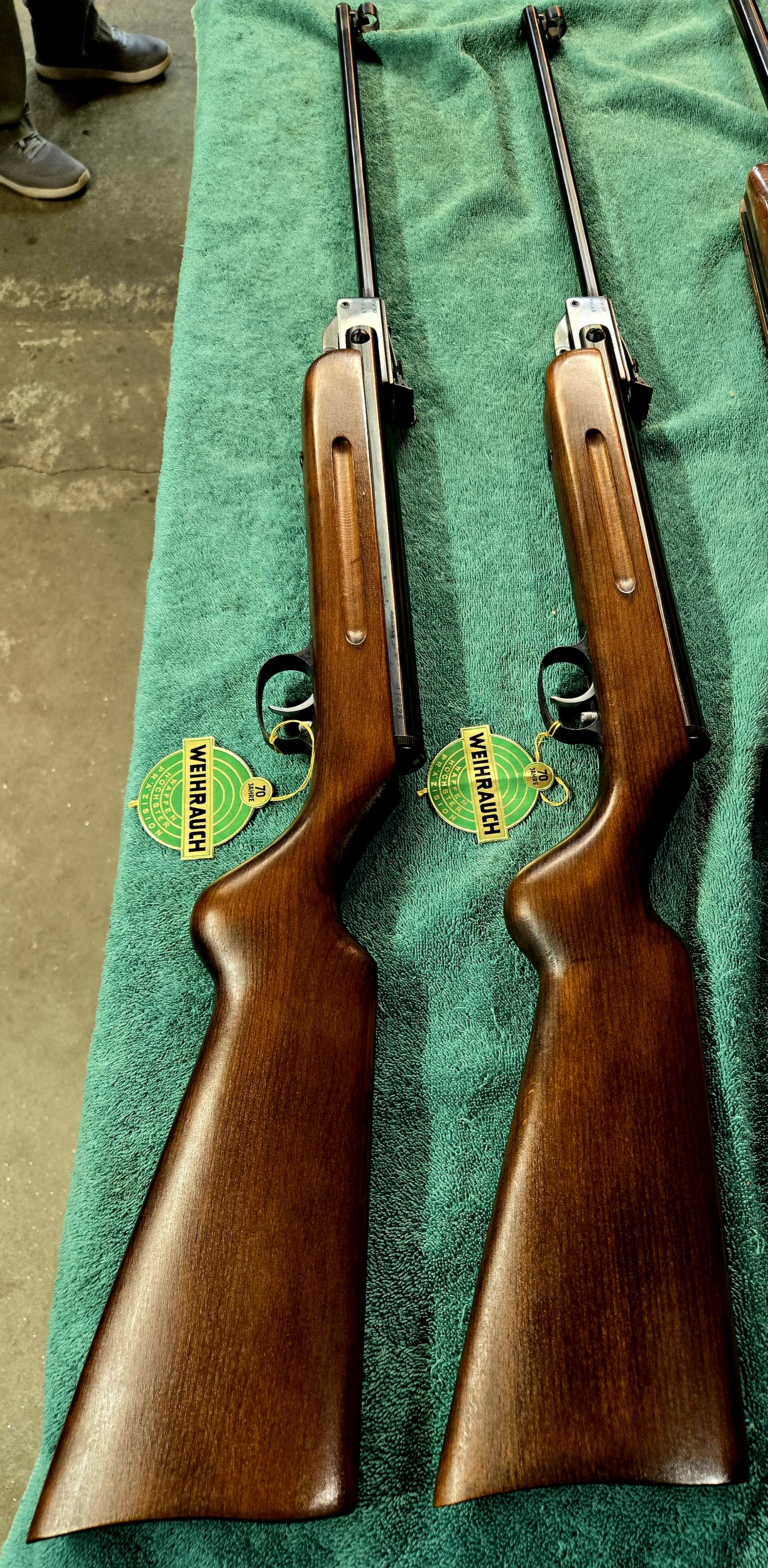

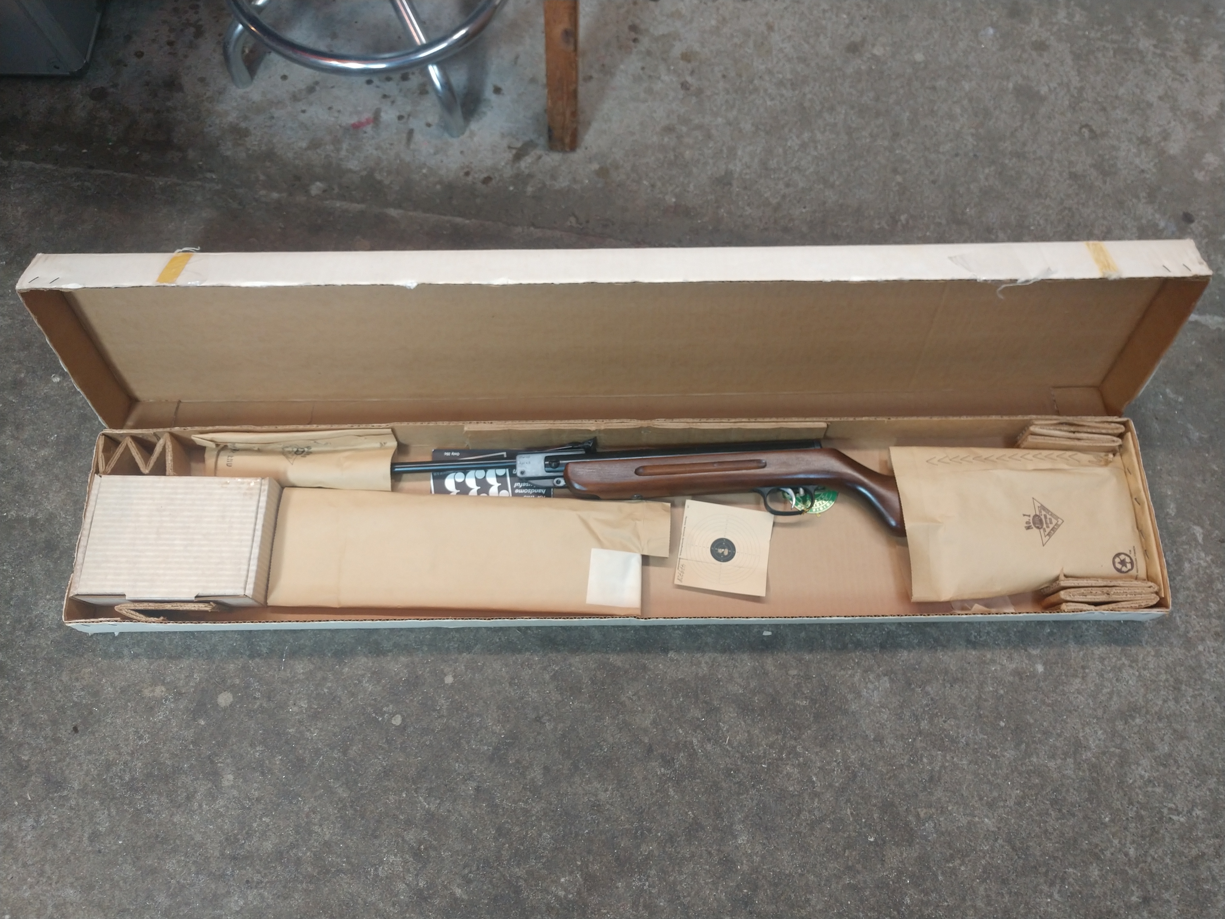

Scott is a fine craftsman and is renowned for his perfection when working on airguns. He delicately disassembled both rifles, cleaned, polished, and lubed them. He also managed to save the leather piston seal by soaking it. Unfortunately, the breech seals were beyond help, and for lack of new leather ones, they were replaced with JM synthetic seals.The rifles were then reassembled with great care and put back in the original 50+ year old ARH boxes.
Scott test fired them, and they are shooting beautifully!! It was a real treat to see these old rifles come back to life. He made a spread sheet detailing all the work and results. Great information to have one these "time capsules".
Here are a few pictures of the process for your perusal.
Enjoy!
Enjoy!

Can be slightly more than later guns because the pre safety guns have a little longer stroke.
Sometimes you can still use leather breech seals by cleaning up the end and shimming them out for nostalgia's sake but a new Weirdrock seal is probably better anyway.

To me the "new-fangled" breech seal is not a knock at all. The odd shape of Weihrauch's seal is because it was expressly designed to be a drop-in replacement for the old leather ones, which are an inherently perishable part of any barrel-cocking springer, after all. You wouldn't expect to pay any less for a vintage Ferrari because it didn't have the original air and oil filters! :D
