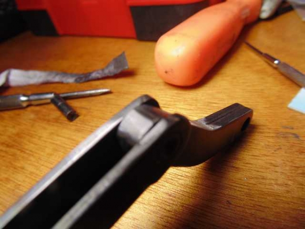

Mine was binding badly and there was no room for an insert when I got it. It even interfered with barrel lockup. Here are some pics that I took of it a few years ago when I got it. The problem was due to the cross pin (seen on left side of 6th photo) being positioned too high so the cocking lever would not slide without binding, even when disconnected from the barrel. The knuckle on the shorter part of the lever assembly also needed some relief.
