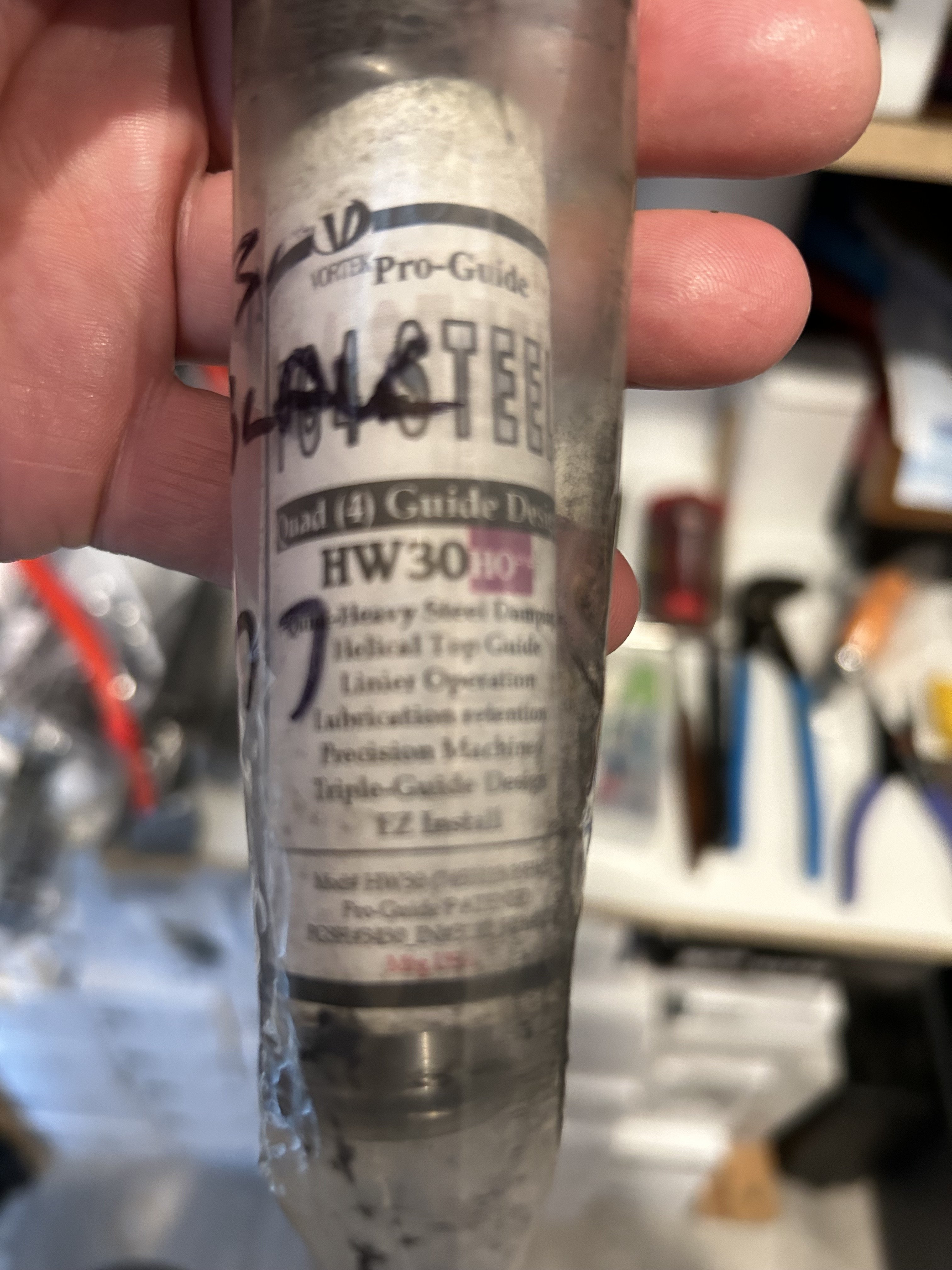

This is the kit. I received my piston seals after this install. Will replace this season.
This gun sat on the side lines for ever, occasionally taking a stab at it. Crow
This is the kit. I received my piston seals after this install. Will replace this season.View attachment 410830This gun sat on the side lines for ever, occasionally taking a stab at it. Crow

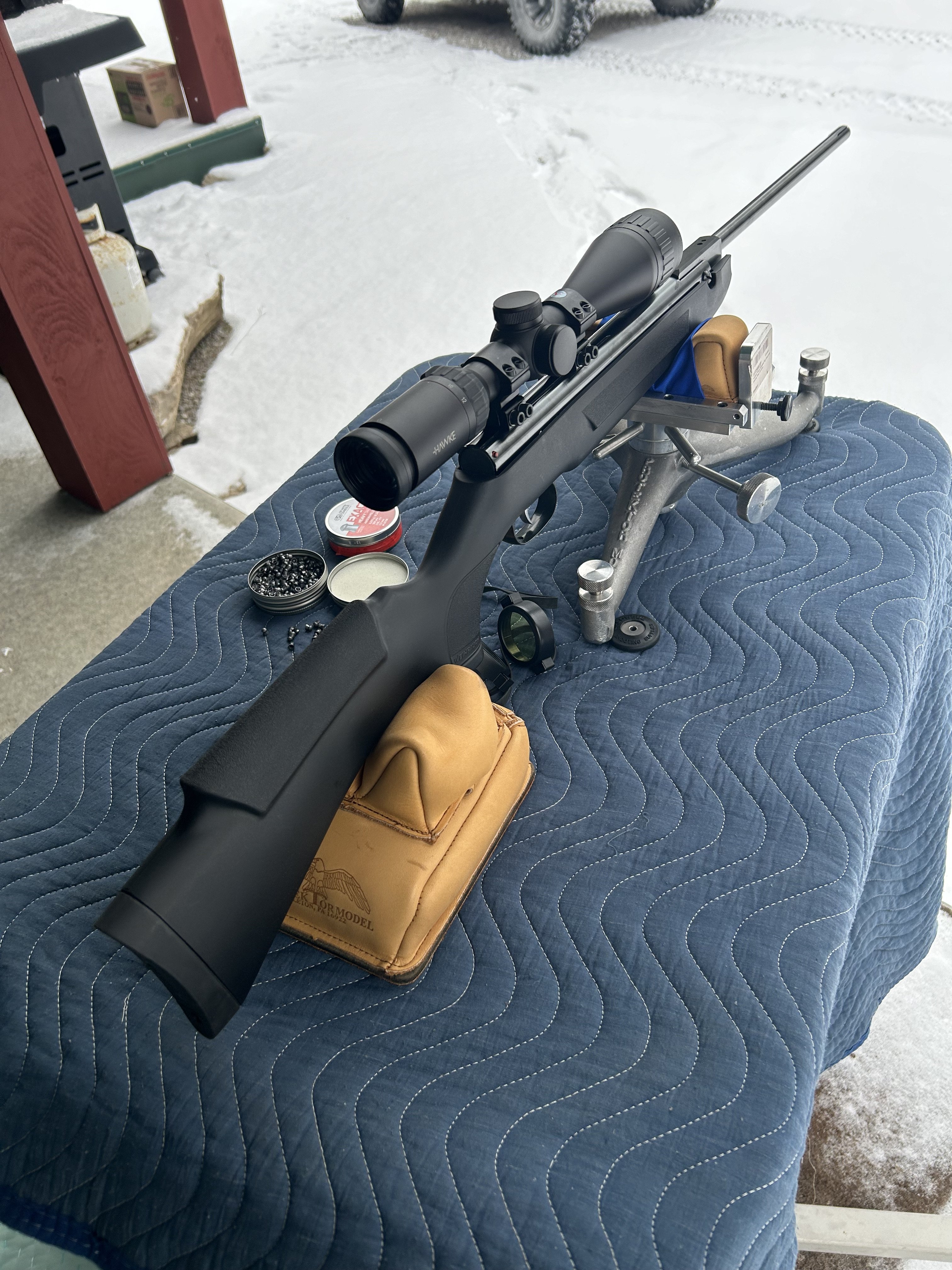

I was going to jump on to tonite. Couldn’t wait. Wood shop has to wait. Put a washer inside stock of front trigger screw. Pulled the screw from bottoming out. The gun jacks nicely.
Took a scope off the shelf, installed, went out and shot. Thanks to the snow I could easily see how much I was out, missing the target completely. Turns out to be another fantastic 30 and an excellent candidate for a custom stock.
‘Thanks again for all the input. Dream Team. Crow
