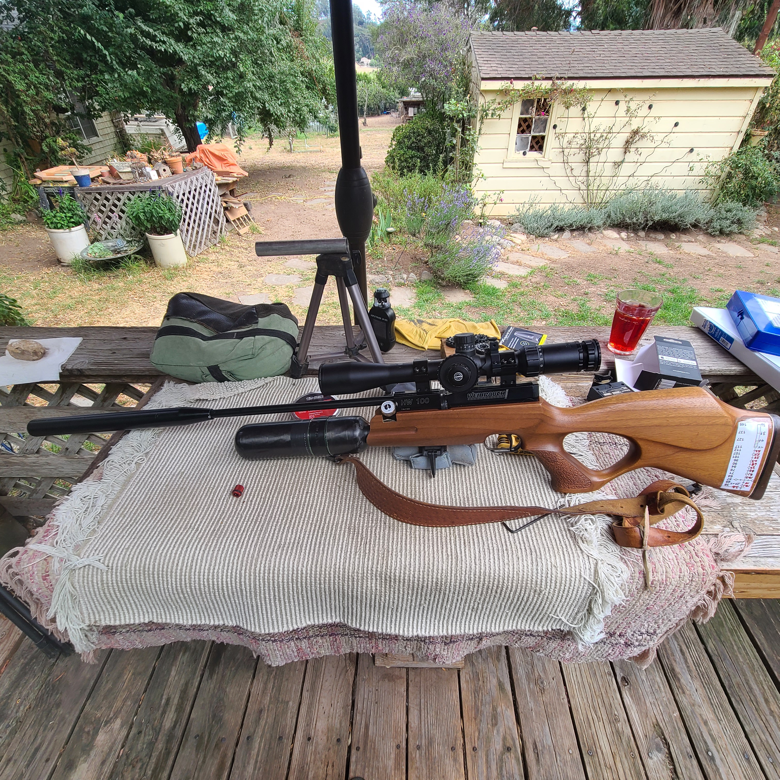

I have an HW100 .22 Carbine and am doing some research on AGN before I start on a small project (after the Holidays ) to get an ideal tune for my gun. I'm actually doing this with some 'heavy lifting' Tuning assistance from a good friend and colleague, who is also an HW100 .177 owner.
Background: My gun has been sent to Air Venturi twice in the last year, to try and resolve a loud 'popping' noise when I fire pellets through it. AV has replaced the breech seal, valve seal and completely resealed all other o-rings in my gun earlier this year, but at the current velocity ( 850 FPS for the JSB 18.1 G), I am still getting this loud popping noise. I don't believe the gun is leaking and I think the seals are now all OK, in light of the above. I have tried different moderators, and still get a loud pop when I shoot. Our mutual belief is that I am shooting the 18.1g pellet too fast, and need to slow it down in conjunction with getting the correct set point with the desired velocity for the desired pellet(s). I realize after speaking to my friend, that this gun was originally built for 12 FPE in Europe and I wonder if I have the velocity too high for the 18.1 pellet. We both think this 'could' potentially be the issue for causing the loud pop for each shot. i.e., velocity too high, pressure too high causing a louder report.

850 FPS was the Chrono string I requested from AV for the 18.1 pellet. I think that might be a bit fast, but as I mentioned, we have a tuning project coming up after the Holiday.

Yeah, 850 FPS for the 18.1 is too fast. My friend Ed told me same, but you gave me the input I wanted with yours shooting that pellet at 820 FPS, reg set point = 120 BAR. We are going to tune the gun for a lower velocity ( I.e., 820 FPS range ) and I was looking for some real world experience before we started.
FYI - I get about 2 mags of shots or approximately 28 shots before it reaches the 120 BAR-yellow area on the gauge.
I just read the Users manual and it does not list barrel length. I suspect it is 410mm and has the original HW cylinder with that model. As it turns out, I looked at a YT tuning video, and it appears that the fill valve o-ring in the air cylinder might be leaking. I took the cylinder off, filled to 200 BAR and it was at 130 BAR the next morning. So, the air cylinder has a leak.

Update on leak….
I think I fixed the air cylinder leak by replacing fill valve o-ring, with great assistance from a YT video and my buddy Ed ( elh). It has been holding air at 200 BAR max fill for 2 days. Heading to the range tomorrow or Friday to test and play with HST, shooting the JSB 18.1 at lower velocity.
