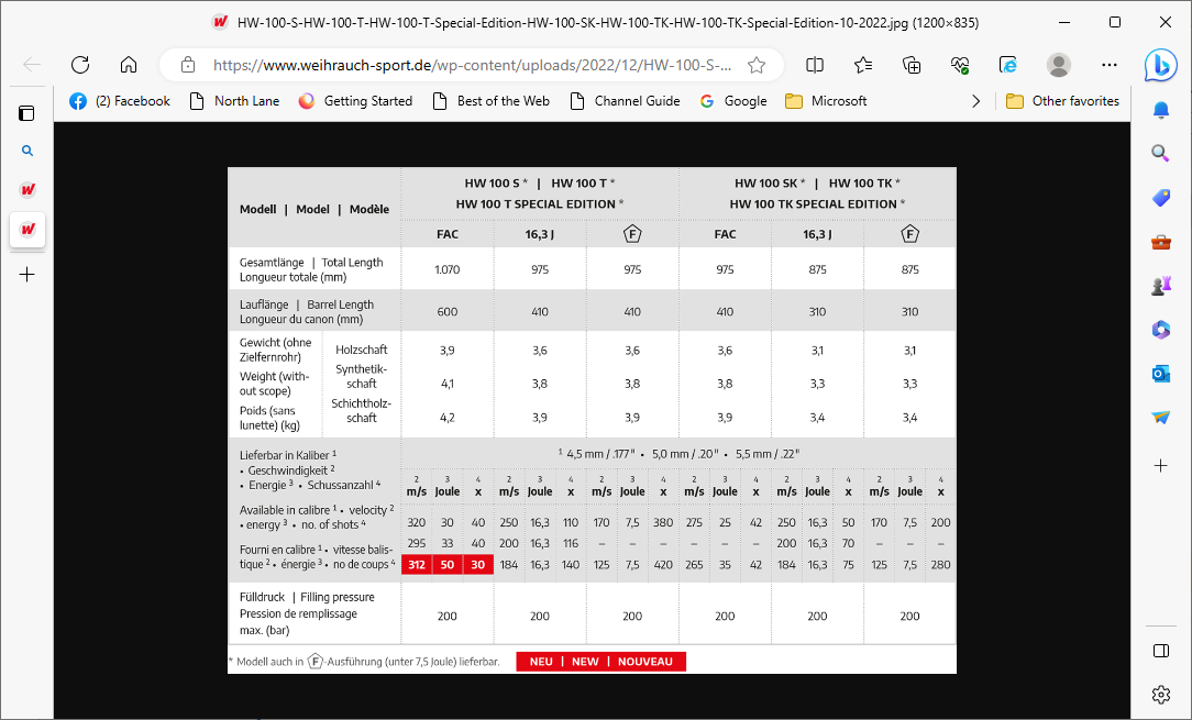

I just received a new HW100 Thumbhole PCP .22 cal with the 50 Joule rating. According to HW site, the 50 Joule should net about 30 shots, at least according to their updated chart.
I'm currently seeing about 14 shots before the Manometer is hitting yellow. I'm filling it to 200 bar according to both my Air Venturi ROV Air compressor as well as the Mano on the HW. I also have a new HW100 KT Laminate that is shooting about 36 shots before hitting the yellow. Both are using JSB Jumbos 15.89 GR pellets. The HW100 T was chrono'd by AOA using the same pellets at just under 34ft lbs. AOA is suggesting the regulator needs adjusting to get the shot count up. Before I send my new gun back to AOA for recalibration, I wanted to see if anyone else has the HW100 full size .22 cal and what you are seeing. I am planning on chrono graphing the rifle this evening to get better data.
