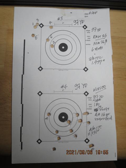

HW100 SK .22 - 100 YD with the Air Arms 16 gr Fields
Actually 97 YD lased to target. Shot off a tripod, and I do not have the best of shooting form.
Got really good results yesterday in the 20-50YD ranges hittin spinners. Got an average 849FPS (SD 3.55, ES 13, median 848, n=26) over the chronograph. First bout of target and chrono work is found in a post I made couple weeks ago.

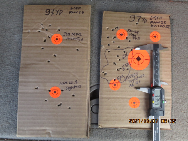

A measured CTC of 2.8". That's pretty good. Is that pretty good? Gave a 5MIL hold. Chairgun spit out a table with a 5.48 dot hold over at 100YD, so that dope is good nuf for now. Have mounted an Optisan CP 3-12X32 MH-10 SFP set at 10X.
This HW100 was shooting right up there with a RAW .25 and NSA 26.8gr'ers. Don't know how I should feel about that.
Below are the sighter cards I shot prior to shooting for record. What is throwing me off are the JSB Hvy mkIIs I sent through the RAW, which I can usually get to group <= 2 inches, and kinda soured my attitude for the rest of the shoot. Anyway, with the HW100 had no expectations, but was pleasantly surprised it did this well. Thank you for the reassurance.
