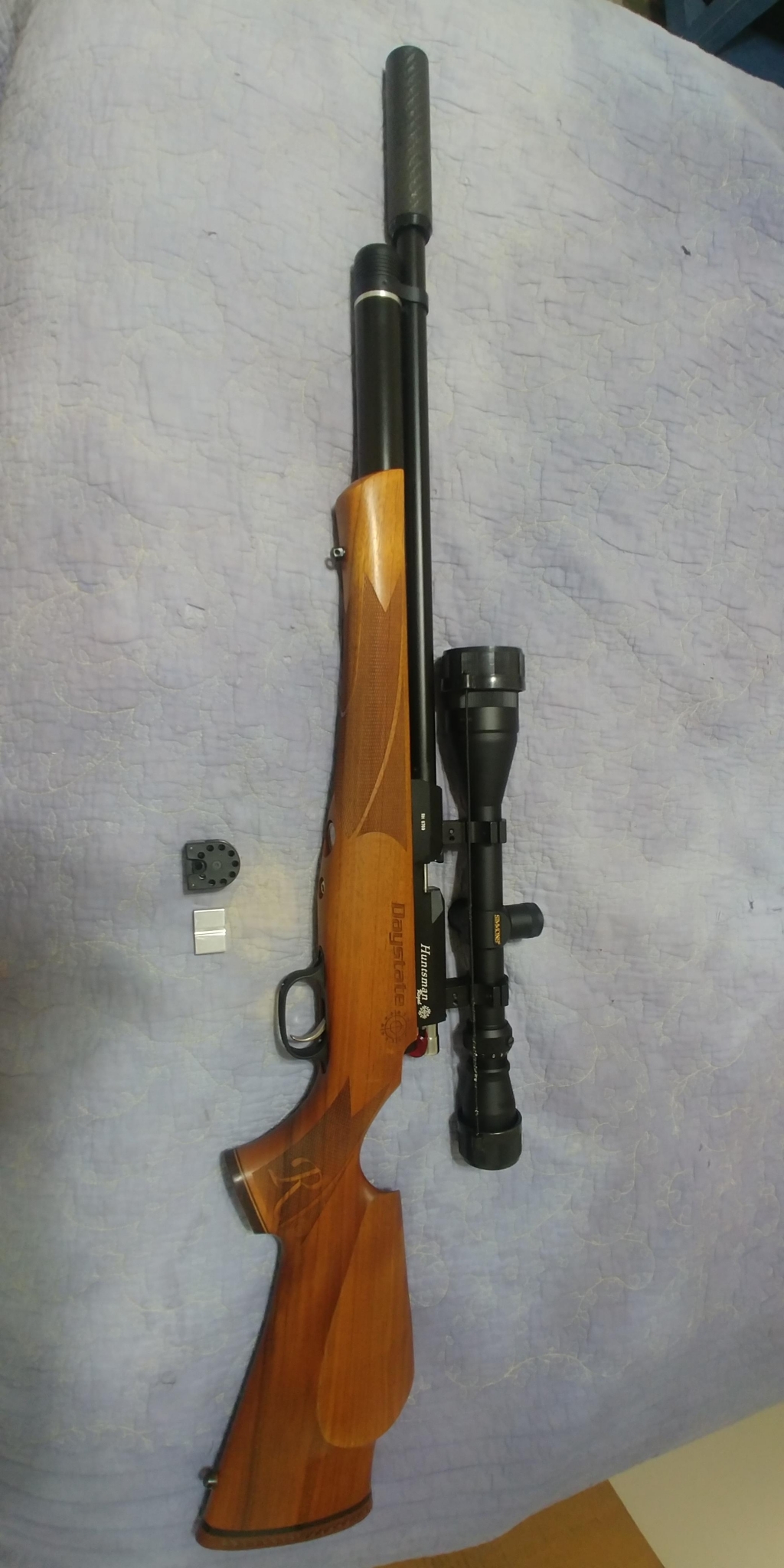

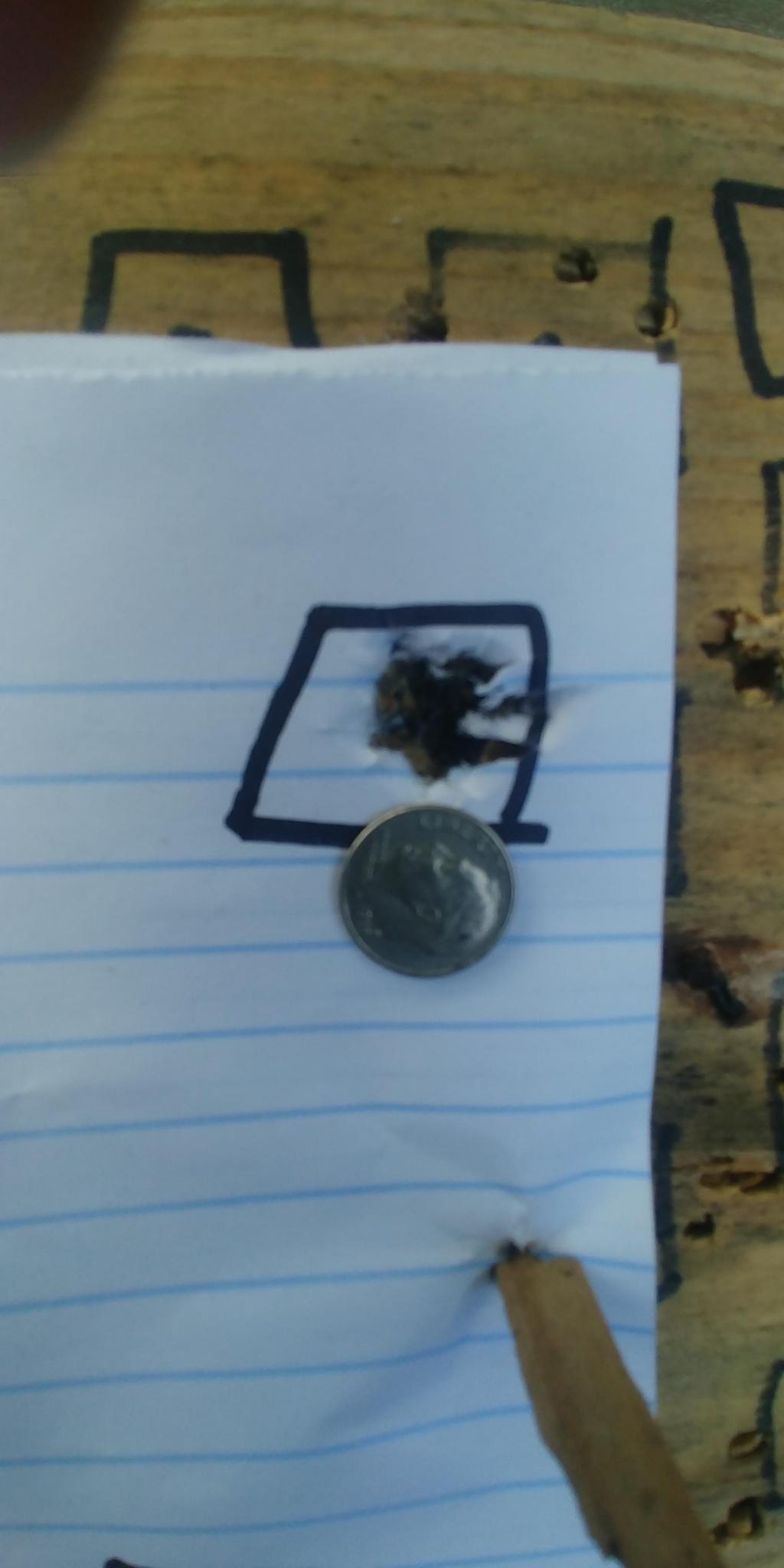

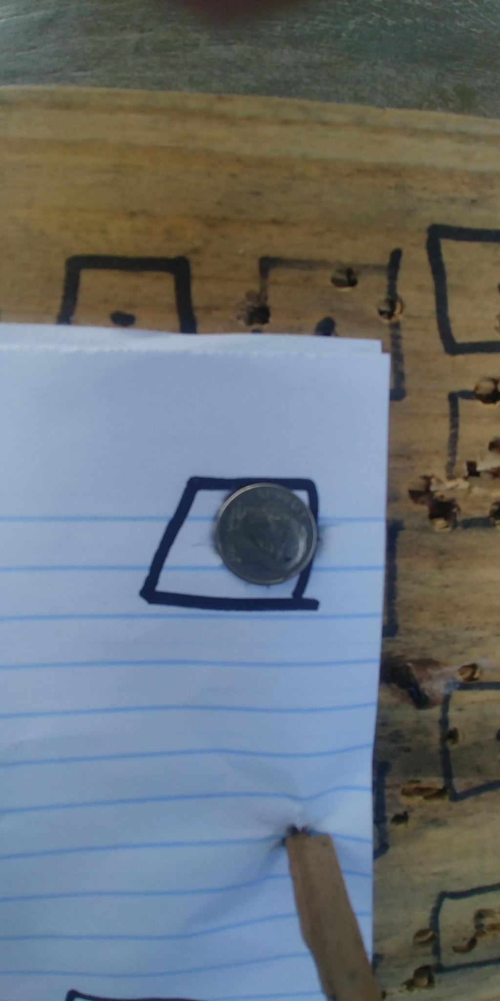

I got a Huntsman Regal .177 in a trade, since May 21st I'm well into my sixth tin of pellets through it, it's unregulated, and not pellet fussy, with H&N 10.65's I get 70 shots from 800fps to 840fps to800fps from just under 200b to just over 100b, can get a lot more but greater ES. I've been VERY impressed with this gun, I have a Streamline .22 (love it) I do like the barrel support on the Daystate and the Regals stock feels nicer to me, I heard several people comment about not caring for the bolt type cocking, doesn't bother me at all, in fact I've been impressed with how well your hand flows from trigger to bolt and back, it's well designed, mag works great, and it most certainly has a more solid feel than the Streamline. I don't do much bench shooting but had no trouble getting pea sized groups at 25y, attached pictures are 30shots, 3full mags from sitting position at 25y, for the same money I myself would get a
Streamline, I
prefer the Streamlines 3 power selections, but you won't go wrong with a Regal. Good luck with what ever you choose! BTW, Regal has a great trigger too!
