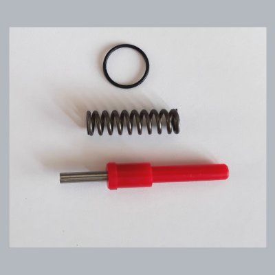

Found my issue, sort of. The plastic stem on the poppet valve broke inside the action. Any suggestions on where I can find one ??
How do I order TWO of these ? Thanks for getting back with me !!
