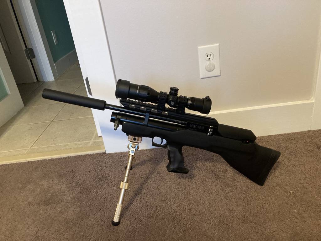

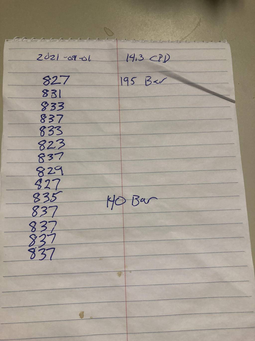

14.3 CPDs, it loves ‘em accuracy wise as well. Caldwell optical chrony and CPDs out of the tin as-is with no prep.

Thanks! I got the 9" version so I'm really impressed with the results. Between my Concept Lite and the HW100 BPC I just shoot CPDs. I've got about 22K pellets and I just use them for personal use. I'm not jacking the prices up to resell them or hoarding them it's just nice to have pellets on hand especially in the weird times we're in today with respect to supply availability. Most of them I grabbed back when AGD did a buy and get free program.
I like to keep it simple with just a single pellet type so that I know consistently where and how they shoot. I was really pleased with the ~937 over ~912 I read about in HardAir Mag.

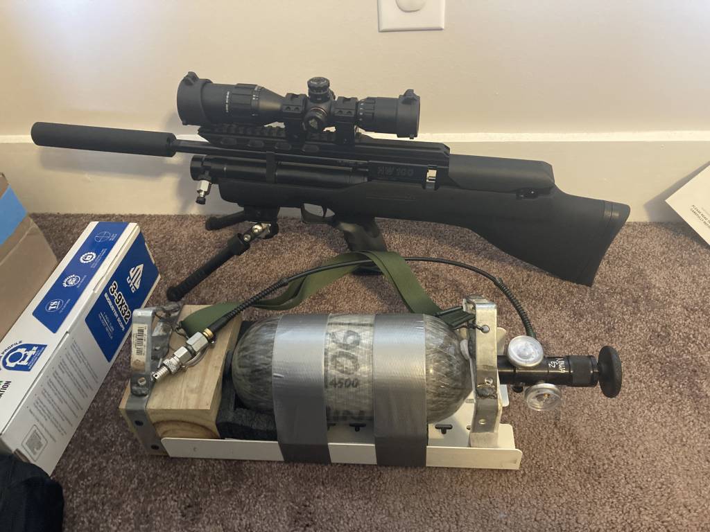

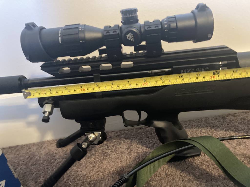

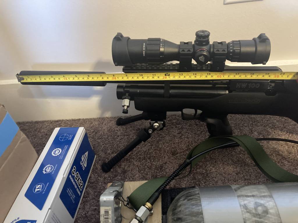

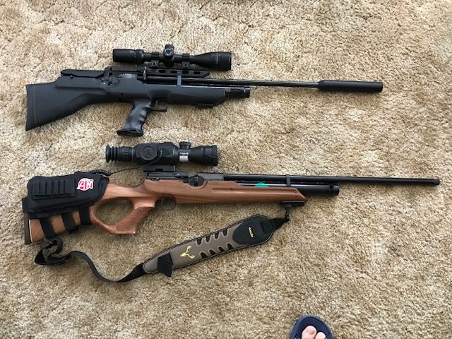

This thing is tiny the barrel with suppressor is shorter than the air tube on my Concept Lite. I would do a side by side but it is packed up for sale. I love this little bullpup. Concept Lite was great as well do not get me wrong but I am a one PCP kind of guy.
Flush fit fill probe is making it’s way from the UK. 30 shots at 200 bar at 837 vs 30 shots at 240 bar in the Concept Lite at 865 fps

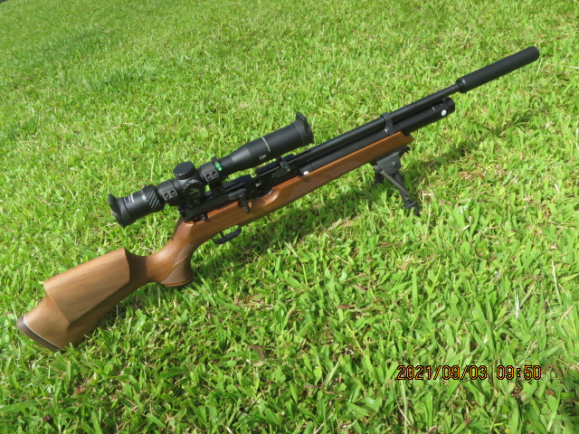

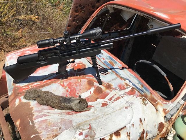

Here is mine. Not the carbine but 24.5 barrel in .177 cal

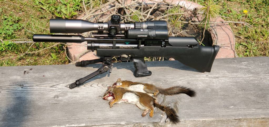

Super weapon. Like it so much I ordered one in .22 today.

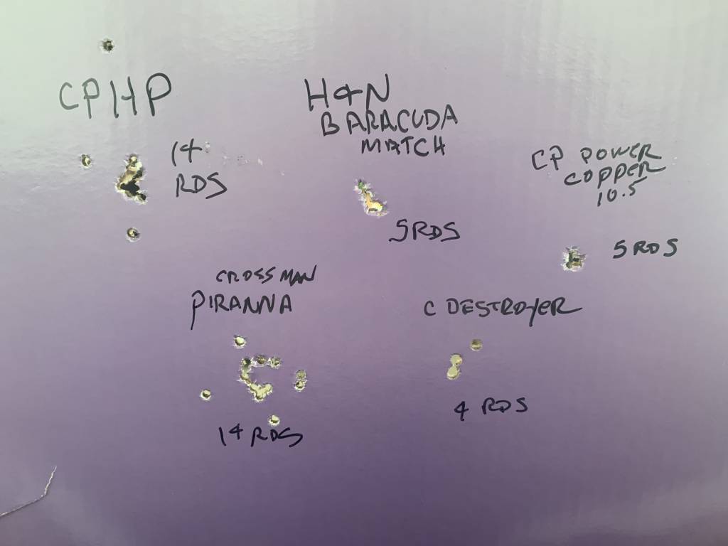

Loves CPRN COPPER AT 10.6 AND H&N BARACUDA MATCH 10.65
VELOCITY RESULTS VIA FX CHRONY
CPHP 7.9 GR. 1080 FPS
CROSMAN DSTRYR. 1086 FPS
H&N BARACUDA MATCH 10.65 961FPS
CROSMAN POWER COPPER 10.6 980 FPS
Target range 25 yds fired from bipod Ignore fliers on CPHP
they are from a previous shooting session
