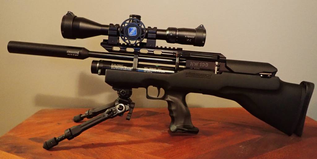

I have a .177 HW100BP-K, the carbine version. Polymag Shorts, JSB 8.44s and NSA 12.5g are the most accurate in that order. I get 3 - 14 round mags before a refill. It feels heavy when you first pick it up, but shouldered it balances well and feels good. I shoot off a bench 90% of the time with it and find it very comfortable. The first time I shot it with Polys at 20 yards I thought it was throwing them everywhere because they were landing in the same hole. I bought it because I wanted something short in a true left hand version. The trigger is superb, even better than my Daystate Regal XL's. No regrets.

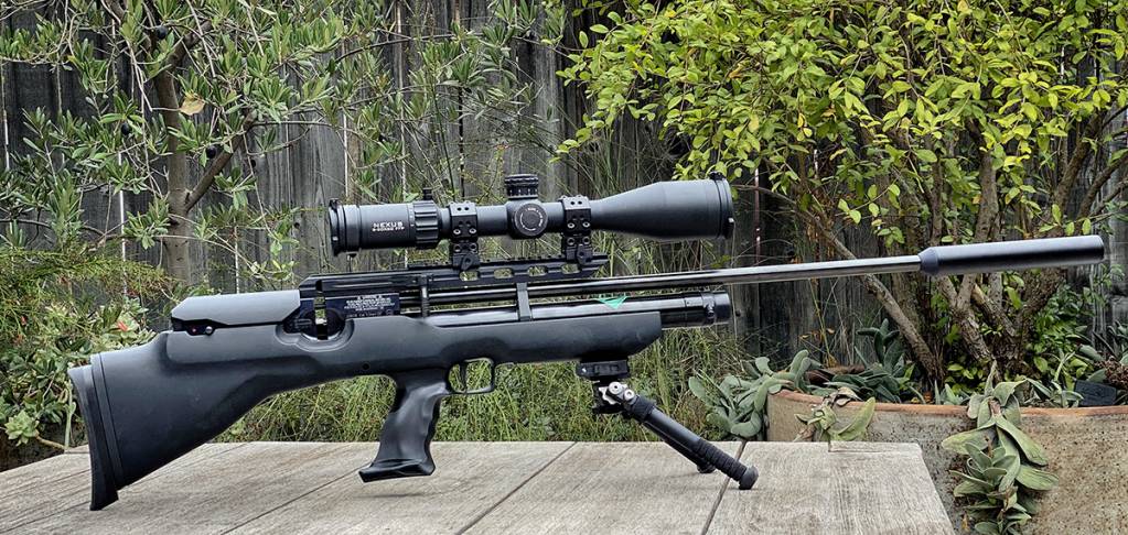

mine is no so little, shorter than the HW110 but the long barrel version is more rifle than BP, love the size
I was drooling over the long barrel configuration. I just don't think I need that much power, but it is the other end of the rifle I was trying to shorten in my mind, not the barrel end. Most people want a stock that fits them well. I just want everything I need to reach closer to the butt of the rifle.
The bipod pictures were really great because I was wondering what the clearance was on the pistol grip.
