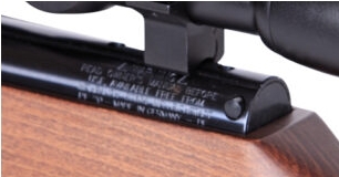

Not many good pictures to grab to show but like this new uk hw95 you may can read the receiver markings and the fpe stuff.. also like German power guns have the "f" stamp to designate them .
Its like squrllfugger saus the usa importer does that usa for his liability and. Like AoA even you changing the breach seal can void the warranty ( says right on the seals page ). Lol. Wow

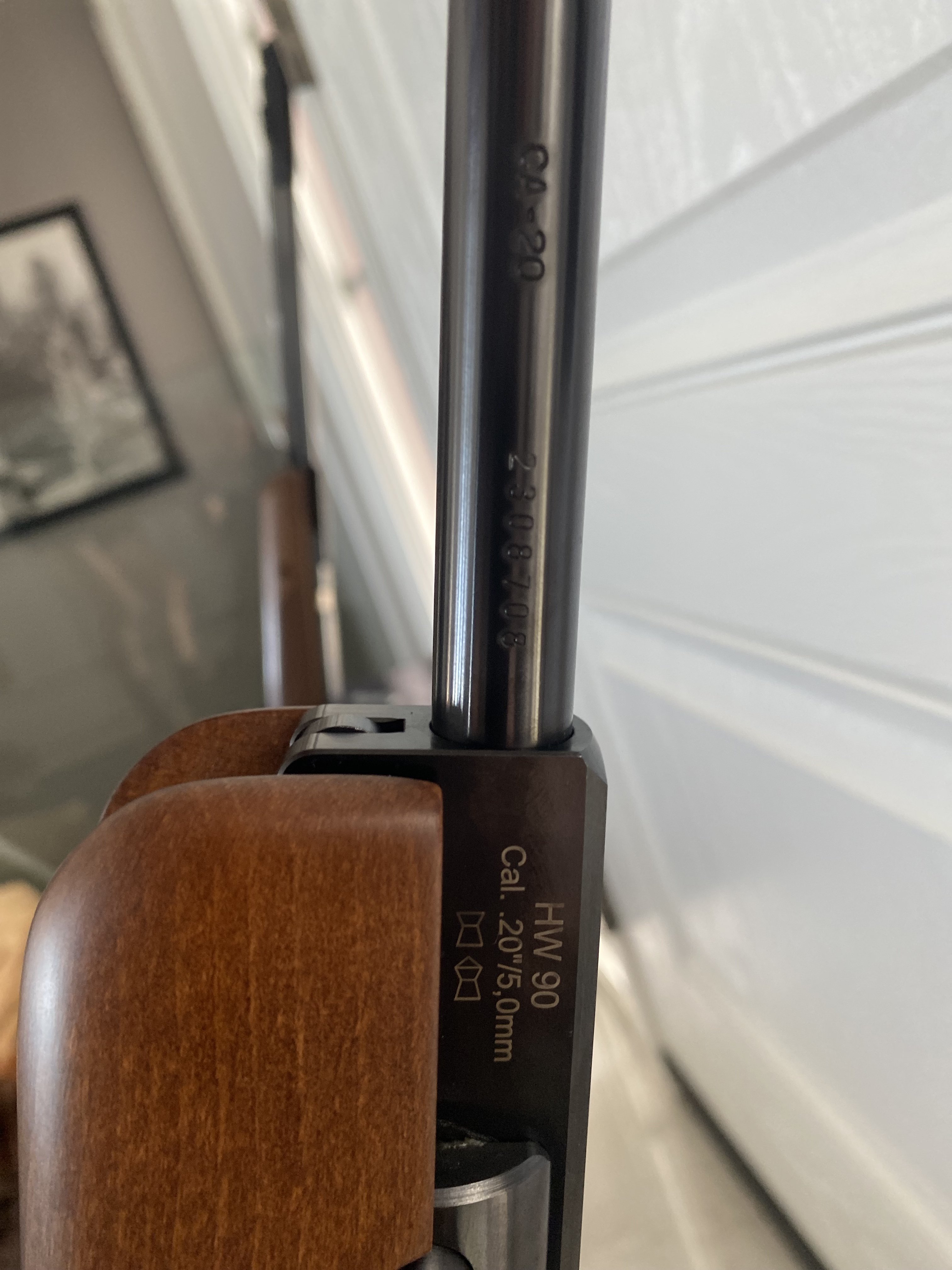

It may be for warranty issues. All my barrels are marked CA.

Look here under germany and see the Pentagon "F" mark..
https://en.m.wikipedia.org/wiki/Air_gun_laws
The receivers are stamped to distinguish quickly a legal no license or full power license gun. The receiver is the power plant and most times not so easy to covert to full power then if you do and the guns receiver says not and you dont have the license ... Well not going to be a good day for you if your called to a check by law enforcement. Lol .
