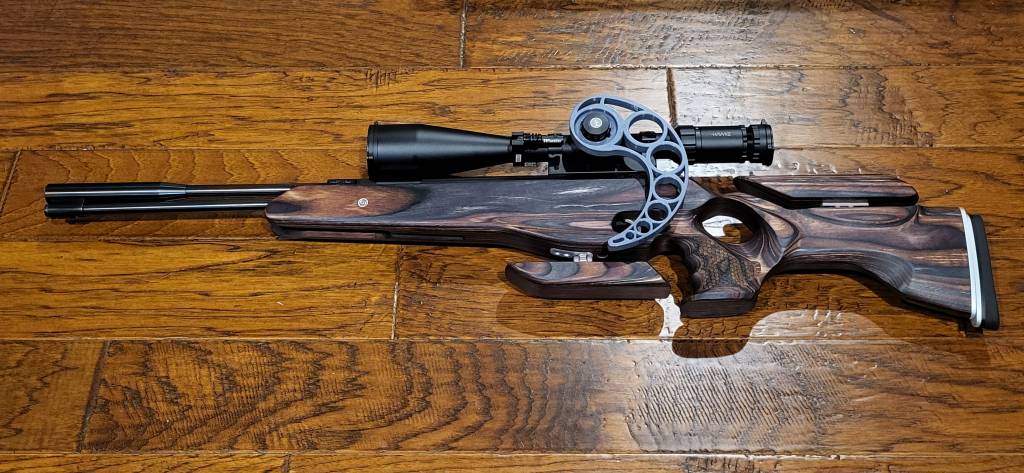

My 97 has the black thumbhole stock, feels good....In a more powerful springer, I will Always take the larger cal. I also have big fingers and the bigger pellets make it easier for me.
The K or the KT ...this springer is a keeper,you do not want to think later I should have got this model instead...my HW97black thumbhole feels good,a bit heavy..I know I wood rather have it in Wood though...
