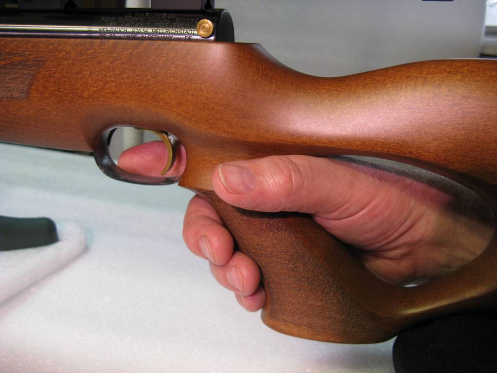

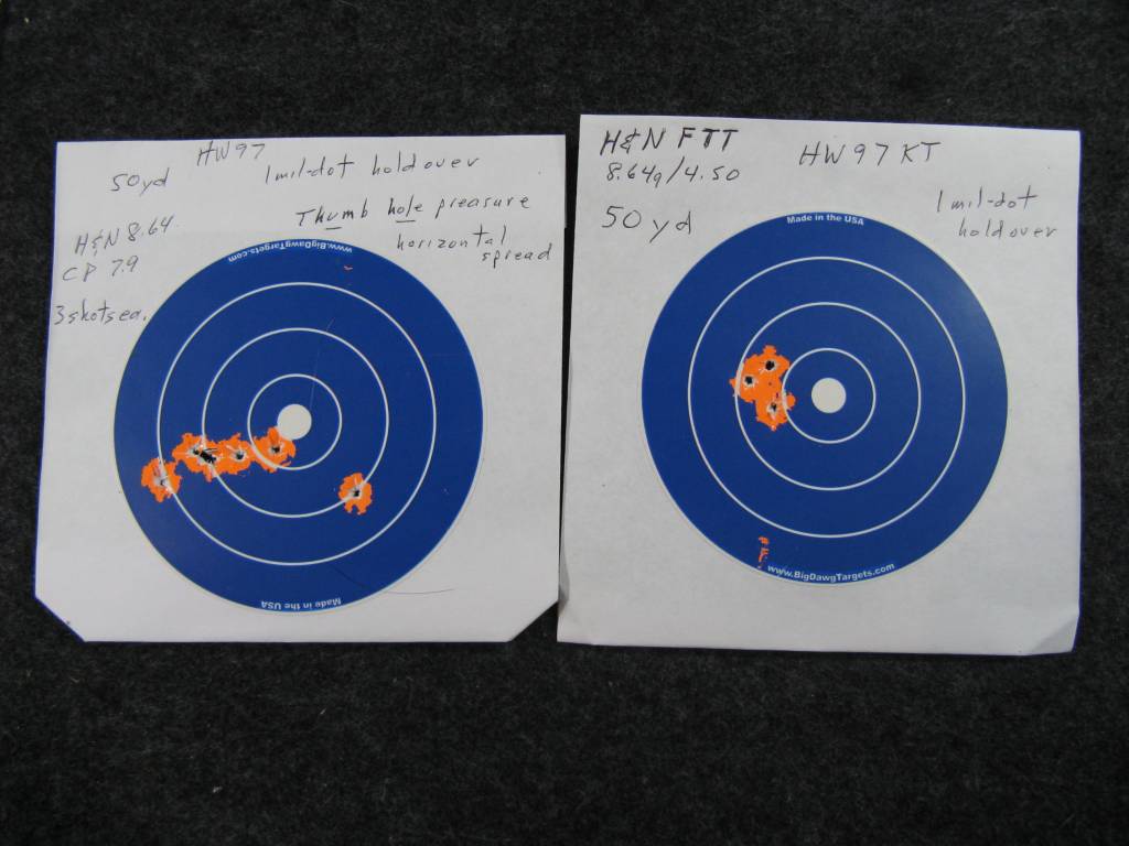

I had the same problem deciding but I got the KT. I was also trying to decide between the HW97 - HW98 & the TX200. I got the HW97 first but got a used 98 for $450 and the TX for $480. I wish I could have shot the 97KT before buying. It shoots good and now has a fac Vortek kit and Vac seal. I think making it an ambidextrous thumb hole stock was a mistake. It's not really a TH stock, there's no place for your thumb. I'm probably going to sand it down under my thumb so I can lay my thumb in as it should but I'm a little worried about matching the color but that's the only way I'm going to like it. Theses shots were at 50yds so I'm pretty happy with the gun but if you have small hands you really have to be aware of your thumb pressure. My index finger is 70mm and the Rowan Engineering set-back trigger helps. I have the straight set-back on my HW98. You don't have the long reach on the TX200 trigger and with the Tbt Maxi in my 98 and 200, both shooting about 12.4 ft lbs, I can do the pellet sitting on the scope thing and it doesn't move, very smooth. The 97 has been sitting since I got the last two and I'm rebuilding 2, FWB 124's right now but I'll finish that today and this has me thinking about working on that grip again.
Here's a photo of what I mean and how it affects my shooting.
Dave
