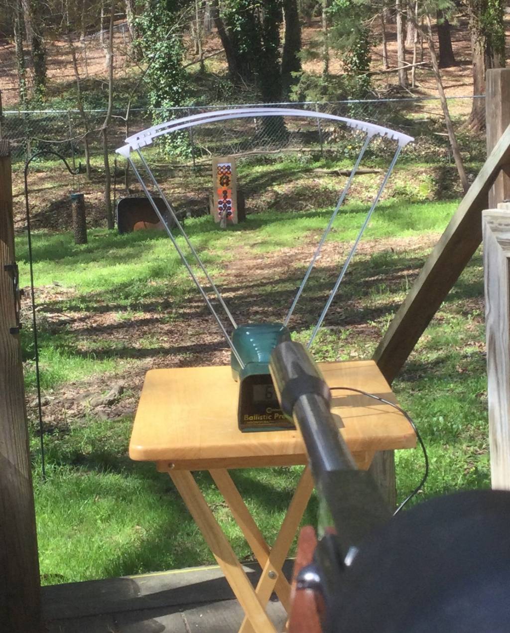

FWIW data for my 95: Note - 24 shots without any error from the Caldwell.
HW95L .22 (stock) FPS Pellet testing.
Caldwell Ballistic Precision Chronograph & iPad APP
Created: 03/21/21 11:08 AM
Description: 10 shot test for H&N FTT 14.66 gr Notes 1: 25 yard target
Notes 2: Distance to Chrono(FT): 5.00
