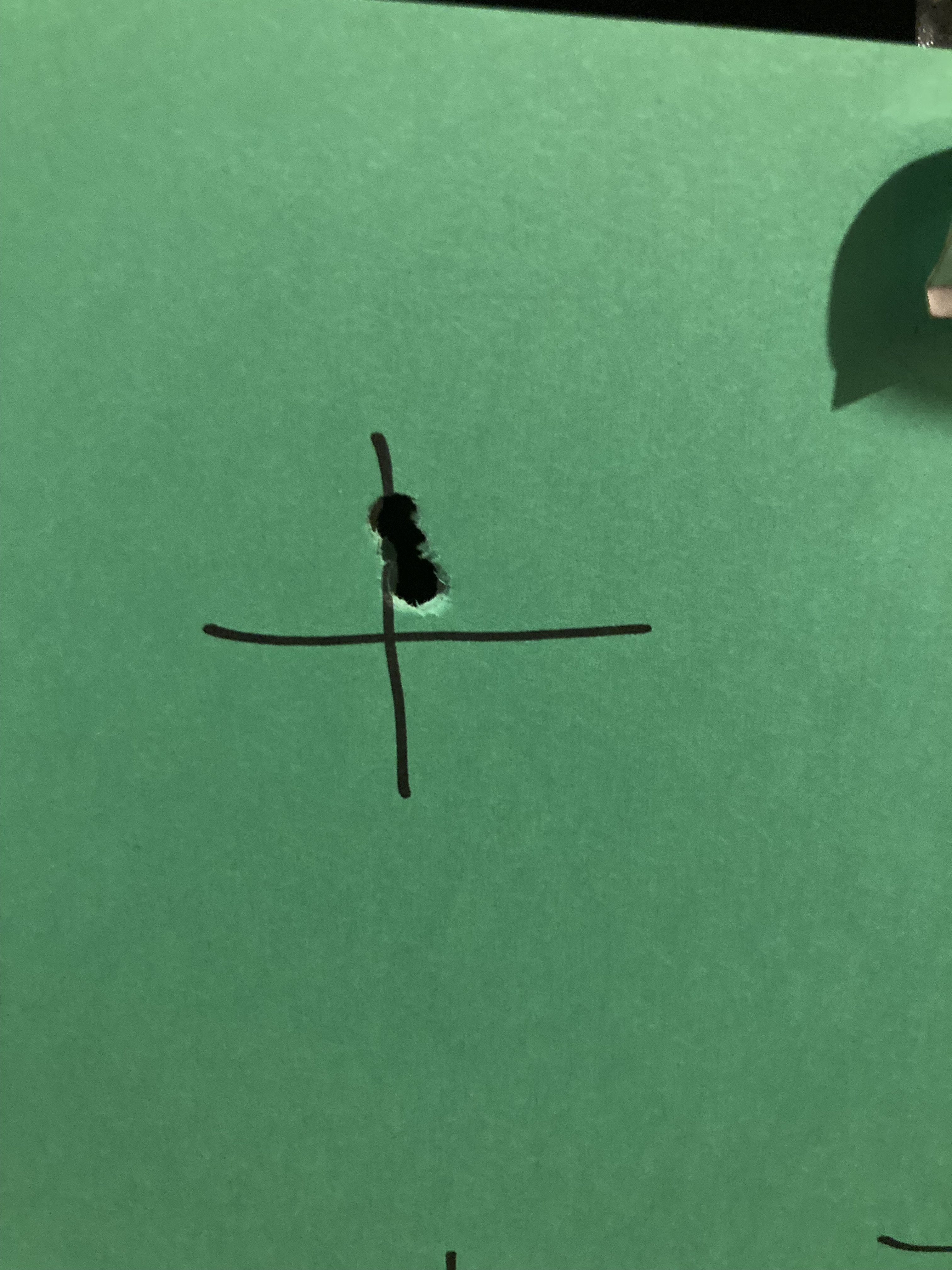

Here is my target at about 10 yards for 5 shots. Hw57 .22 Didn't even clean the barrel cause I dont know how to yet. I dont know if the newest production are better than in the past but this is shot standing from a bipod. If not for my moving, probably one round .22 hole.

Nice, there in lies another issue. I wonder if .22 handles the loading gate better and should be the preferred choice. My issues were with the .177
Maybe. I dont know all that much about what makes an hw57 or any other air rifle shoot well or not with all the components working together. I read a few of the online comments about accuracy issues with hw57 but I thought it was a really cool model. It’s like a 50s but underlever with the popup. Enough reviews and vids on YouTube that I decided to give it a try hoping for a diamond in the rough. I just cant believe that a model would be made that has a lot of lemons. Any lemons should be replaced by HW as having to machine or modify is ridiculous . So far so good. If it performs well with a maccari hornet kit and a hornet seal in it I may have a new fave
