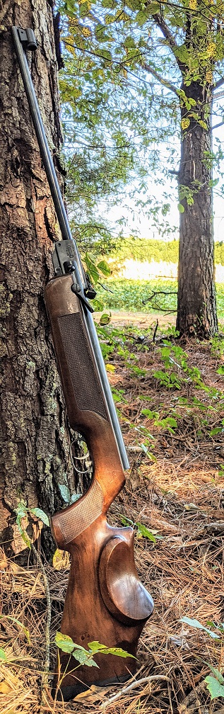

For what it's worth, the Tyro in my pics also bears Beeman markings, and also came with the 900-gram sleeve. You'd have to be more of a body-builder than me to shoot well with that monster though! The lighter 400g sleeve is more to my tastes, giving a very nice, muzzle-heavy "hang" proper for a target rifle.
I bought that gun many years ago, from a wealthy engineer (shipped from his apartment overlooking Central Park in NYC). He sold it to please his fiancée - and was plainly quite annoyed by that!

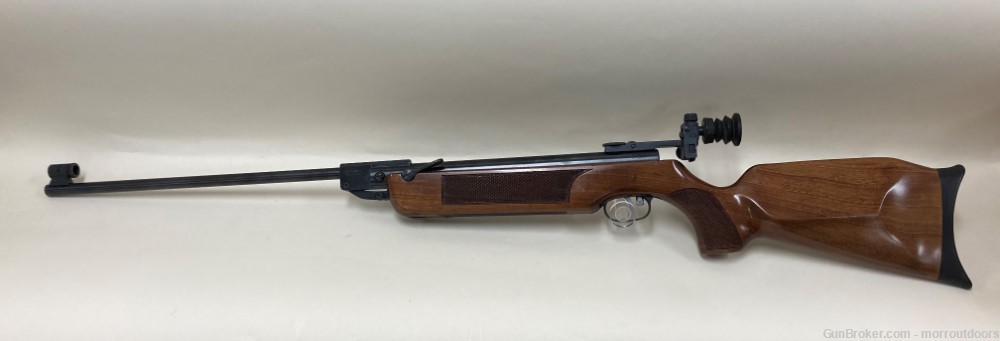

My 55T tyro is Beeman marked as well, does that make 3 of the 25? :) Or was that just the ones with barrel sleeves? Don't know if mine originally had a sleeve, but the front sight grooves are milled in and flush rather than crimped like other Weihrauchs. Don't know if all the old guns were that way, but it would certainly make it easier to slide a sleeve over the barrel.

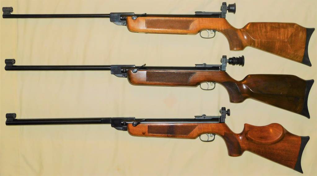

I actually have three T's that date from rather different eras. Here is a poor pic of each LOL...
This one is from 1956. Early examples of Rekord trigger and insert-type front sight, 400 gr barrel sleeve, and lovely slender diopter sight with solid steel base. Note also the rounded red rubber buttplate, and fore end finger grooves on the stock.
This one despatched in 1969. Beautiful full-coverage checkering and blonde European walnut of that era.
And finally a late example from 1991. Same one pictured in my initial post above, with Beeman markings and dark-stained walnut. Came with a 900 gr sleeve that I seldom use (!), 400 gr sleeve seen mounted here. Probably has an OEM plastic piston seal.

IIRC the reason I thought the stock was produced around the same time had to do with the small triangle shape checkering pattern in front of the trigger guard and the stippling behind the palm swell. The serial number being in the 350xxx range seems to be consistent with when that checkering in front of the trigger guard was introduced.
Any idea when or for how long the stippling behind palm swell was offered?
