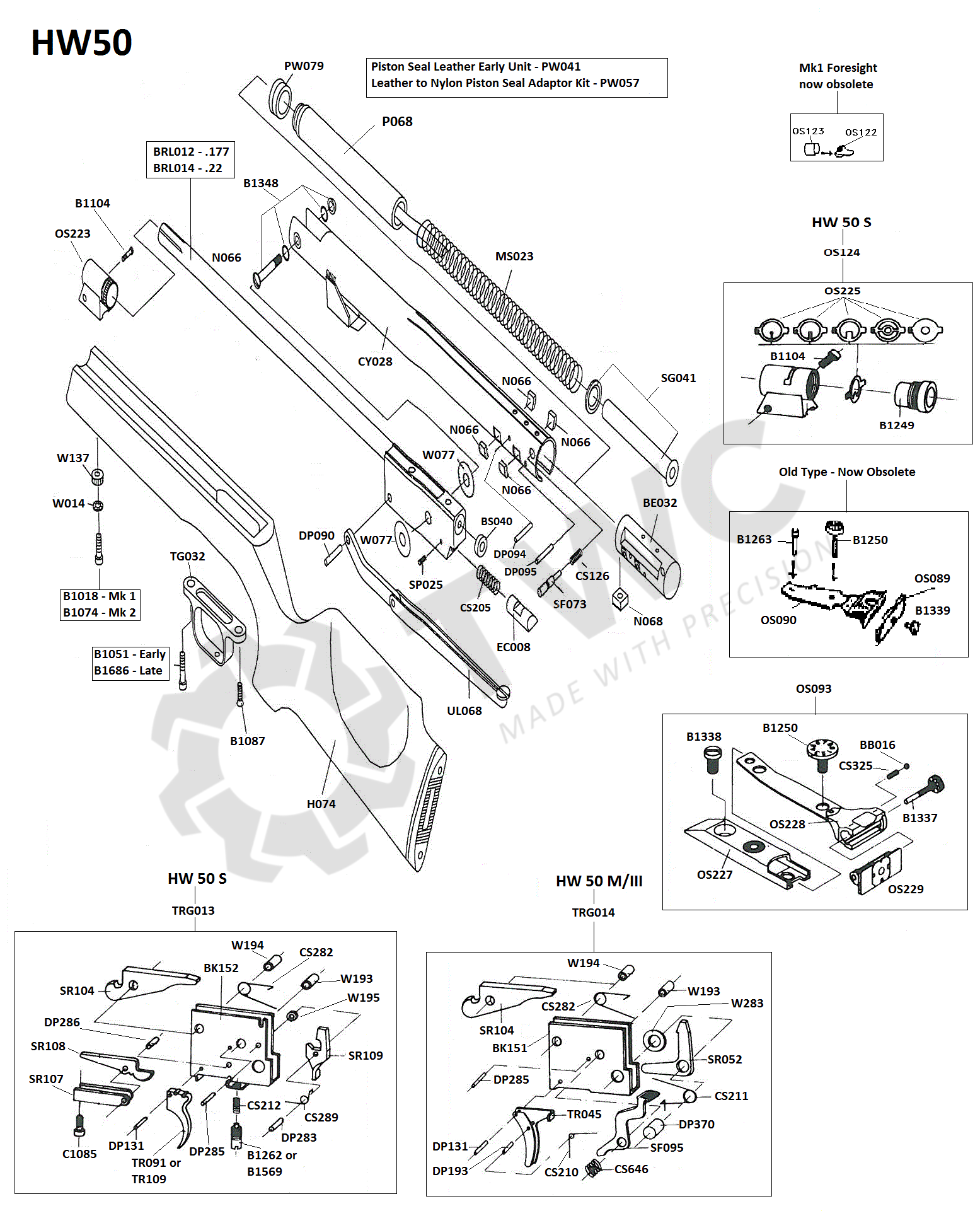

Thanks for the reply. I’ve also looked at the factory parts diagrams and dont see any difference other than the barrel; none of the diagrams show different part numbers for any of the other components.I only see the barrel being different between the two calibers,,, on the HW50s
